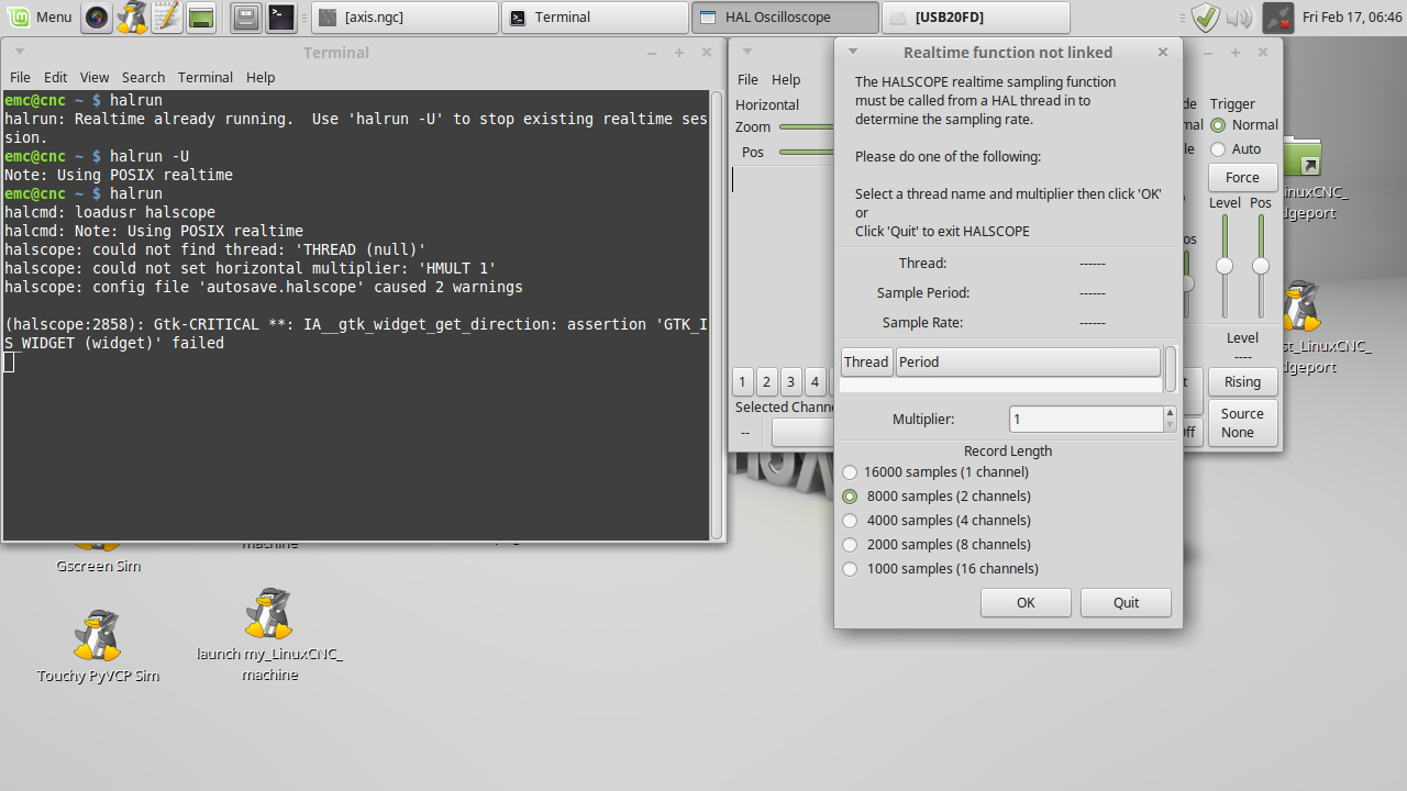

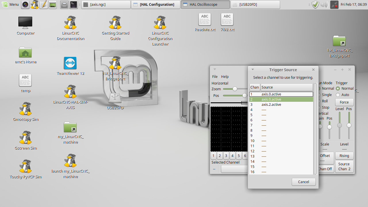

tommylight, you are 100% good with me, many thanks for ALL your help! I will follow your directions as well as with Dan. Just to show the current situation, I have 2 screen shots of the area that seems to have things I can't seem to edit, or just not completely shore how to edit. One of these screenshots is taken from "halrun" to access the screen in question. All the future edits are to be done in a "text editor" on .ini and .hal files after using wizard to get close as possible.
The Realtime function not linked screen needs the "Thread" "Period" (in the center of screen) needs to have some values in that area.
The other screenshot as the axis (2 axis are identical) I need editing (low to left of shot).
Many thanks for any help or suggestive reading to aid in my effort would be greatly appreciated!!

Halscope requires that a realtime thread is running, So to run it from halrun, there are a number of things that have to be set up first. The second screen shows that you don't really have anything running in hal to test. All that is taken care of if you start it from within a running Linuxcnc session.
