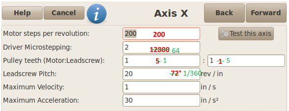

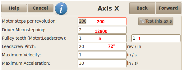

Hi
I work now since about two years with my cnc machine. The stepper configuration works just fine but all the numbers for Microstepping and so on I used are more or less set by trial and error method. Now I begann to engrave some huge parts and I saw that the engraved lines are not as the should be. They are a little angularly and not always straight as the should.
The problem should be on the rotational axis.
I use a nema32 Stepper motor from longs motors with 1,8° per stepp -> 200 steps per revolution
On the motor i have a belt gear with a ratio of 5:1
On my driver longs DM860A i have choosen 12800 Pulses/rev.
What type of setting should i use that the machine works just fine?
I have tried this one (red letters). But did not work as it should.
For some help I would be grateful.
Kind regards
Sergio

Driver Microstepping is not steps per revolution but Microsteps per full step
So if you have a 200 step per revolution motor and 12800 steps per revolution
this means your Drivers Microstep setting is 64

Ok thank you for this Information.
So I need to use:
200 Motor steps per rev.
64 Driver Micro Stepping
5:1 Pulley teeth (five turns of my stepper is one turn on my A Axis)
72° per rev (5:1 gear)
The problem is that this configuration did not work. There is something wrong with the scale.
