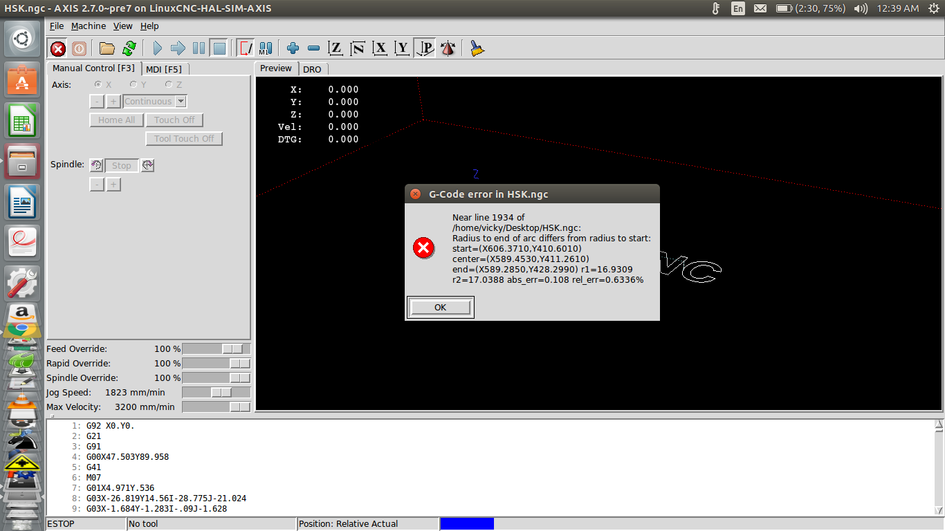

09 Mar 2018 19:31 - 09 Mar 2018 19:34 #107169
by kpj10
Replied by kpj10 on topic Arc Tolerance
For the image uploaded can setting arc tolerance_mm value will solve my problem, or is it a G-code error?
The possibility of the latter being true is limited as I have tested my G-code on the online g-code simulator, and I can see exactly what I have drawn.
I have tried in my 2.7.0~pre7 ini configuration file, to set the value TOLERANCE_MM = 0.2, and still, I'm getting the same error.
On my laptop, I'm using the linuxcnc-mirror-reverse branch.
The code on the line is G03X-17.086Y17.698I-16.918J.66.
The distance mode is G91. Thank You.
Kunal.
Kunal.

12 Mar 2018 13:37 #107243
Replied by andypugh on topic Arc Tolerance
Can you get your CAM software to output more places of decimals?
The following user(s) said Thank You: kpj10

24 Aug 2018 10:53 - 24 Aug 2018 10:54 #116522
I can understand your difficulty here.
The setting is not included in the INI config docs:
linuxcnc.org/docs/2.7/html/config/ini-co...ml#_rs274ngc_section
And the setting is not called TOLERANCE_INCH either. Looking at the actual code:
github.com/LinuxCNC/linuxcnc/blob/2.7/sr...rs274ngc_pre.cc#L986
The settings need to go in the [RS274NGC] section of the INI file corresponding to your machine config and are called:
CENTER_ARC_RADIUS_TOLERANCE_MM
and
CENTER_ARC_RADIUS_TOLERANCE_INCH
These settings probably ought to be mentioned in the docs...
and

24 Aug 2018 11:33 #116536
by BigJohnT
Replied by BigJohnT on topic Arc Tolerance
I looked in interp_internal.hh for the tolerance and found thisbut I don't know how to spell out in the docs the tolerance from those lines.
I did find the default values for arc tolerance
JT
#define CENTER_ARC_RADIUS_TOLERANCE_INCH (2 * 0.001 * M_SQRT2)
#define CENTER_ARC_RADIUS_TOLERANCE_MM (2 * 0.01 * M_SQRT2)
#define MIN_CENTER_ARC_RADIUS_TOLERANCE_INCH 0.00004
#define RADIUS_TOLERANCE_INCH 0.00005
#define MIN_CENTER_ARC_RADIUS_TOLERANCE_MM 0.001
#define RADIUS_TOLERANCE_MM (RADIUS_TOLERANCE_INCH * MM_PER_INCH)
JT
