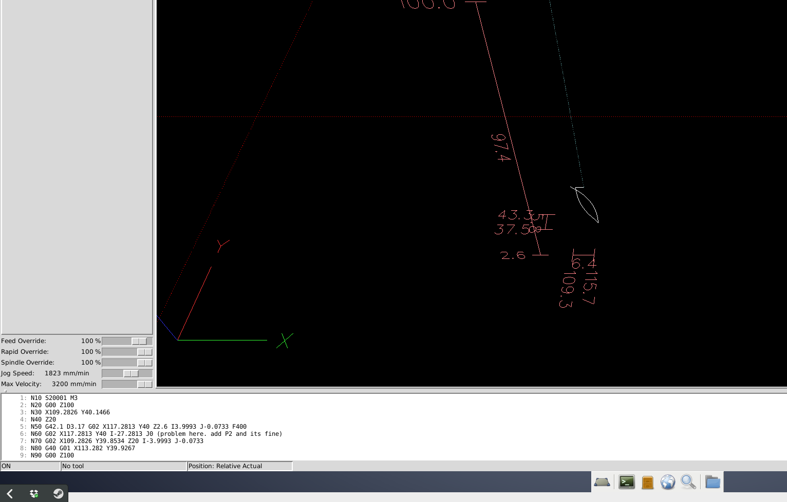

Hi
I'm currently developing my Qcad CAM config and have a problem with some but not all full circle arcs with offset.
When I remove the offset all is fine.
In the following line N60 is a no-show with no error?
In the following which is a cut from the outside appears OK.
Any thing I've missed ?
srl
N10 S20001 M3
N20 G00 Z100
N30 X109.2826 Y40.1466
N40 Z20
N50 G42.1 D3.17 G02 X117.2813 Y40 Z2.6 I3.9993 J-0.0733 F400
N60 G02 X117.2813 Y40 I-27.2813 J0 (problem here. add P2 and its fine)
N70 G02 X109.2826 Y39.8534 Z20 I-3.9993 J-0.0733
N80 G40 G01 X113.282 Y39.9267
N90 G00 Z100
N100 M30

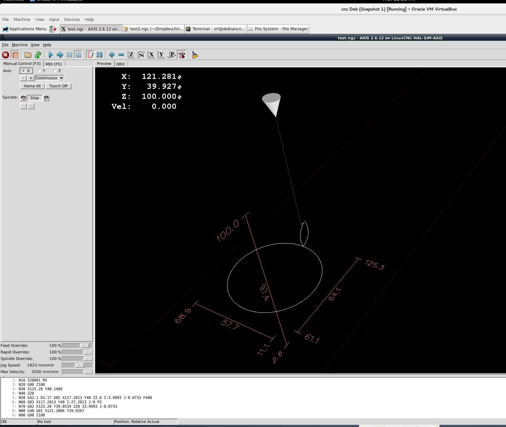

N10 S20001 M3
N20 G00 Z100
N30 X125.28 Y40.1466
N40 Z20
N50 G42.1 D3.17 G02 X117.2813 Y40 Z2.6 I-3.9993 J-0.0733 F400
N60 G03 X117.2813 Y40 I-27.2813 J-0
N70 G02 X125.28 Y39.8534 Z20 I3.9993 J-0.0733
N80 G40 G01 X121.2806 Y39.9267
N90 G00 Z100
N100 M30

Here is a YouTube showing the problem and the importance of arc in and arc out with offset cutting.
srl

26 May 2016 07:32 #75107
by SrLange61
Replied by SrLange61 on topic Full circle arc with offset problem?
Hi Rick
I'm running mm-sim and have no gouging errors as you can see above. arc in and out is the perfect solution for offset cutting. Its that nothing happens with line N60 then in the second file all is fine.
srl
srl
