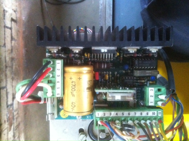

the servo drivers on this machine take a 10 volt enable signal as far as i can tell would this have to be a switched voltage going through the 7i37?
also is the an easy way to have the interface off the emc-plasma-thc sim window on to the 5i20 config thats made off the pncconf window?
and thanks for all the suggestions/help up too now

14 May 2012 14:28 #20082 by jd896
yeah sorry its the 7i37ta i have the servo signals on these drives are a max of 8 volt so its deff the enable signal did wonder if they would perhaps respond to a lower voltage enable but may just have to try it
also the server drive / capacitive height control is kind of frying my brain as to wiring i can get the two wires that can be switched with the 7i37ta to turn the height control on for the pierce height set and i have also found that the jog switch will respond to variable voltage also only its across three pins i.e. one common @ 15volt the, the up pin and down pin so no differential connection there also the sensor wiring that goes to the head has the wires to it a 15volt permanent two back i would assume that this would be the differential input but there's only about 3 volts for full down and nothing for full up, also the equilibrium point (no movement from servo) is adjusted with the potentiometer on the front panel so i dont think this is gonna work very well if at all ideas anybody?

The voltage varies dependant on how close an object is to the sensing ring on the torch Also I'd there any chance anybody would recognise these drives having a hard time finding the enable for them
15 May 2012 11:32 - 15 May 2012 11:35 #20095 by jd896
forgot the photo
