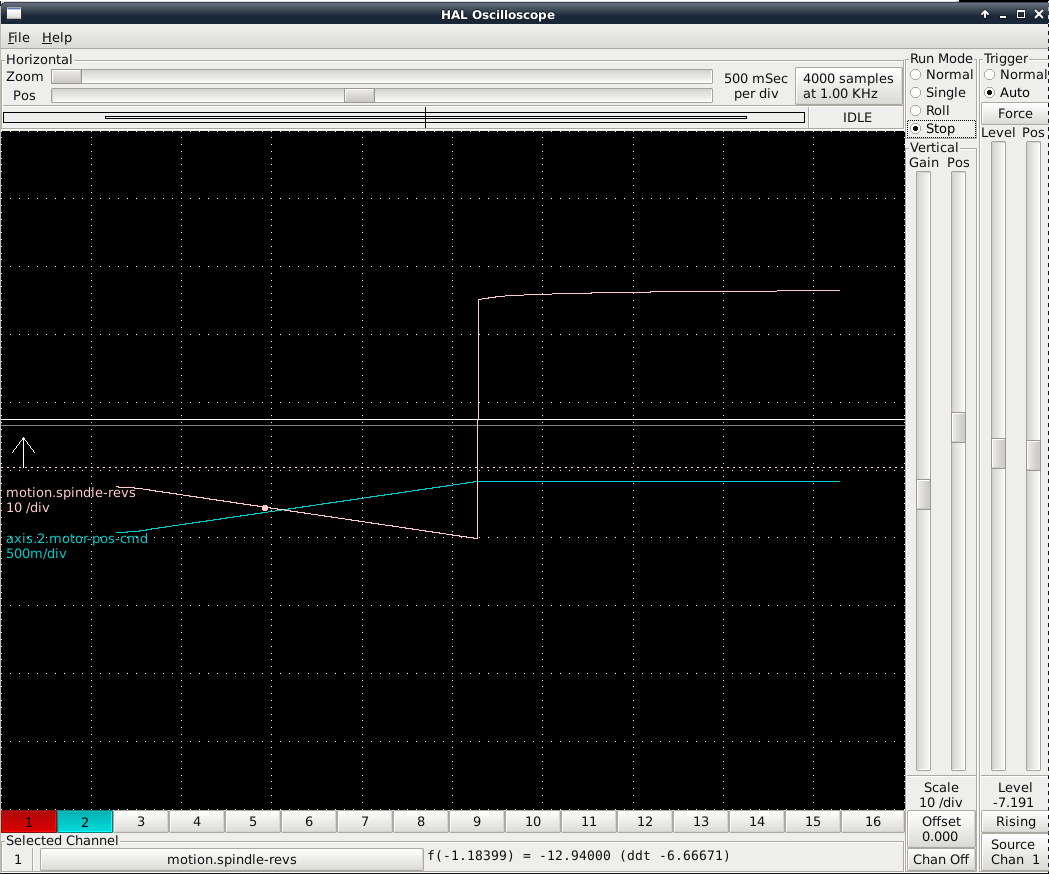

Could you also plot motion.spindle-revs vs z axis.2.motor-pos-cmd?

I assume you mean with halscope, motion.spindle.res on one channel and z axis.2.motor-pos-cmd on the other?

30 Jul 2015 00:17 #61020
by tome
Replied by tome on topic rigid tapping fail advice and "discriminant" err
Here is the plot...
