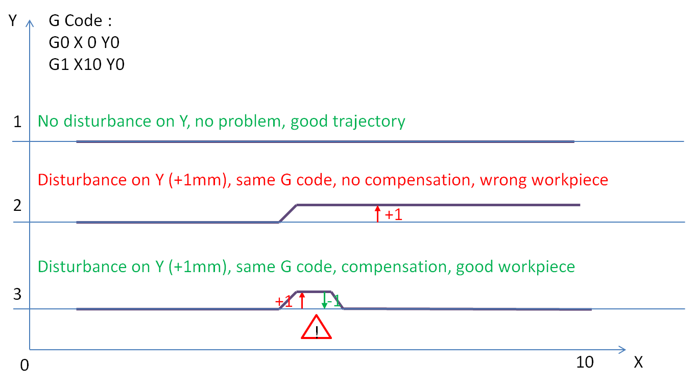

Yes. But the problem is that i need to test first on a simulated machine. Because my real machine is a industrial size one. So it's too dangerous and test directly on this one. It's for this taht i'm looking for a 3 axis sim config near of my machine to do the modification of hal.
And, in real test, i will not an motor, but only one encoder on a cross table (taht i can moove manually).
That is a further complication. It sounds like you have a number of different versions of LinuxCNC including some from the Joints_Axes branches which separate the concepts of joints (actuators) and Axes (XYZ directions)
I think you need to start at the beginning decide what you want to do, then do it.
Yes, in fact, there was a project before me. An engineer did a lot of work and developement on Linuxcnc. So I picked up his final virtuel box with these Linuxcnc version. It will be difficult to start from the beginning.
Si, if i understand, i have to try to simplify the servo_sim config ? (i want to test to add the offset component like you said). But maybe i will not see anything ? (I just want to disturb the feedback of position, and see if the machine go to the same goal. For exmple, if the machine have to stay on X0, if i had a distrubance with a suplemntary encoder on axis X (of 1 mm for example), i want taht the machine come back on 0. I hope that is possible on simulation. The "normal encoder" will be at 0 at the beginning, but will compensate with the orther encoder on the same axe, so activate the motor and do a displacement of 1 (and have a sum of 0, on feedback... )
07 Feb 2015 03:28 #55756 by andypugh
If that is what you want then you don't need the offset component.
All you need to do is to have two encoder counters, one as normal on the motor for axis control. The other goes on your hand-operated leadscrew and has the correct scale for the motion, but with a negative scale.
You then need to add the two encoder positions together before passing them to the PID.feedback pin _and_ the axis.0.motor-pos-fb pin.
It would be possible to set up a simulator to deomonstrate this, but the HAL that makes the simulation work would be at least as complicated as the machine-control HAL. Possibly more so as it is trying to simulate a machine.
Even if you did simulate it, all you would see in the simulation would be the pid output increasing then going to zero when you operate the second encoder.

I want to know if you think it's possible to see the case 3 on the pictures in attachment. (we can imagine the encoder counter, as normal on the motor, stay at 0, and a manual shift that i add to hal file (to simulate an other encounder) to simulate a +1 on X. I will see a light shift on screen (X go to one and come back to 0) ?
