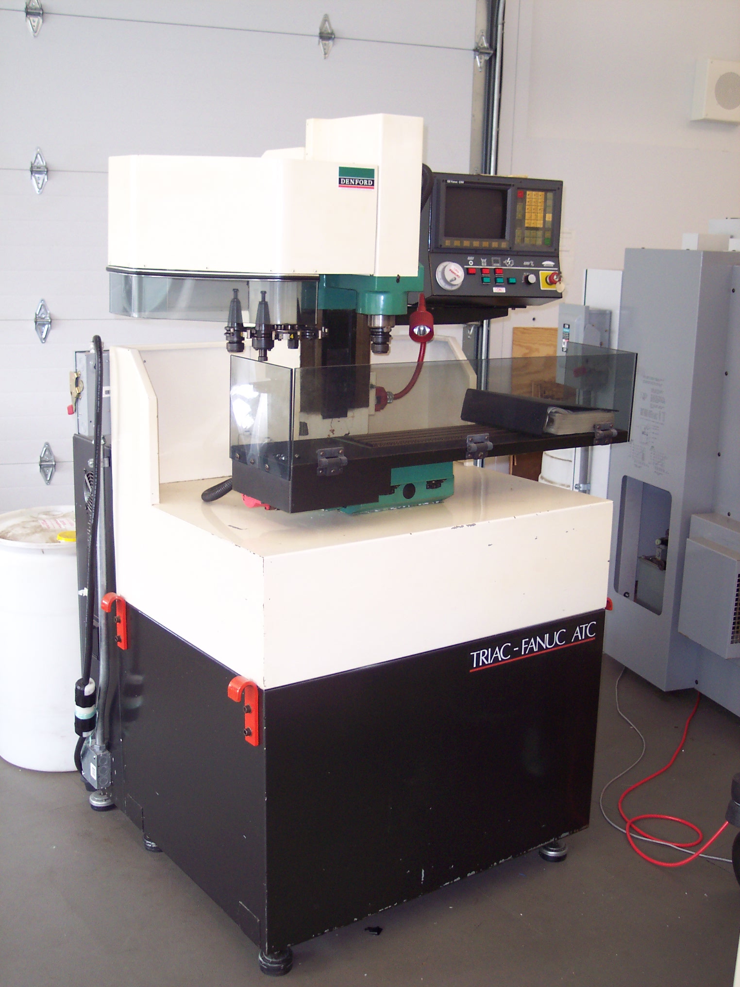

05 Jul 2013 23:46 #36345 by ArcEye
A picture is worth a thousand words- they say
This is what the machine looks like, albeit this is a sophisticated fanuc controlled version.
06 Jul 2013 05:38 #36348 by andypugh
Ooh! Nice!
You might be interested to know that my plan is to kill iocontrol.cc. Toolchange will be handled by a HAL component specific to the machine, that simply act on tool change request messages.
Initially (and briefly) probably Python/NML but NML is scheduled to be expunged too, replaced by something less horrible.
