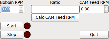

OK, so I'm not clear on the explanation of the issue - but regardless of that, let me try to explain what I'm trying to do. It would be very helpful to get your advice on the best way to go about doing what I'm ultimately trying to do.
I'm building a coil-winding machine. I need to control the speed and acceleration of two stepper motors. The motors would be running at fairly low RPM, but I need the ability to set the speeds of the motors independently and then once set, I need a way to start both motors at the same time with one button. The critical aspect of this application is the RATIO of speed between the two motors. So, my intention is to set the speed of motor 1 and have the app calculate the speed of motor 2 based upon a manually entered ratio.
It's clear from the documentation that this could be done with the Hal components (stepgen), but here's where I need your advice. Would it be better to build a panel that runs separate from Axis or are there some features in Axis that could be used to make development of the app easier or quicker?
I've attached a screen-shot of what the app might look like to make it more clear what I'm trying to do.
16 Aug 2012 16:29 - 16 Aug 2012 16:36 #23300 by BigJohnT
If your intention is to build a stand alone GUI you might want to take a gander at my Custom GUI Tutorial which is in it's infancy. It should contain enough material to get you going if you decide on that route I hope. In particular if you look at the Glade/Python tutorial 4 on my web site you can see how I do calculations like you want.
In the mean time if you attach your panel to Axis then you can use the postgui.hal file to connect up things.
Also, I would make the CAM RPM a label not a spin box.
IMHO, if that is all you want to do I would build a stand alone GUI using the Python Interface and Glade.
John

16 Aug 2012 18:37 #23310 by wd5jwy
Thanks John. Yes, I've looked through those tutorials some, but I see you have updated them as well. So, I need to go through them again. I'm pretty new to Linux so it's a whole new game for me. I'm used to developing in C, C++ and Assembler - this is a little different.....but a lot of fun. So, I have a bit of a learning curve.
Regarding the CAM RPM spinbox versus a Label. Yes, I thought of that, but there could be instances where I might want to enter a specific RPM for the CAM motor and then use a ratio to calculate the Bobbin RPM (sort of in reverse). So, I would need the ability to manually enter values for either one or the other depending on what I'm trying to do. So, in that case, a label wouldn't work.
I like the idea of using a stand-alone panel, but it doesn't really matter either way. I'm willing to do whatever is quicker and easier just to get the functionality I need. Right now, I just have a prototyping configuration with a set of motor drivers and two motors from Probotix. My first goal is to get the app built and the motors turning somewhere close to what I need.

16 Aug 2012 20:48 #23315 by BigJohnT
In the scenario you describe for the bobbin and cam rpm I would have two boxes one for input of the bobbin rpm and ratio and calculate the cam rpm and a second one to calculate in the reverse direction. This application seems like it should be simple as simple can be. You only need some HAL and a GUI... I think the answer is in GladeVCP but it escapes me now. An interesting challenge... yes I think this can be done with GladeVCP via the command line options. Look in section 4 of the GladeVCP manual. I'll try and cobble something up that just loads a couple of stepgens and a panel as an example.
Oh just don't forget your indents in Python and I think you'll be ok...
John
