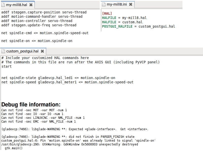

Hi all,
I tried to connect it according to the manual.
It could not be complete by my poor skill about linux though it could be shown into a tab.:unsure:
gnipsel.com/linuxcnc/gladevcp/gladevcp03.html
If I could do it, I would connect them to EMC action Run and action (all) home with new buttons like the way.
Please let me know that too.
Regard

04 Oct 2012 10:40 #24937 by BigJohnT
Replied by BigJohnT on topic Re:HAL Connections
You have motion.spindle-on in two places. The tutorial assumes you did not use motion.spindle-on yet.
Did you use the Stepconf Wizard to generate your configuration?
If so change
net spindle-state gladevcp.hal_led1 <= motion.spindle-on
to
net spindle-on gladevcp.hal_led1
John
04 Oct 2012 10:47 #24940 by andypugh
Replied by andypugh on topic Re:HAL Connections
I am not sure about the Glade problem, but the LinuxCNC not-starting problem is that your HAL files are trying to create two signals linked to motion.spindle-on (and there can be only one)
Your line
net spindle-state <= motion.spindle-on
is conflicting with another HAL command
net spindle-on <= motion.spindle-on.
The solution is to re-use the spindle-on signal, ie change your postgui file entry to
It will then crash at the next line, because I suspect that motion.spindle-speed-out is also already net-ed.
The next line in the postgui HAL needs to read (at a guess)
net spindle-speed gladevcp.hal_meter1
(though I am not entirely sure what signal name stepconf will have chosen for the spindle speed)

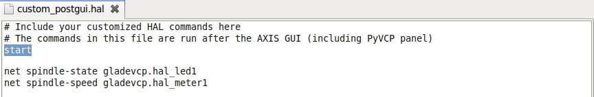

04 Oct 2012 10:52 #24941 by BigJohnT
shine wrote:
Hi all,
Regard
That is a tutorial and relies on you using the supplied configuration files from the tutorial.
John

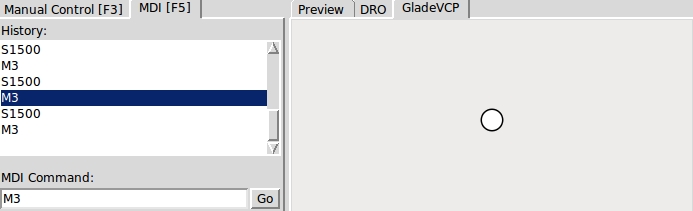

04 Oct 2012 11:54 - 04 Oct 2012 12:25 #24945 by shine
Replied by shine on topic Re:HAL Connections
John, Andy,
Thank you for helping me.
I could make a success in debug by that way.
It did not move unfortunately at all even if input a command on MDI like the tutorial though it usually was turning on in HAL configuration.
shine

04 Oct 2012 12:08 #24946 by BigJohnT
Did you follow the instructions in the tutorial to edit the postgui.hal file?
John
04 Oct 2012 12:34 - 04 Oct 2012 13:48 #24947 by shine
John,
I was going to do it.
I mean, done.
Now I found that I took a mistake about hal_led1.
It moved. Sorry so much.
"net spindle-on gladevcp.hal_led1"
but hal_meter1 was not moving.
I could also do it about hal_meter1.
It was correct below.
"net spindle-cmd gladevcp.hal_meter1"
I left a mistake for someone.
Thank you.
shine
