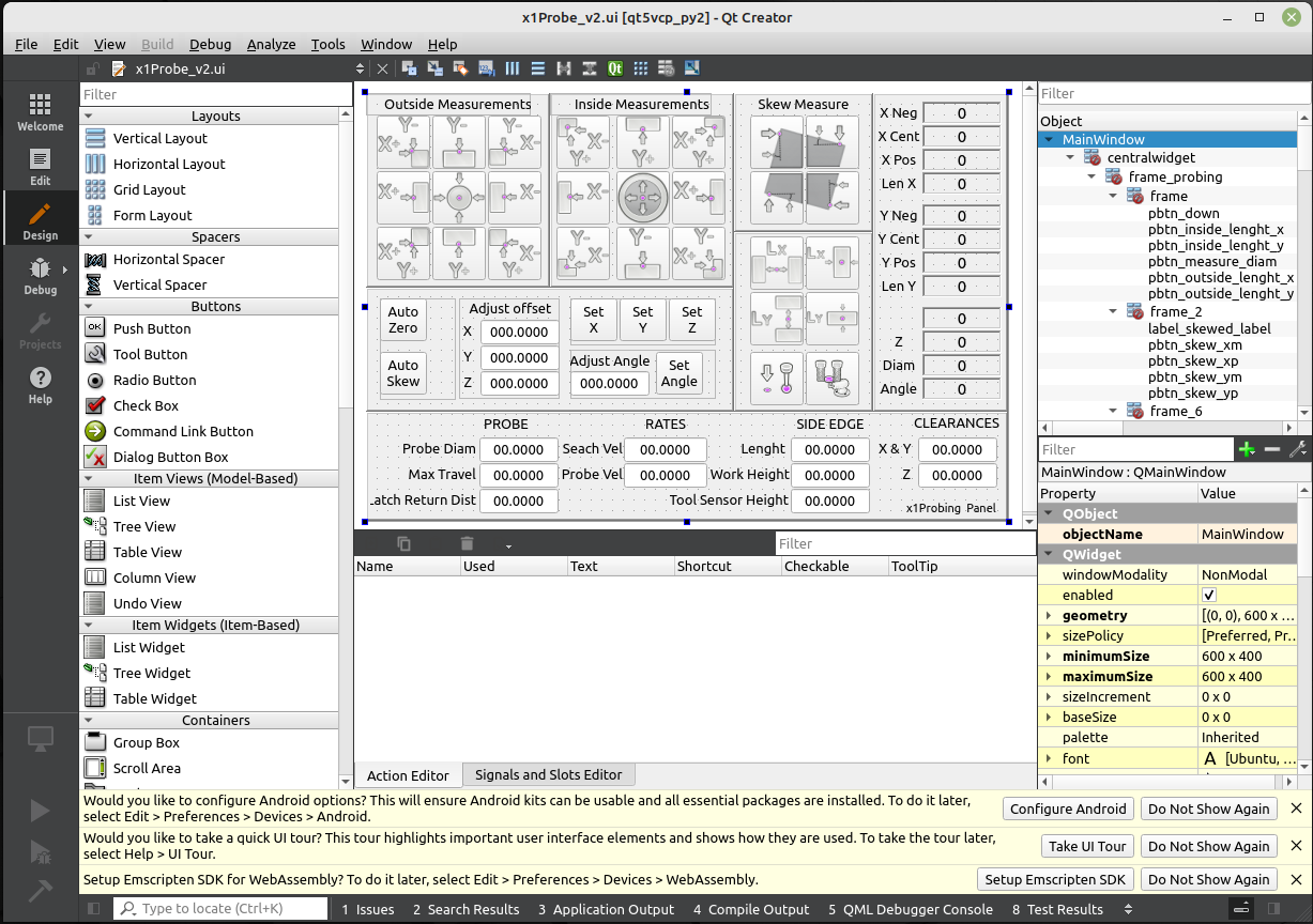

It been a good number of years since I configured a probing screen in Gmoccapy and wonder what is currently available to be installed with current Python version of LinuxCnc.

I have been working on getting to gmoccapy supplied verser_probe_screen.py working in my configuration but problems with import gtk.glade is a problem and appear not to be available anywhere.
module 'versa_probe_screen' skipped - import error: No module named 'gtk.glade'
File "/usr/lib/python3/dist-packages/gi/overrides/Gtk.py", line 85, in _builder_connect_callback
handler, args = _extract_handler_and_args(obj_or_map, handler_name)
File "/usr/lib/python3/dist-packages/gi/_gtktemplate.py", line 34, in _extract_handler_and_args
raise AttributeError('Handler %s not found' % handler_name)
AttributeError: Handler on_down_released not found
Changing the Gtk prefix gives the same result and there are many of these messages that relate to default settings not able to be handled. I have checked the internet and not found a solution and appears not to be uninstallable on mint 21 with some mention Introspection being required now.
If I comment the 'import gtk.glade' out and change 'import ConfigParser' to 'import os, configparser' and 'cp1 = ConfigParser.RawConfigParser' to 'cp1 = configparser.RawConfigParser' it will continue and seems normal but the result is that it shows the below and hangs there.
**** probe_screen GETINIINFO ****
Preference file path: cnc1_preferences
92274691
I don't know where the number is coming from.

Linux Mint 21 has some special requirements for working around old Python 2 code.
Yesterday I found the GObject project on the internet and installed it and its requirements and now the probe screen displays and executes.
Here are some examples;
Python 2.x bindings for GObject - transitional package
python3-gi 3.42.1
Python 3 bindings for gobject-introspection libraries
python3-gi-cairo 3.42.1
Python 3 Cairo bindings for the GObject library
python3-gi-dbg 3.42.1
Python 3 bindings for gobject-introspection libraries (debug extension)
My install was like this based no my notes.
sudo apt install python3-gi python3-gi-cairo gir1.2-gtk-3.0
sudo apt install libgirepository1.0-dev gcc libcairo2-dev pkg-config python3-dev gir1.2-gtk-3.0
pip3 install pycairo
pip3 install PyGObject
Ran this little test file after installation and named it hello..py as mentioned by install document.

A few minor changes in the versa_probe_screen.py file
import gi
gi.require_version('Gtk', '3.0')
from gi.repository import Gtk as gtk
from gi.repository import GObject
from gi.repository import Pango as pango
import hal # base hal class to react to hal signals
import os # needed to get the paths and directories
import hal_glib # needed to make our own hal pins
#import Gtk.glade

In relation to qtvcp's probe panel. I was looking through my old files and found my past work on this and think it would be possible to use it and perhaps modify it as required. This was the probe screen I was working on and has a date of 21 Nov 2018 so it may only need some button name changes.
The actual file is attached below.
I have the required icons and the Python probe handler I was using for this development work. As I recall your version of the handler does use some different methods but this may not affect the panel use. I do not have your latest handler version.

09 Sep 2022 04:45 #251532
Replied by cmorley on topic What are the current probing screen choices for Gmoccapy
I made a panel and did some tests on my machine, and while in principle it does work, there are usability problems with key forwarding and aborting that I am not prepared to try and work through.
I am curious if the original versa probe aborted properly - it would seem a miracle if it did.
Sorry, I think I steered you to a dead end.
Chris
Chris
09 Sep 2022 04:52 #251533
Well I tried again after deleting all other gladevcp panels (There were 3) and the entry problem seemed to go away.
If you wish to experiment, I can push the panel to master.
Chris
Chris

12 Sep 2022 04:57 #251722
If you are compiling linuxcnc, this goes in share/qtvcp/panels/
load in gmoccapy with:
EMBED_TAB_NAME = Probe
EMBED_TAB_COMMAND = halcmd loadusr -Wn qtvcp_embed qtvcp -d -c qtvcp_embed -x {XID} versaprobe
