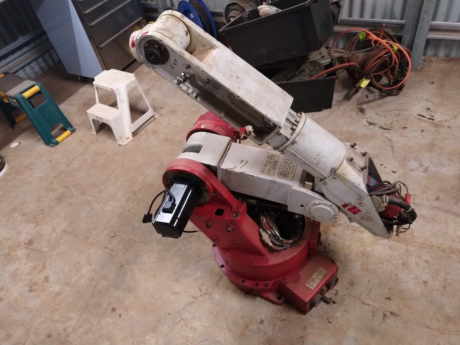

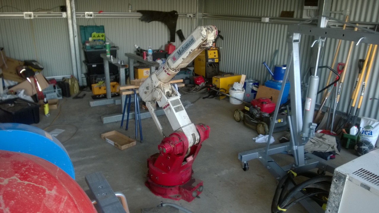

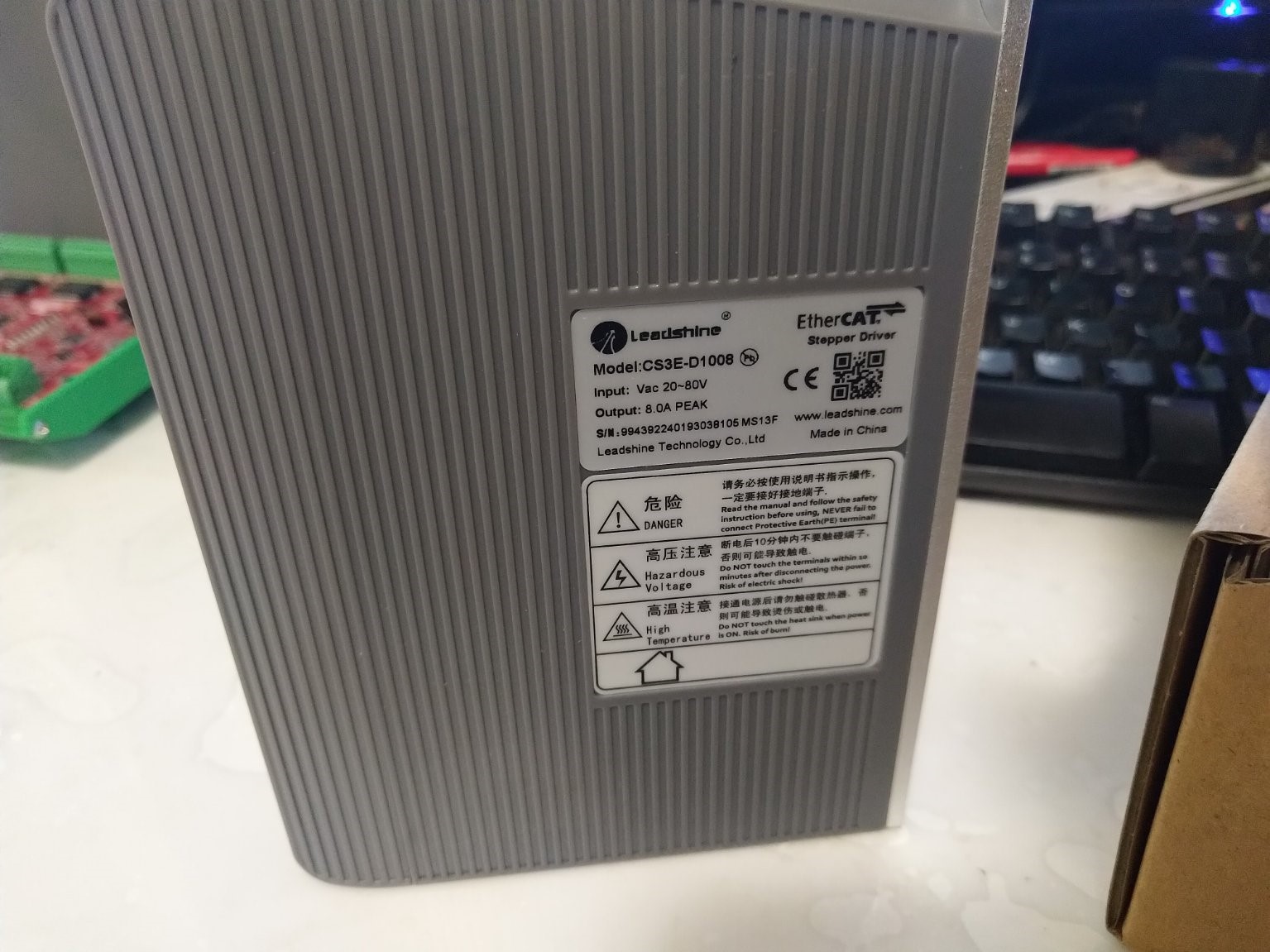

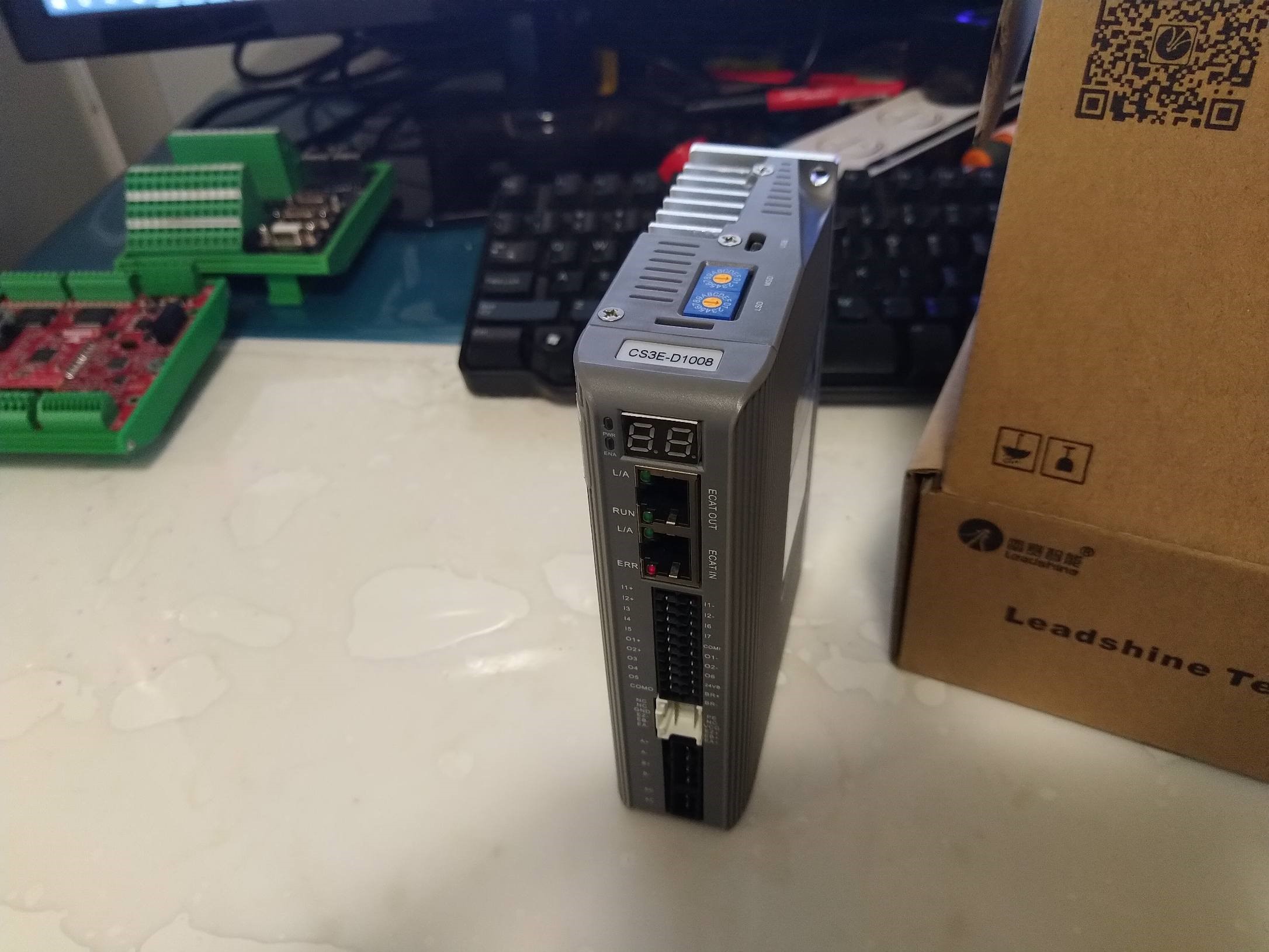

What is life without multiple unfinished projects and here is another one, retrofitting my 1991 Yaskawa Motoman K6SB.
This robot was used on the Holden (GM) production line in the Elizabeth South Australia plant welding Commodore exhaust systems according to the guy I brought it off who stripped it out of the plant when it closed.
This will be a slow build as I have big plans for the old girl!

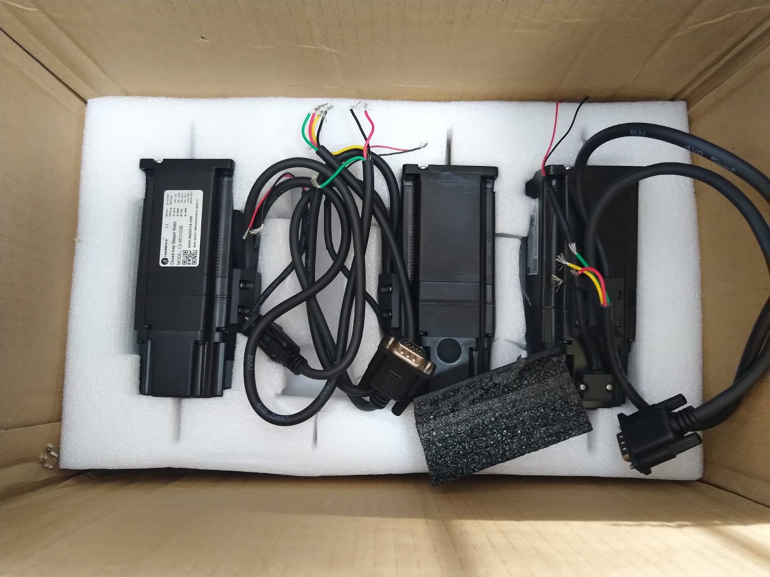

First I will replace all the old propietary AC servo motors with Leadshine closed loop stepper motors.
I have brought six Leadshine EtherCAT closed loop stepper drives to power the motors,

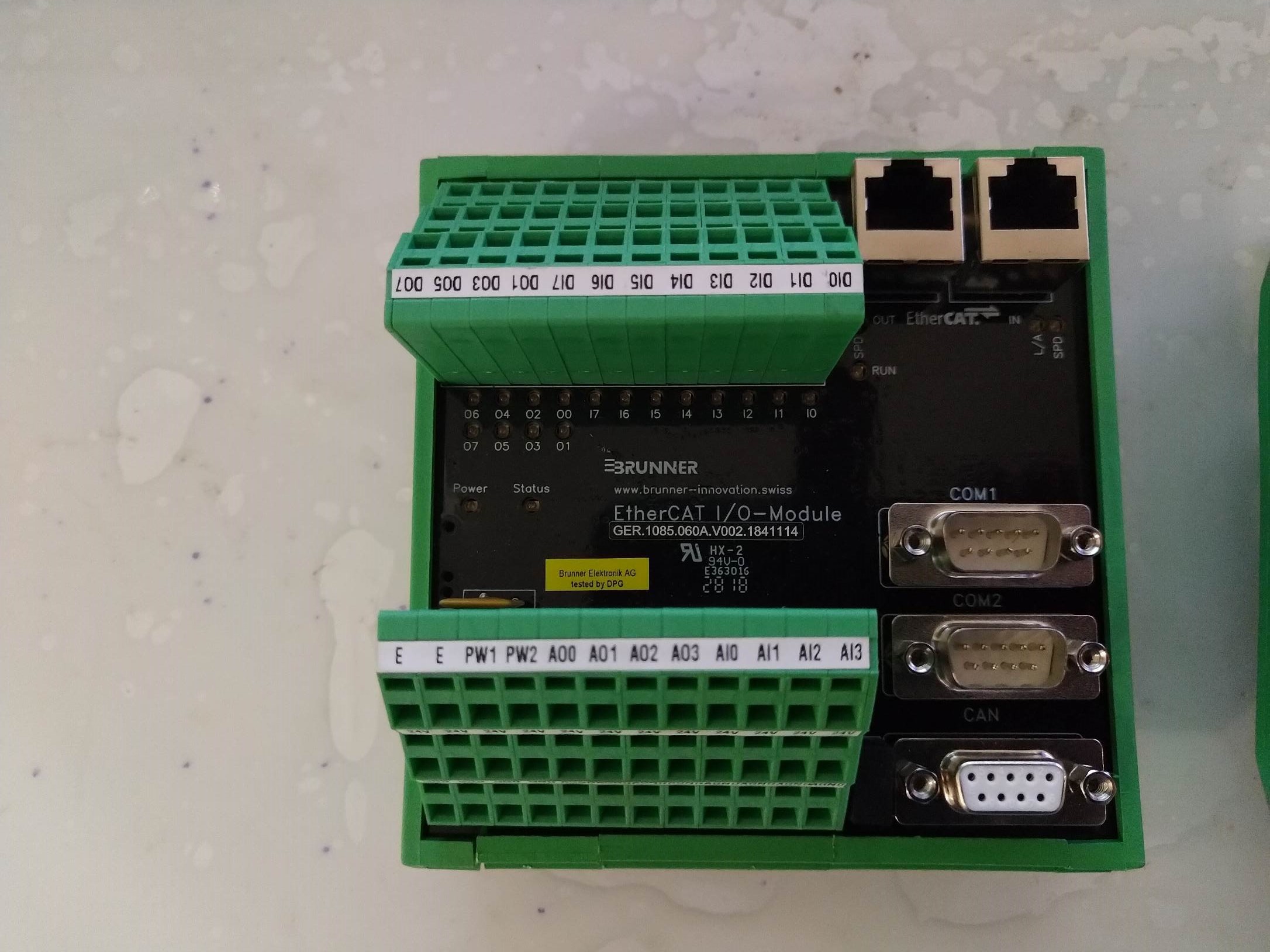

I will build a new control box to house the drives and I will need to buy a power supply that can power them all. I will also use this Brunner EtherCAT I/O module that has two encoder inputs that I hope to connect to two THCAD's. One will used as a welding seam sensor and the other a touch sensor.

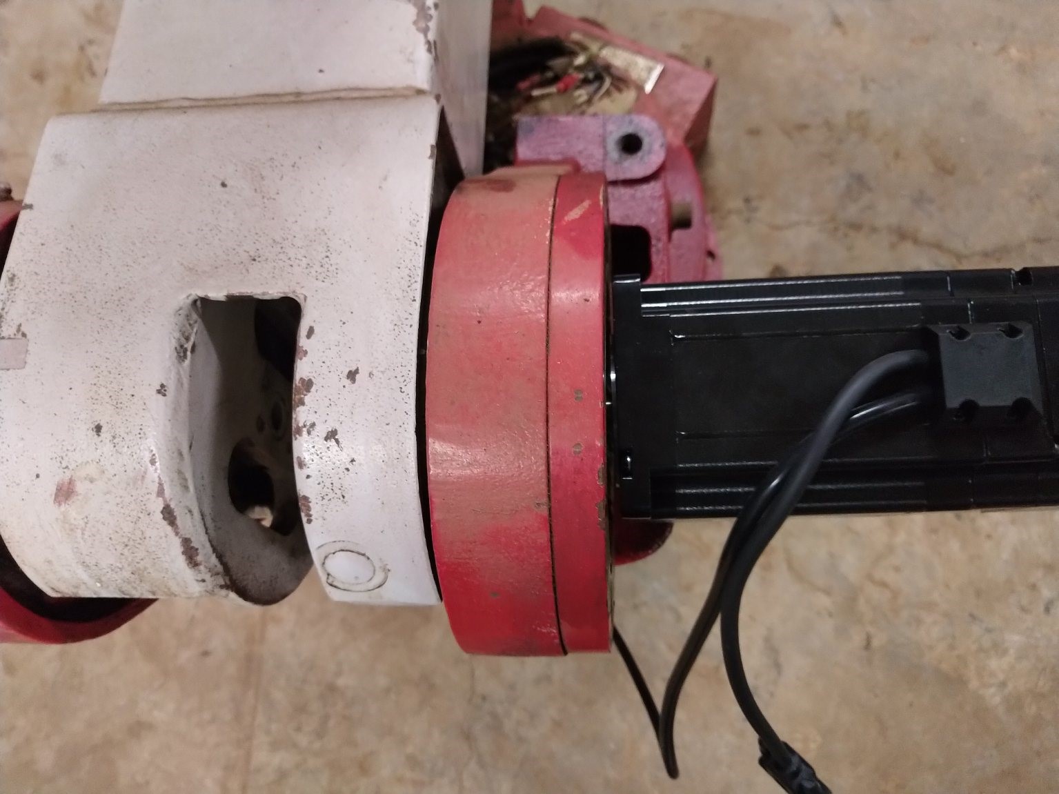

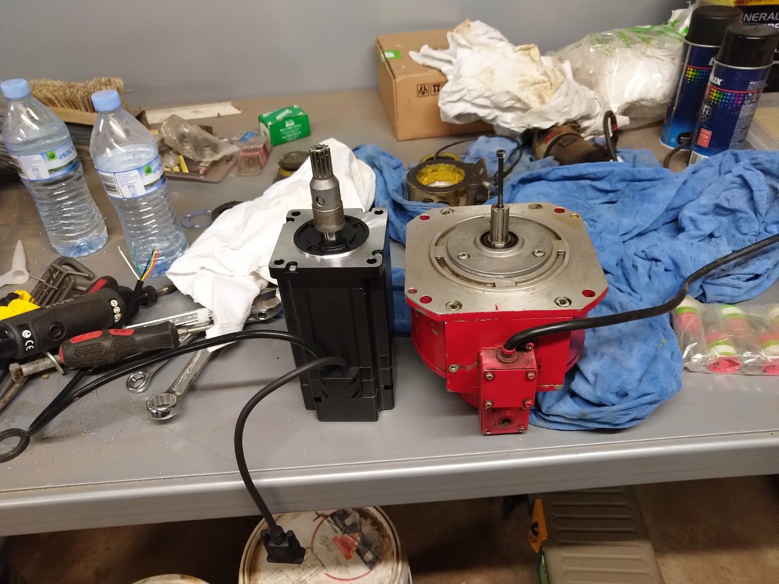

I brought these motors because the input drive for the harmonic drives fits these on these motor shafts. I will need to make a new motor mounting plate to mount the motors to the frame.

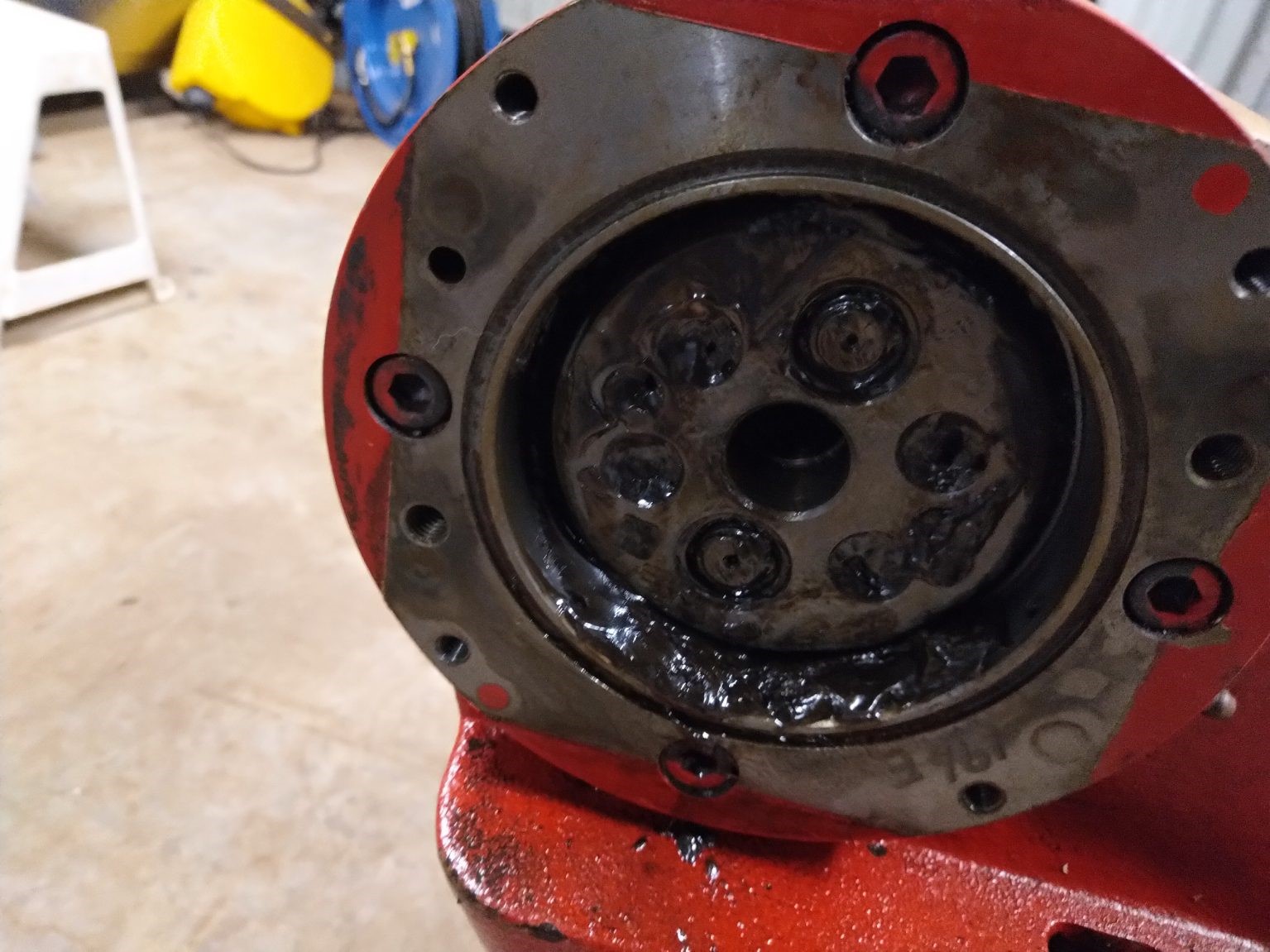

Does anyone have any advice on what I should do with the old grease in the harmonic drives? I am thinking I tear the frame down and strip all of the old grease away on all the joints and install new grease,

That, do that !Does anyone have any advice on what I should do with the old grease in the harmonic drives? I am thinking I tear the frame down and strip all of the old grease away on all the joints and install new grease,

Where did you get that Brunner EtherCAT I/O?

I brought the I/O unit from Brunner, www.brunner-innovation.swiss/product/ethercat-io/
I had to contact them and they gave me pricing, I think I paid $440 Euro with shipping from Switzerland to Australia.
Robots are funny. Everything each manufacture does is HIGHLY proprietary. I have a few newer units and if they brake down I cannot get new parts and second hand parts are very pricey.
