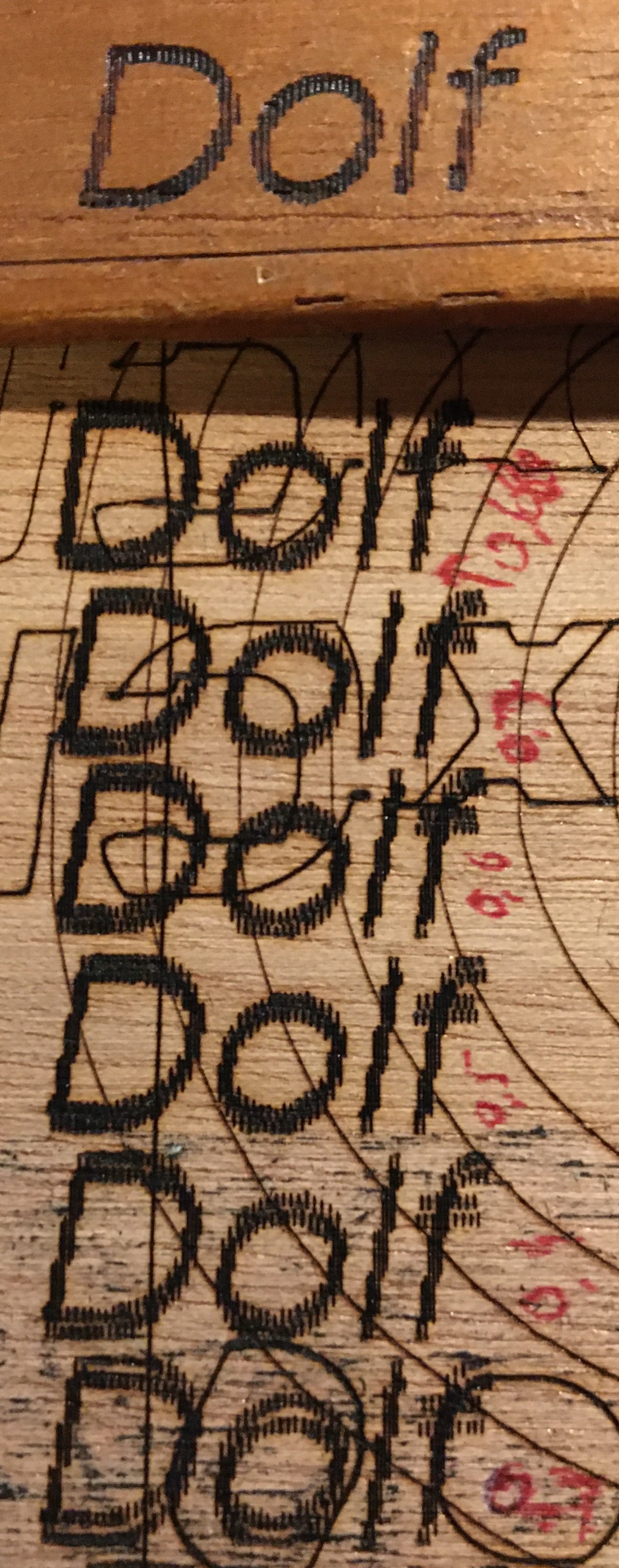

tommylight,
Thanks for your info.
I changed the X-axis with an other old (3 fase) steppenmotor and a M3 spindle movement without any problem.
Nothing has been changed to the (4 fase) Y-axis steppenmotor, but there the issue starts.
Mechanically the Y-axis is indeed a mess, it is gear driven with 2 gears before moving a gear-bar (on which the laser is mounted)
Willing to change it into a spindle driven movement too, but the 28BYJ-48 is already x64 slowed down and is too slow for that.
But the old setup did worked for several years without problems, although the backlash of 1.315 (mm) on the Y-axis.
My setup was always with a Raspberry Pi 3B+ controlling 2 L293D and 2 (28BYJ-48) steppenmotors.
Now i only changed X-axis and updated the Raspberry OS which result in weird backlash issues on th Y-movement.
It looks like on picture drawings (2 way y-movement) it does now turn on the laser before doing the backlash.
On one way the laser burns much longer than usual (earlier).
I will add a picture with on top the old burning (g-code) and below the new ones, same g-code.
You will see much lines extra (longer) burned on the new ones (one way) regardless what backlash i give, although backlash does something.
In red the given backlash is written,
Btw: I added the BACKLASH_VELICITY as i found is somewhere on the internet, but it does not speed up the backlash nowadays.
