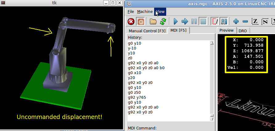

Hi everyone,
Then of simulation test in vismach and kinematics equations, I have still some doubts with the simulation and the kinematics results. I don't know if is proper of the LinuxCNC offsets or something like that, or something in the kinematics parameters.
1. When I invoke the robot simulation, in the AXIS screen, in Manual Control [F3] tab, I HAVE to push in "Home All" because If I don't do that and push MDI [F5] tab first of the homing instruction, the robot adopts a different position that initial configuration.
As You can see in the images attached. The first one doesn't have a homing instruction, while the second one has the homing instruction. The coordinates in MDI[F5] tab, changed.
And If I don't push homing instruction first, when I typed some instruction, the kinematics fail completely. Ever I have to push homing instruction first.
Is It wrong? Why did it happen?
2. When I typed some command in MDI [F5] tab like [G0 X200 Y700], the robot does the displacement, but the precision of the coordinates differs. And the final coordinates are e.g. [X=202.124 Y=712.054]. And that positioning error increases.
But, If I run any NGC program in MDI mode, the final coordinates are the same of the command coordinates. Without positioning error.
Why did it happen? Looks like some variables values in the kinematics have some junk data of old iteration, Is it possible? I don't know what is going on, if it is really happens something.

you should allways home the machine first,
you can set it so it homes when first switched on , after that and so long as the machine is not switched off , it will hold correctly
also if you are using loading tool table , make sure all the values are zero
make sure your not loading any offsets or clear offsets first in your gcode .
