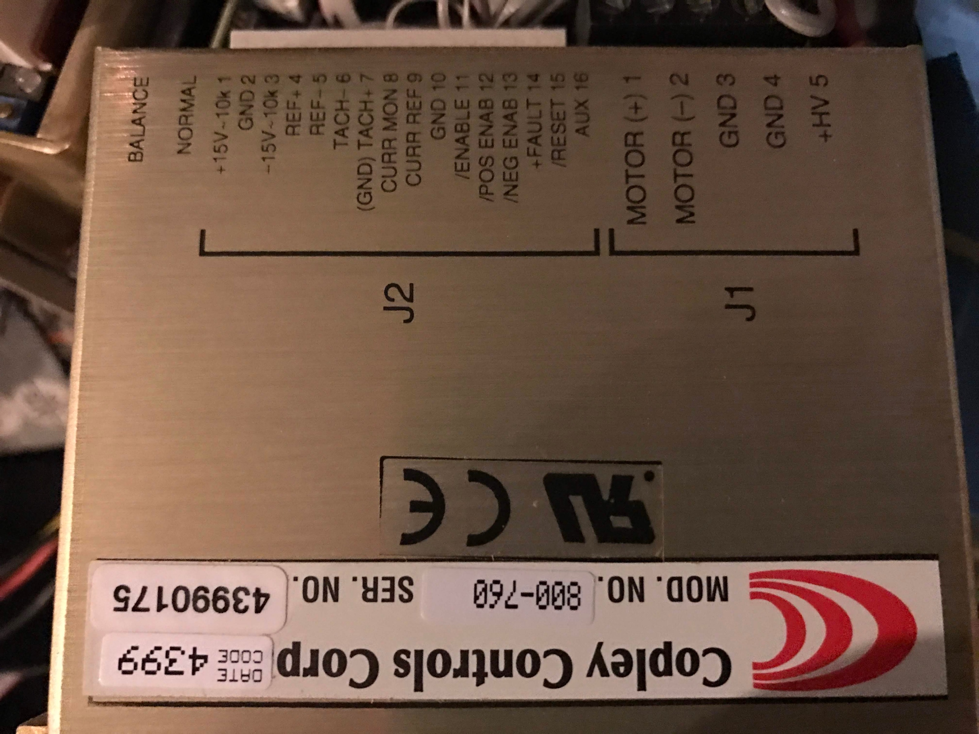

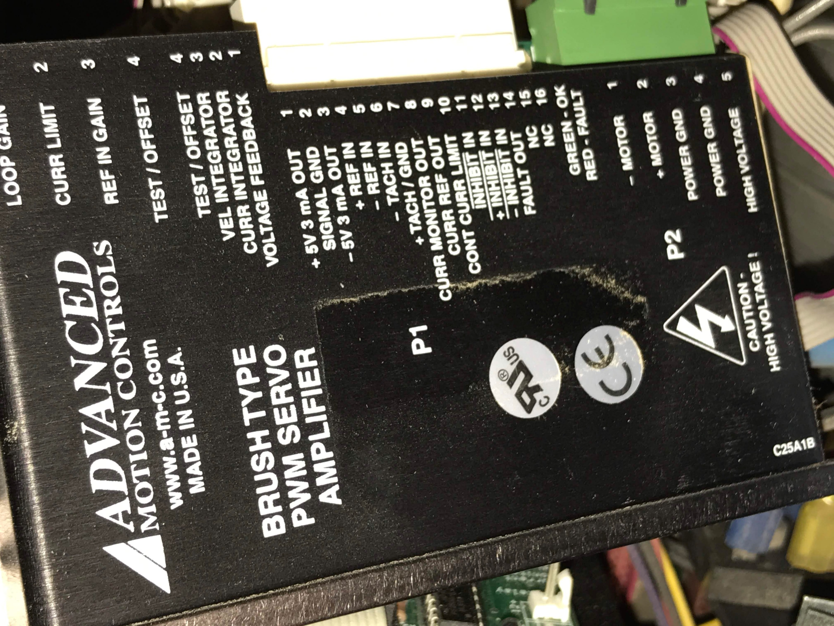

PCW, sorry to bug you again, I have looked and I can't seem to find any info on these drivers to see if they are Velocity or Torque, is there any other way to find out? Probably right in front of me.
I do think I must be doing something wrong, as the changes I make really don't make much difference. Obviously when I change the P to 500 it starts oscillating and the gantry shakes and makes some pretty loud noise, but the difference between 50 and 300 I can't really tell too much. Below 50 for P and I get following errors.
Not sure if I am not looking in the right spot or what?
Last edit: 29 Aug 2019 21:40 by randypetersen.
29 Aug 2019 21:56 #143601
Replied by PCW on topic Servo Wiring and Tuning detailed How To example Mesa 7i77.
1. If the drives have the tachometer connections wired, they are in velocity mode
2. Can you post your current hal/ini files

29 Aug 2019 21:59 - 29 Aug 2019 22:11 #143602
by randypetersen
Replied by randypetersen on topic Servo Wiring and Tuning detailed How To example Mesa 7i77.
They are always in flux... Here they are currently.

29 Aug 2019 22:13 - 29 Aug 2019 22:14 #143607
I would 1.
set all I terms to 0
set the P value low
Dial in FF1, its the most important tuning number for velocity mode drives
FF1 = 1 cannot be right unless the axis move at 10 IPS at 10V
You can also verify that the drives are operating in velocity mode
by setting the analog voltage to 0 (set P=0 in the calibrate menu)
The motors should hold position or drift slowly, and in any case resist
applied torque.
2. Do a halscope plot of commanded velocity and following error for a short move
set the P value low
applied torque.
Last edit: 29 Aug 2019 22:14 by PCW.

29 Aug 2019 22:27 - 29 Aug 2019 22:29 #143610
by randypetersen
When I set P=0 on both my X and Y they both can easily be pushed.
They come up "Joint x following error"
When they have a value, like 50, then I can not push them.
At first I thought my ferror was set to small thinking I was pushing them then triggering a joint following error and then disabling the drivers so they could move.
Was that the expected behavior? or did I screw something up.
The machine is working, it's just I have to apply very little force to the motors, or I get following errors.
I wanted to check X and Y, since my X driver is a different brand/model than my y and z. I thought for sure that the odd driver would be the Z, because it had the brake and the screw drive. When I got the machine the odd driver " Advanced Motor Controls" was the X and the Y and Z were using the "Copley Controls" very possible I wrote that down wrong before I disassembled it.
