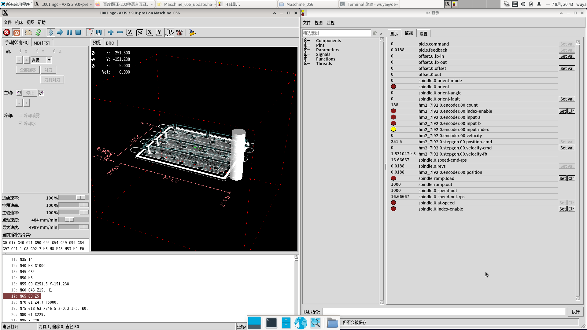

07 Aug 2023 11:43 #277227
Replied by tommylight on topic spindelkonfiguration stepdir problem
The gcode has M3 but does not have S1000 or the spindle RPM in it, try adding that.
Also the spindle.0.at-speed is still off.

Now it's M3. After turning on the spindle, all joints stop working

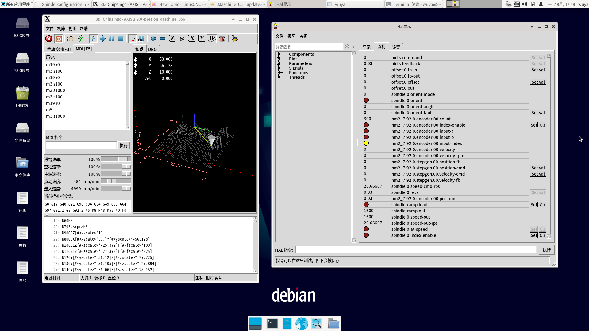

07 Aug 2023 12:46 #277235
by wuyatom
Replied by wuyatom on topic spindelkonfiguration stepdir problem
Will get stuck in this place

07 Aug 2023 18:25 #277263
Replied by Aciera on topic spindelkonfiguration stepdir problem
Try the 'halshow' tool to look at the 'spindle-at-speed' component (which is a 'near' component).
linuxcnc.org/docs/devel/html/hal/halshow.html
With 'halshow' look at the pins
'spindle-at-speed.in1' connected to your spindle spindle speed command
'spindle-at-speed.in2' connected to your spindle encoder feedback
'spindle-at-speed.out' connected to the spindle.0.at-speed (which needs to be true for the motion to begin)
'spindle-at-speed.difference' sets the tolerance
In your hal file you have:
setp spindle-at-speed.difference [SPINDLE_0]MAX_ERROR
and in your ini the value is set to:
MAX_ERROR = 0.1
So you may want to try larger values for MAX_ERROR.
MAX_ERROR = 0.1
11 Aug 2023 13:02 #277638
Replied by andypugh on topic spindelkonfiguration stepdir problem
This looks like a spindle-at-speed problem.
But, assuming that emcoder.00 is the spindle encoder, it looks like a genuine not-at-speed.
spindle.0.speed-out is 1000 rpm, and the encoder velocity is zero.
So, for some reason, the spindle isn't turning.
Is the stepgen enabled?
