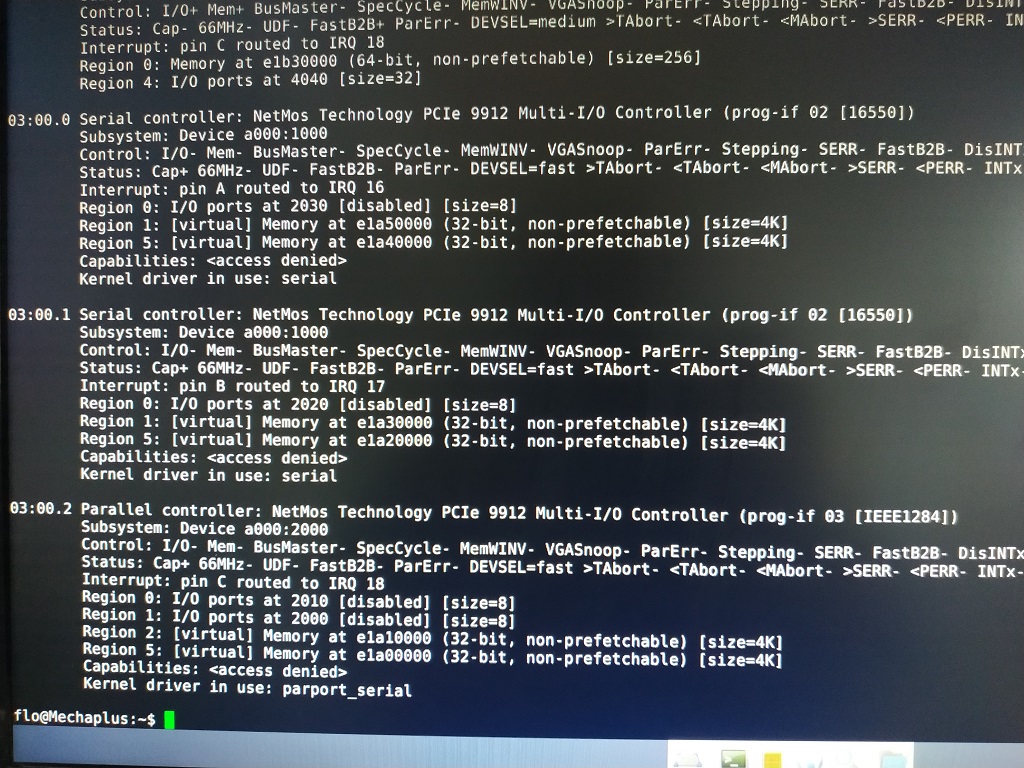

with lspci -vv I got following result:
(here in that pictures is written "disabled" -> which is not when I start the pc)

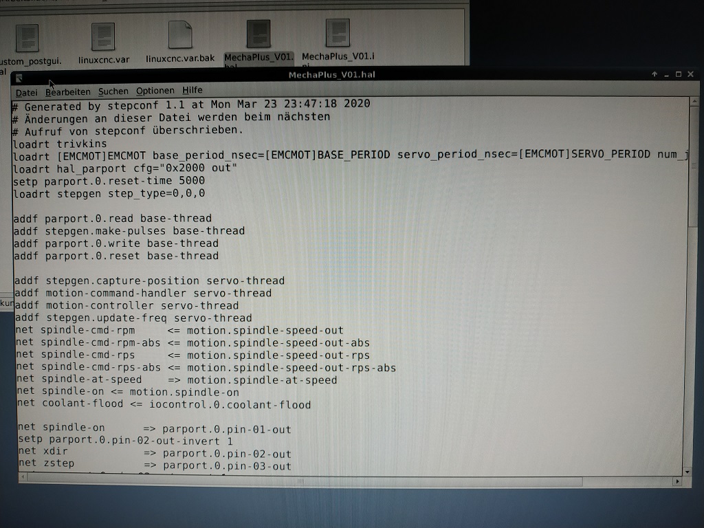

Installing driver seems not necessary so I inserted to HAL file "0x2000 out 0x2010 in"

When I then repeat lspci - vv command I got the reading as shown in the picture above. The card seems to be disabled.
I cannot understand why. Do you have any idea?

That is a PCI-E card with MosChip controller, i have use plenty of PCI cards with MosChip devices, never had a single issue.
Can you try:
loadrt hal_parport cfg="0 out"
one thing i did notice on lspci is that driver in use is parport_serial, but i have never had that, just parport, and yes most of them had 1 parallel and 2 serial ports.
Can you try:
