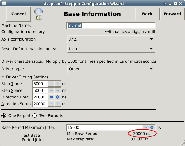

Hello,
I just started with the Stepper Configuration Wizard and looked after this in the .ini File
For example, I typed in "base period" 35000 and the generated ini file contains only
"BASE_PERIOD = 100000". Or I cant find "motor steps per rev" (200) or "microstepping" (2) here,
or in other generated files.
My systems works fine (so far), but I would like to know how these things work together.
Thanks & Best Regards
Roman

It's the SCALE parameter you're looking for.
That's how many steps per millimeter or inch.
Say for instance you have a 5mm pitch leads screw, with 200 steps per rev & 8 micro steps.
scale = STEPS_PER_REV * MICRO_STEPS / LEADSCREW_PICT
= 200*8/5
= 1600/5
= 320
Stepconf asks you for base period max jitter, then calculates the actual base period based on the figure you put in for the jitter. If you open up stepconf and reread the Base Information page you'll see what I mean.
= 200*8/5
= 1600/5
= 320

Thank you, know I understand scale. But BASE_PERIOD do not seems to work proper here.
When I enter "Base Period Max Jitter" 35.000, "Min Base Period" is calculated in the info down there as 50.000. But *.ini is written with 100.000
When I enter 50.000, "Min Base Period" is calculated 65.000 but *.ini is still 100.000.
I use this the RTAI Version
linuxcnc.org/docs/2.8/html/getting-start...#cha:Installing-RTAI
No problem to correct this manually but I would like to be sure, that 50.000 is the right value

Test with default 100000, after you are sure the motors are running properly and the scales are ok, you can edit the ini file and change that.
Replied by tommylight on topic I do not find "base period" or "motor steps per rev" in my .ini File
It might not be, cheap stepper drives use cheap optocouplers, so sending fast pulses to them results in no movement from motors, causing aggravation with users.No problem to correct this manually but I would like to be sure, that 50.000 is the right value

Going by the docs 35000ns is about 16% over what is recommended for software stepping.
I’d be looking to reduce that via some bios tweaks to reduce that.
Have you looked in your bios and turned off any power saving and hyperthreading ? On a multi core CPU it might be an idea to use the isolcpus kernel option.
Or if it’s an older machine Wheezy might be worth a try.

hi, I tested my mini mill with 50.000 Base Period and seems to run very fine
I think the 100.000 is just a bug in the RTAI version, this value does not change, when changing "Base Period Max Jitter"... and it should
@BeagleBrainz this is the best I can achieve with my pc, its a longer story
forum.linuxcnc.org/38-general-linuxcnc-q...h-57000-good-enought
Also, I have the linuxcnc settings from the sherline factory computers
www.sherline.com/product/linuxcnc-comput...-without-driver-box/
and they use also 50.000. This should works fine with the sherline driver box.

Do you get latency warnings on the lower right corner ?
If not, all is good, you can even try a bit lower base period although probably no need for it.
