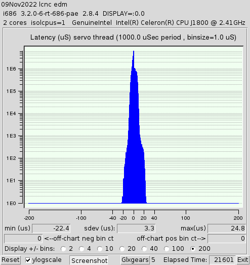

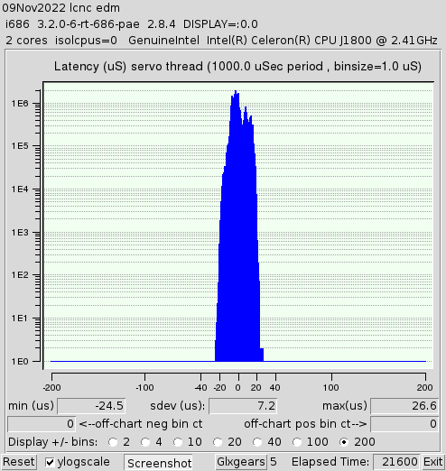

11 Nov 2022 12:27 #256422
by D.L.
Replied by D.L. on topic Results of latency test, list of computers tested for use with LinuxCNC
MB GA-J1800N-D2H(BIOS F6)
RAM KVR13S9S8/4 4Gb
SSD SA400S37/240G
Debian Wheezy 3.2.0-6-rt-686-pae
LinuxCNC v. 2.8.4 rip build
kernel parameters: "isolcpus=0 intel_idle.max_cstate=0 processor.max_cstate=0 idle=poll quiet"
kernel parameters: "isolcpus=1 intel_idle.max_cstate=0 processor.max_cstate=0 idle=poll quiet"
RAM KVR13S9S8/4 4Gb
SSD SA400S37/240G
The following user(s) said Thank You: seuchato, tommylight

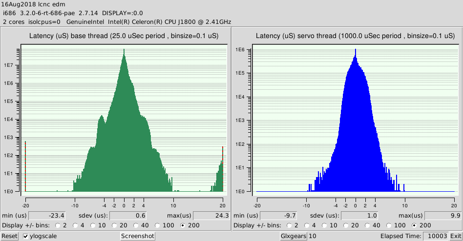

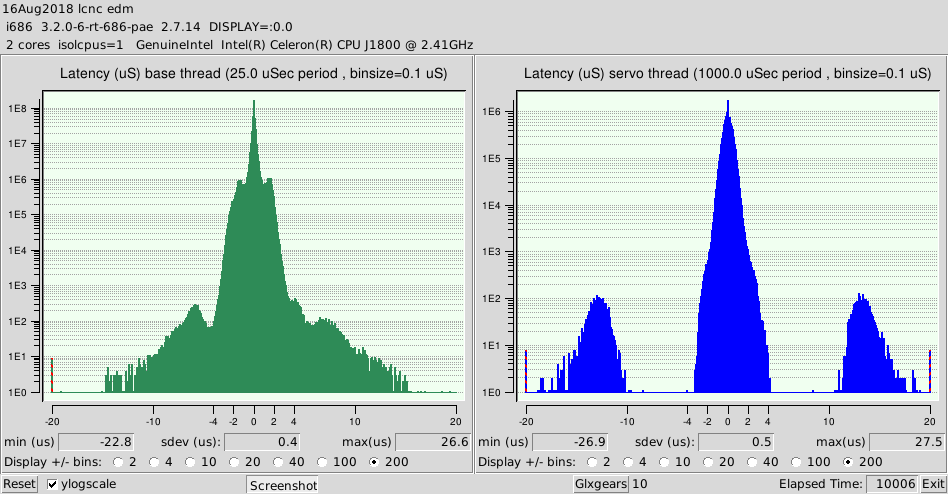

15 Nov 2022 19:56 #256797
by seuchato
D.L.
The results are nice and seem to support my assumption, rotational discs hamper latency - on first sight. A closer look shows, one test is with 5 glxgears and the other with 10. So: are these two results really comparable in terms of reproducibility?
I am working on updating the script as promised right now. No ETA so far. It will address the bugs recorded up to date and have some enhancements too. So, stay tuned
greez chris
Replied by seuchato on topic Results of latency test, list of computers tested for use with LinuxCNC
Old test of this hardware(with HDD).
LinuxCNC v. 2.7.14
kernel parameters: "isolcpus=0 lapic quiet"
kernel parameters: "isolcpus=1 lapic quiet"
D.L.
greez chris
