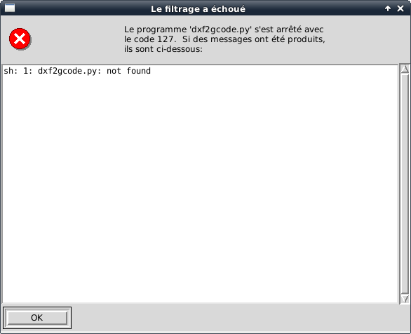

Hello,
is somebody can help me to integrate DXF2GCODE in AXIS?
I follow this instruction
"Integration in EMC 2.2 and AXIS" but it don't work.
I have this message error
Thank you

What does python dxf2gcode.py in a terminal produce?

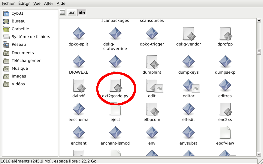

Hello ArcEye,
By this way, it works well. Maybe I forgot something...
I have try to put all files of "dxf2gcode/source" in "usr/bin" (with sudo and terminal) but it doesn't work too...
I have tried both method (symbolic link and paste all files in "usr/bin")
I have a fresh installation of LinuxCNC 2.7 (debian wheezy)
I will show you how I do (sorry for my english)
1) I made a symbolic link
2) I made the link executable with this command
$ sudo chmod a+x /usr/bin/dxf2gcode.py

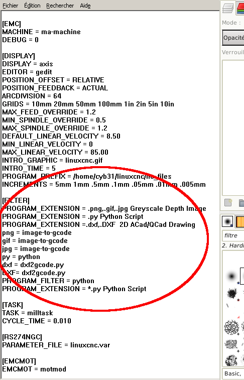

3)I changed the section filter of my .ini file

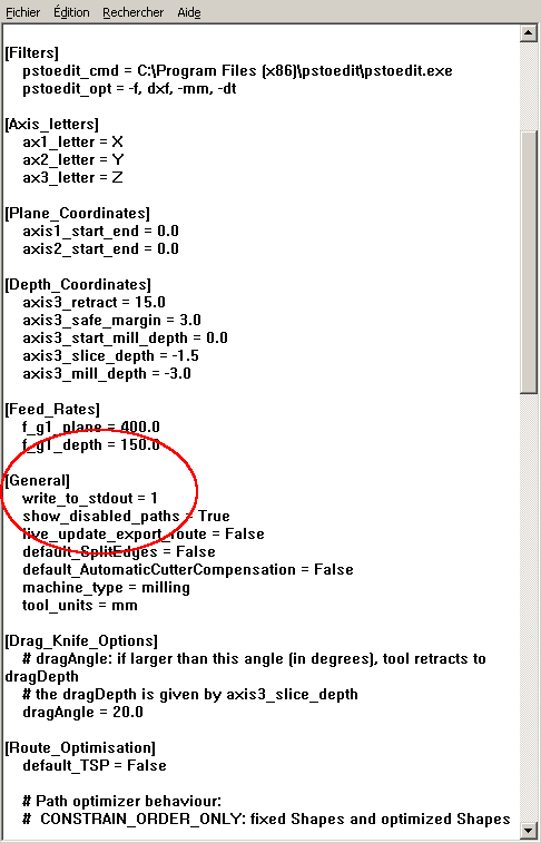

4)I changed the config file of DXF2GCODE

What happens if you put an absolute path to dxf2gcode.py in the LinuxCNC INI file?

in your ini there is 2 times dxf2gcode only one is alowed
as CASE names are acepted in loader
i uploaded a install Video Here ->
