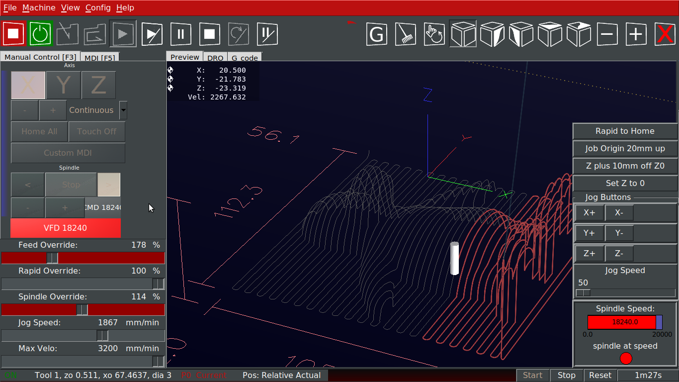

this works and I like it only for some reason the sliders cover the spindle dro, maybe I should try a different monitor resolution?

23 Oct 2022 02:24 #254821
Replied by tommylight on topic Axis 2 - touchscreen version of old friend
If there is a possibility of changing the font size, try that.
The following user(s) said Thank You: zack, Masiwood123
23 Oct 2022 06:30 - 23 Oct 2022 06:33 #254828
by zack
Replied by zack on topic Axis 2 - touchscreen version of old friend
I can scale the sliders with a setting if u want.
can also place the a axis button next to xyz - some space saving

23 Oct 2022 06:55 - 23 Oct 2022 07:12 #254829
by zack
The concept of axis2 was initially a quick fix for an environment where there were new users and different machines in use.
The buttons were enlarged because most machines had a elo-touchscreen from previous controllers already available.
And to make it look a bit more modern. The use of color for feedback ie job running = red menu bar and paused orange - etc.
The new ops were taught to leave a machine in a state of red or orange if there was a current job on the machine, to avoid another user from disturbing it, hence the color change.
The lathes in shop were set to a greenish feel while mills were set to a blue type to distinguish the difference of appearance of machine types.
the spindle override was also set to a min of 30 percent to avoid stalls on the mills for safety. A timer at the bottom was also started on a job run to help ops calculate a quick idea of machine time used per cycle.
Axis was chosen because most students grasped the concept of a controller in only a day or so, some older bridgeport type ops preferring the dro and newer users liking the backplot.
I was hoping to do a touchscreen in glade or QT but the time constraints did not allow, and i found it kept breaking on different linux installs with different python libs. Hence trusty old tk tcl.
I will be committed to maintain this version (Axis2). as i still periodically add/fix requests for our environment.
Last edit: 23 Oct 2022 07:12 by zack.

23 Oct 2022 09:26 #254834
by Masiwood123
Replied by Masiwood123 on topic Axis 2 - touchscreen version of old friend
thanks in advance, that would be great, also if there is a possibility to make the spindle start, stop a bigger button? I have always been bothered by the axis gui, because the buttons for some frequent operations are very small. Another question is that I would like to have some basic buttons for some MDI shortcut, some things I will often change, like spindle to A axis(m64 P0) and similar but i think that is a gladeVcp question.
23 Oct 2022 10:50 - 01 Nov 2022 17:27 #254843
by zack
Ok - there is a custom mdi button in the config menu you can assign only one line of gcode, it will save with close, and you can toggle the button which will appear below jogging dials.Will need a screenshot from u with the version tested below - attached new axis2.tcl
