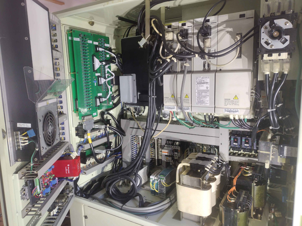

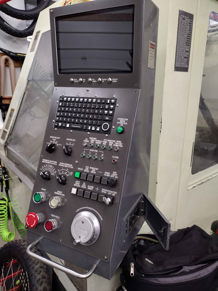

cmorley - I didn't find any properties associated with disabling radiobuttons and checkbuttons in the Configuration:Control Panels:pyVCP:Widgets section of LinuxCNC_Documentation.pdf. I Googled a bit more and didn't find anything specific. Guess I was curious if there were additional properties not listed in the LinuxCNC doc. I may delve into GladeVCP, but writing XML files in Geany for pyVCP is really simple for someone who is better with hardware than code.
The purpose for this initial VCP is just to sort out IO and setup for a a VMC conversion that will retain 95% of the original machine hardware and electronics. Pics of the revised control panel and machine cabinet are attached. A CTI USB keyboard and small USB/HDMI touchscreen replace the original monitor and keypad. Ultimately I envision a simple, tab-based interface onscreen that does not try to duplicate all the hardware interface. IO is taken care of through 2 MESA 6i24 PCIe cards. Seven Mitsubishi servos controlled via a Yurtaev PCI adapter card. IO runs through my custom opto boards (green pcb's on the machine cabinet wall).
rodw - I'll take a look at QtDragon. Thank you both.

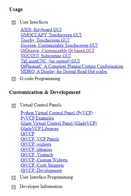

Found the QtDragon page at linuxcnc.org/docs/devel/html/gui/qtdragon.html. Also found the QtVCP page at linuxcnc.org/docs/devel/html/gui/qtvcp.html#cha:qtvcp. Great stuff. Strange that I had to find them through a Google search rather than through a link on the linuxCNC.org site ;) Very cool, and great documentation - I will look into it for developing a future UI. In the meantime, I think I can do everything I need to right now in pyVCP by becoming familiar with the HAL commands.
