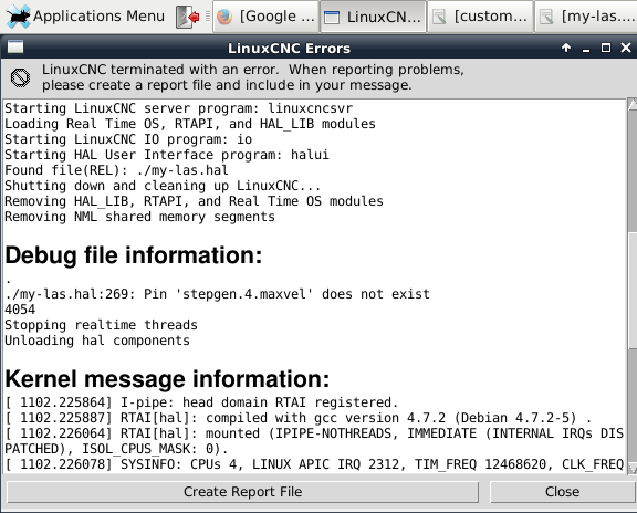

i want to connect pyvcp spinbox to stepgen.n.maxvel value
but i can't find the stepgen.n.maxvel pin in hal components
can anyone help me?
can anyone help me?

I'm using stepgen.3 and stepgen.4 for external eoffset movement. I want speed down can be adjusted with spinbox pyvcp
#speed eoffset up movement
setp stepgen.3.position-scale 1
setp stepgen.3.maxvel 20000
setp stepgen.3.steplen 1
setp stepgen.3.stepspace 0
setp stepgen.3.dirhold 35000
setp stepgen.3.dirsetup 35000
setp stepgen.3.maxaccel 20000
#speed eoffset down movement
setp stepgen.4.position-scale 1
net speed-probe-eoffsetdown stepgen.4.maxvel <= pyvcp.probe-eoffset
setp stepgen.4.steplen 1
setp stepgen.4.stepspace 0
setp stepgen.4.dirhold 35000
setp stepgen.4.dirsetup 35000
setp stepgen.4.maxaccel 20000

If maxvel is a parameter then it can't be connected in HAL.
It would be possible to make a Python HAL component that watches the spinbox value and issues a "setp" command to change the value.
linuxcnc.org/docs/stable/html/hal/halmodule.html
