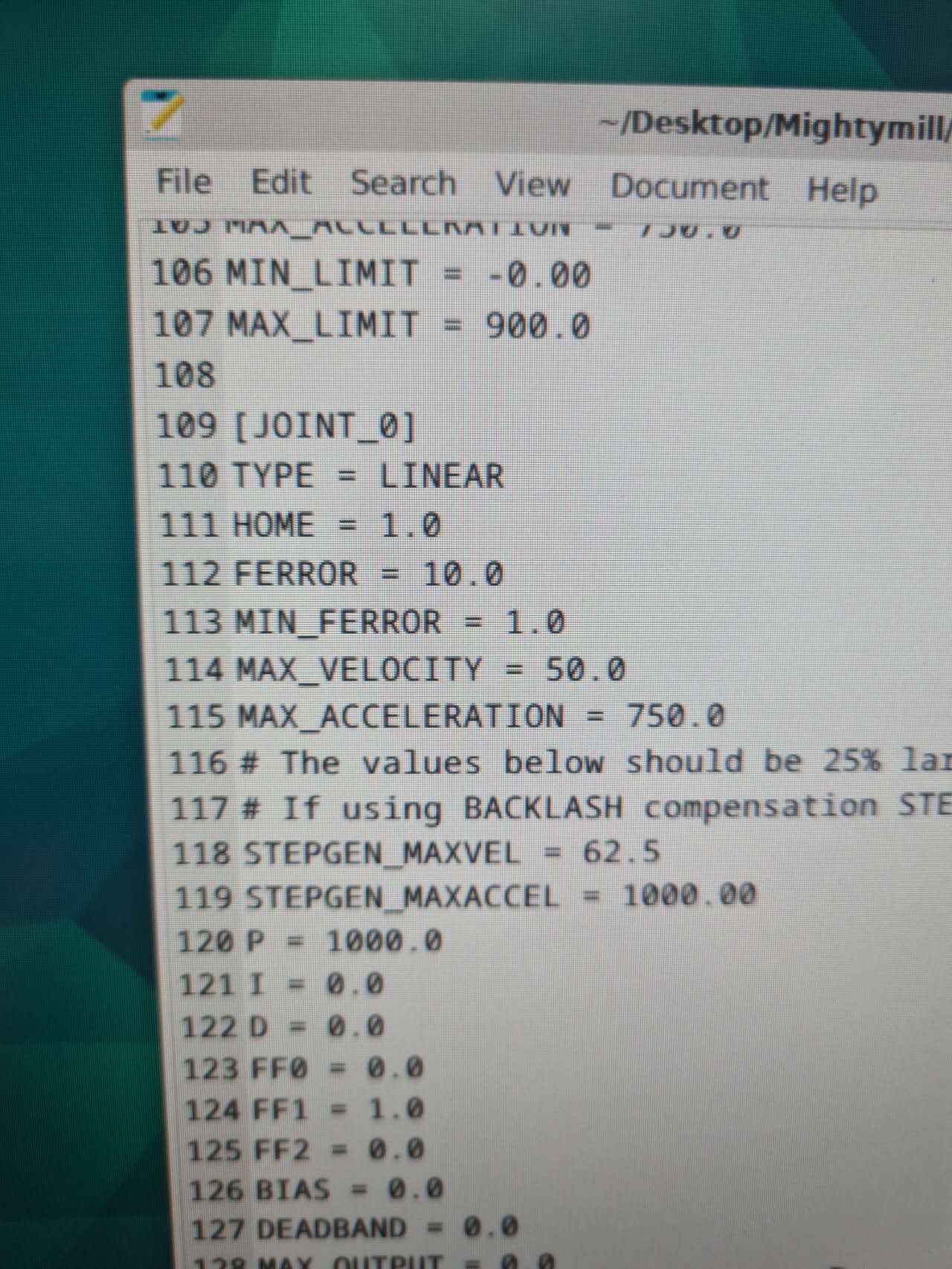

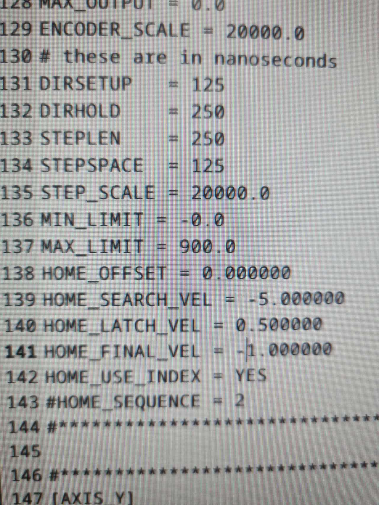

I think i found a bug in lcnc.something very strange happens when i enable the index homing.Note: homing with index = no works perfect. With yes weird stuff happens:Step 1 machine is on, x axis is (lets say middle of travel 400mm)Step 2 home x-axisaxis goes to home switch -> backs off home switch -> looks for index -> index found -> instead of setting that point as machine origin (normal behavoir), it still thinks machine origin = position of axis when you turn the machine on. So in this case it thinks index is at -400mm , instead of machine origin (0mm). It will now move the 400 mm back (back to axis position when it was turned on) using hom final velocity speed.When i set index homing back to no it works as expected. Im very confused. I have tested the index independently via the procedure listed above.My version is: axis.ngc-AXIS 2.9.0~prel git20230208.f1270d6ed7oneither im missing something or there is a bug in my version. Im very confused ?
