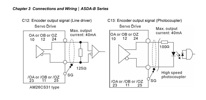

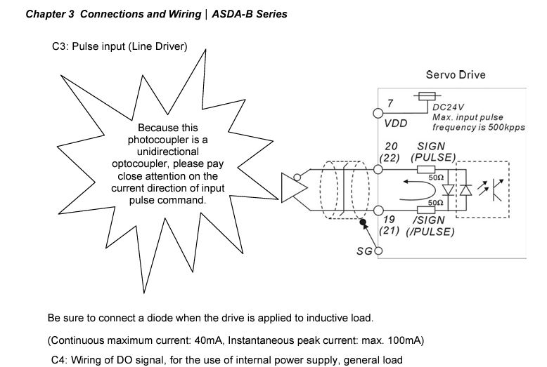

Hi everyone
I want to connect my 7i76E card to an ASDA-B drive and encoder feedback to the 7i85S board. I don't understand if I have to adapt the voltage-current levels between card and drive....Do I need to add resistors to limit the current?
Thanks everyone for the help
04 Mar 2024 14:40 #295139
Replied by PCW on topic mesa7i76e + 7i85s wiring to DELTA ASDA-B
No additional interface components are needed
