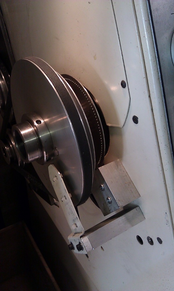

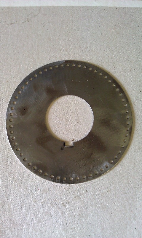

15 Nov 2011 13:13 - 15 Nov 2011 13:15 #14832 by ArcEye
Any recommendations for generic encoders that are easy to integrate with spindles?
If you have a keyed shaft or other means of positive location the below works well.
The disc has 120 holes read by an optical switch and the single embedded magnet provides the index pulse via a hall effect switch.
The second pic shows a 60 hole disc I made first, but found 120 was better.
regards
Last edit: 15 Nov 2011 13:15 by ArcEye.
15 Nov 2011 13:16 #14833 by ArcEye
