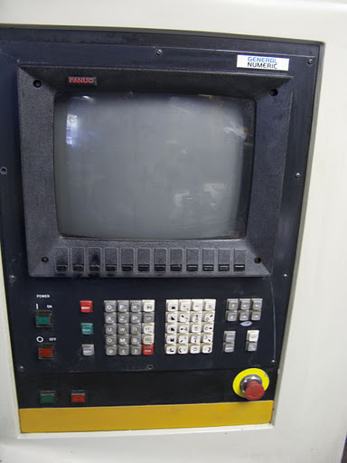

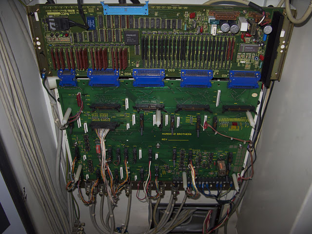

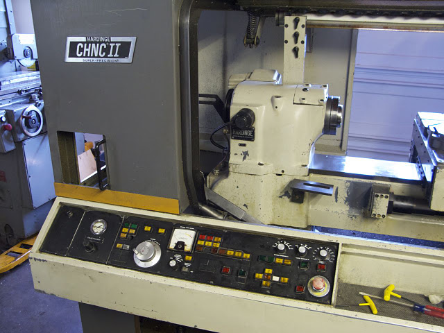

As much as I have learned from reading through other peoples build logs I figured I might as well post something of my own. My project is not terribly unique, as other users have converted similar machines.
The machine is a 1986 Hardinge CHNC II, purchased a few months ago on craigslist that had previously sat for years as a parts machine for another CHNC machine. However, only a few parts were ever removed.
The machine originally had a Fanuc/ General Numeric 10F control, siemens DC servo drives and motors, Fanuc spindle drive (dead) and Fanuc 7.5hp spindle motor.
Mechanically it is in good shape and ran with oil as the coolant for its whole life.
My goal is to retain the machines functionality while updating the control and electronics to something that I can easily work on and find parts for.
Here are some photos.

The machine thus far:
Intel D510MO with Picopsu power supply and solid state harddrive
I installed from the live CD, and run 2.4 now, but plan to upgrade to 2.5 soon to use some of the new features.
5i20, 7i33 and two 7i37s from the fine people at Mesa.
System has great latency right out of the box, as experienced by others.
15 LCD screen which fit nicely in the place previously occupied by big old Fanuc CRT.
