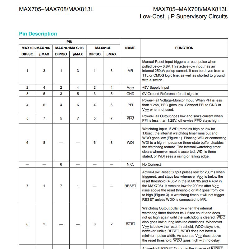

U25-7 has +4.77 V, but U25-5 has 0 V.and if I'm reading this right, it looks like U25-5 is the power for the U10 microprocessor. Why would that be zero volts? U25-6 has +5 V. Just to be sure I probed U10-14 and was 0 V also.

If U25-5 is low, then the system thinks it is in the middle of a power fail.
U25-5 will only be low when U25-4 is below 1.25V.
Is TP1 +5V when referenced to TP19?
What is the voltage on U25-4?
If it is lower than 1.25V, check R1 and R2.
Attached is the MAX705 Pin Descriptions.
U10 power is through Pin 44(+5V) & Pin 22(GND).

It turns out I was measuring the wrong pins on U25. Pin 5 does have +5V, so it doesn't look like that's the problem.
