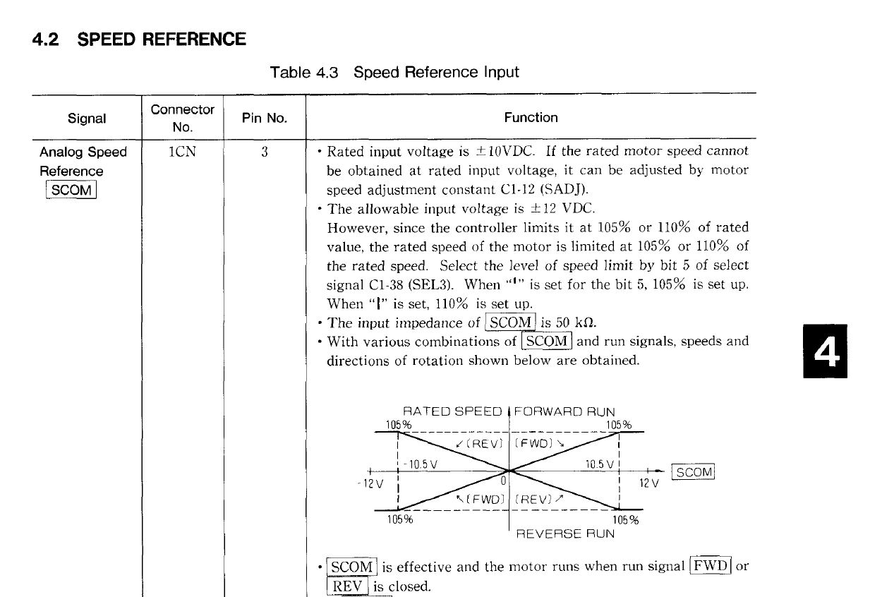

Ok, just checked on this real quick and here are the pins used on the VFD
Pin 3 = +/-10vdc
Pin 4 = 0vdc
When you mention the 7i77 has its own enable is that what you are suggesting I connect my wiring to for speed control or are you suggesting a HAL connection to something? I am figuring it is a HAL connection as enable on the 7i77 will just short out as it is a closure I thought.
Currently I have the enable lines connected to the enable circuit of the VFD. Then the analog5 out to Pins 3,4 on VFD. Attached is a snippet of the manual that shows the function of Pin 3 for +-10vdc. The VFD still requires a FWD or REV signal it seems to function.
Pin 3 = +/-10vdc
Pin 4 = 0vdc

Thinking about this a bit more and looking over the prints for the machine. (Posted on a previous post on this thread)
The original wiring used the following:
* +/-10vdc = Pin 3 VFD
* 0vdc = Pin 4 VFD
* Spindle enable (FWD) = Pin 37 on VFD
There was never a REV pin used on the original wiring.
So should I do the following:?
* 24+vdc to ENA+
* ENA - to Pin 37 on VFD
* Leave analog pin 3 and pin 4 alone (keep them on the pins they are at and the analog5 output on 7i77)
This would mimic the factory wiring for the VFD. Spindle FWD will come on when I press the FWD button in the gui or M3, but not sure what I would get when REV button on gui and M4 would produce. Guess the analog voltage will flip its sign and allow REV to happen.
I will go through PNCconf again to see what it produces as far as a setup goes.

+-10V and ena from the 7i77 should be all that is required for such a drive.
Since last i used the Elumatec was some 8 months ago i do remember much more about this than what and how it was on the Hurco, so for sure i know that the spindle will spin at 1RPM whenever the fwd or rev is pressed on the GUI, and yes it does spin CV in BOTH cases until the speed is raised at which point the spindle reverses at the speed set for CCV.
Unfortunately i do not recall much about the Hurco, but i am sure it did not need the enable from LinuxCNC to orient, the drive did that on it's own and would set a pin high when it was oriented.
Did you check that on your drive ?

14 Feb 2021 19:45 - 14 Feb 2021 20:39 #198833
by chopper79
Replied by chopper79 on topic Bridgeport Torq-Cut TC4G Retrofit
Well here is where I am at right now:
* 24+vdc to ena5 +
* Ena5 - to FWD on VFD (pin37) (Same way factory had it)
* Analog5 outputs to the respective pins on VFD
When I press CW or CCW on the gui the spindle rotates 1rpm in the correct directions. When I command M3s100 or M4s100 the spindle rotates correctly based on the command given.
Besides the 1 rpm rotation this is all functioning correctly. This may not be able to be corrected and/or bother anything.
***** Orientation of the spindle for ATC *****
Factory wiring had no wire for orientation or orientation complete. This seemed to be done by original controller using the spindle encoder and not the motor encoder. The orientation command was given for ATC and the spindle would rotate to 90.66° from the index mark and hold.
I can not get the spindle to orient unless I use the following: (I turned this feature on)
* Orient pin on VFD
* FWD pin on VFD
When using these the spindle will orient and provide a orient complete signal. If the VFD is in FWD mode then the orient pin can be excited and the VFD will orient the spindle to the XXXX pulses from index mark using the motor encoder. With FWD being on the enable I can now use the orient input to trigger the orient process.
Seem this is ok
* 24+vdc to ena5 +
* Orient pin on VFD
* FWD pin on VFD
Seem this is ok

14 Feb 2021 21:23 - 14 Feb 2021 21:23 #198844
by chopper79
Last edit: 14 Feb 2021 21:23 by chopper79.
