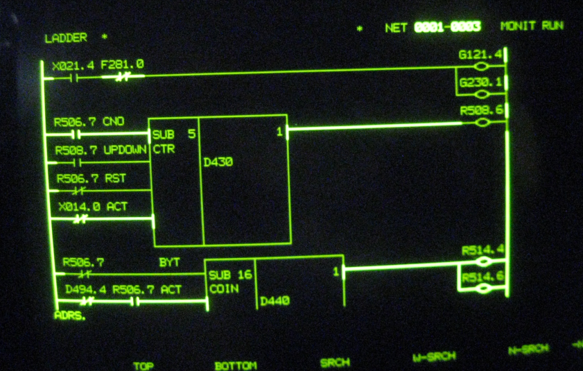

sivaraj, thank you! This is a pic of the ladder logic that I currently have. I am still working the limit switches. I will be away for part of the day. Many thanks.
24 Jan 2023 23:04 #262840 by sivaraj
Ladder shows X21.4 input is OFF or Machine is in Emergency stop State. Just trace this

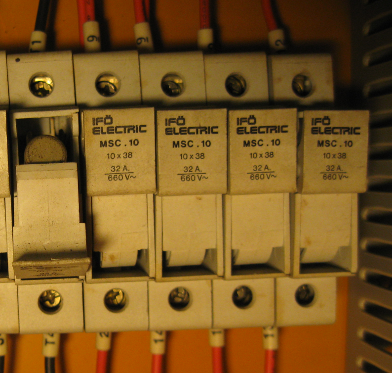

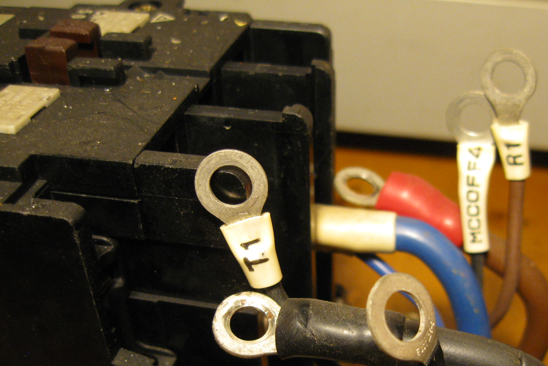

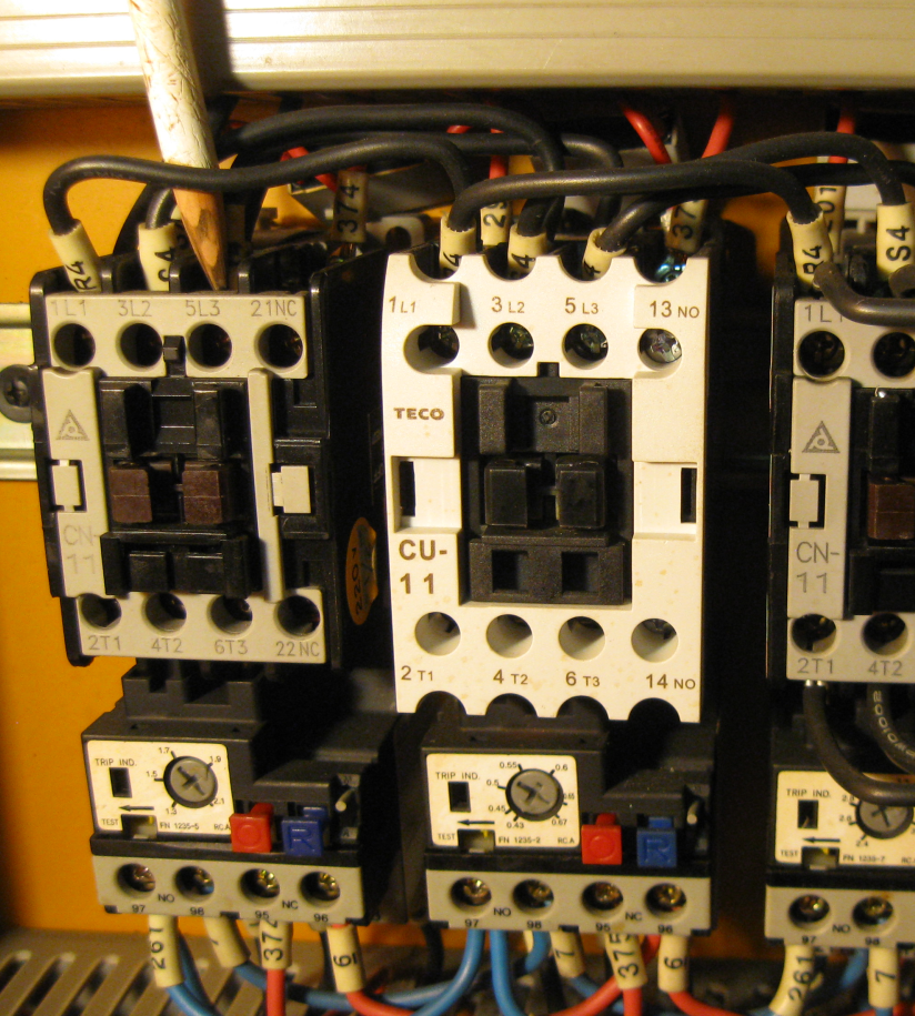

What was discovered is there is no power going through the Main Relay (this is just after the main off/on disconnect in the electrical cabinet/panel; see pic) because no electric at wire T1 that would bring the contacts together in this Main Relay is the thinking.
When T1 is traced, it goes to the top of the 5th Fuse from the right. Going out of the bottom of fuse, is wire T4 that goes to the top of ALL 4 of the smaller relays, look for the pencil stuck in the start location of T4.

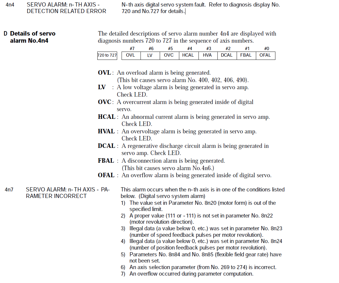

As a separate issue, the attached pic named; "This explains the issue" at the bottom read 6) parameter 269 to 274 have no data, all 0s. The machine builder sent this document, I believe some data is needed, and may be related to the power issue. The file the machine builder provided does not have any data in this set of parameters.
I have reviewed the parameters that I have keyed in manually, all match the file from the machine builder. The question I wonder about, if I get to a point where a download from a PC works, will that over right if I am not correct about the data I keyed in so far.
Many, many thanks, all suggestions warmly welcomed.
I do not think 269~274 required to set .
What alarm you have on screen . Please post it
Also post your complete parameter file here
Have you tried RS232 .
If you follow the RS232 settings I suggested it should work upload or download parameter with PC.
First try the PUNCH OUT > downloading parameter to PC . If you see readable data downloaded then try upload the parameter.
Earlier your default setting for Parameter 38 was wrong .So It wont work
Before uploading original parameter file , you may need to edit original parameter file (P38,P2,P12,P552&P553) to match with the RS232 setting that works for download .
