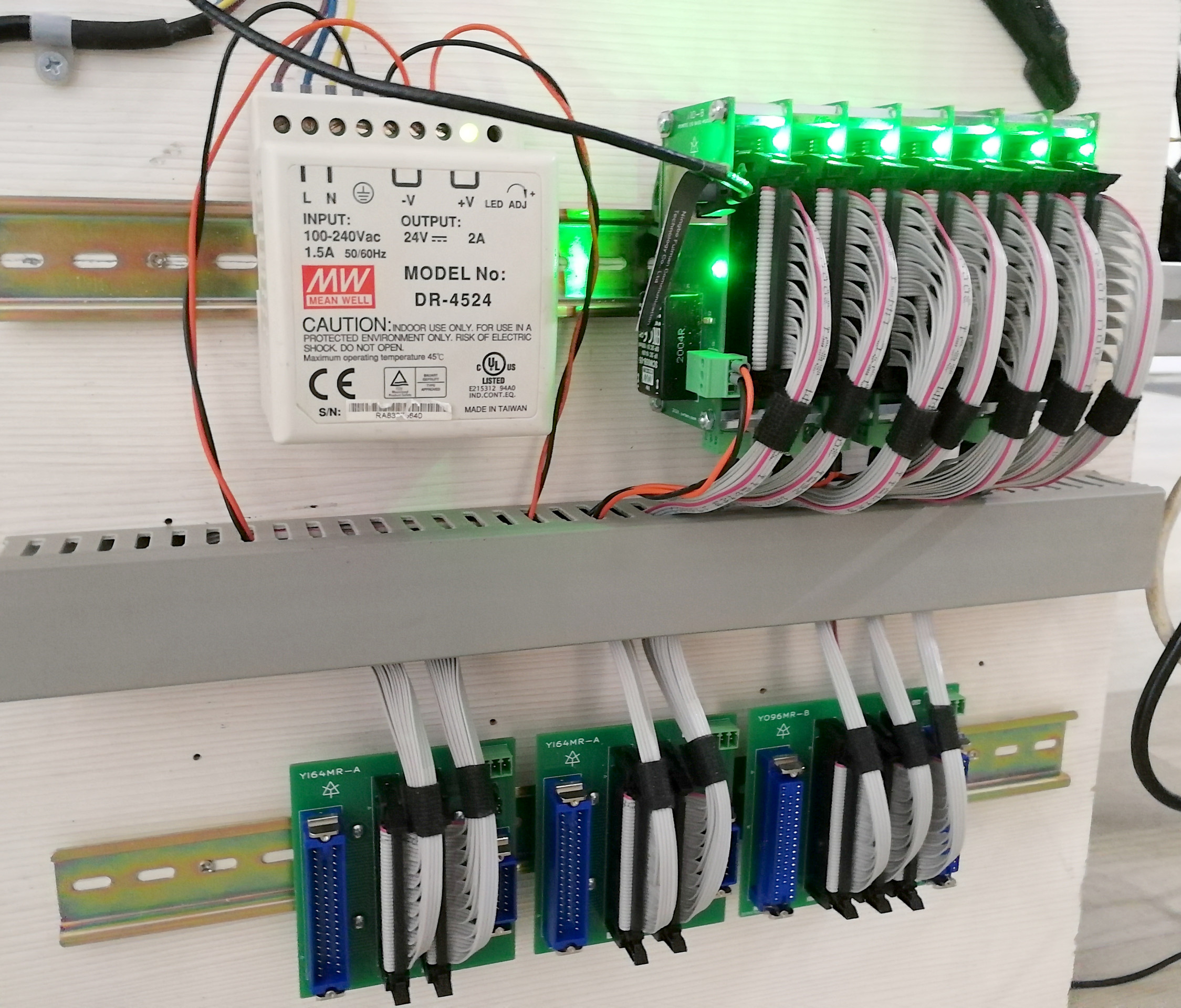

is there a price list anywhere for the IO cards, cables, and YMDSP2 card?
24 May 2023 04:04 #272073
by Madoxen
there are 80TB conectors/in/out of which 25 not in use( either in or out not connected)
Replied by Madoxen on topic Leadwell VMC760 with Meldas 520amr retrofit posability?
Correct 2 x QX351 boards the other 2 boards are QX522 and QX611-1on the photo i see 2 x QX531(?) I/O cards. each provides 64 ins and 48 outs. but on the next photo there're about 60 inputs and 23 relays. not sure where the rest is going, probably to the operator panel keys/lights?

This is awesome work thank you
dm17ry
I look forward to recieving this setup soon, Feel like I should create a new post with a rundown and how it all went type thing if you think it would help others.
26 Oct 2023 02:17 #283840
by Madoxen
I have received the Boards and cables and the work is top notch very happy with dm17ry's work and would not hesitate to recommend him if you need any of his products. I will be posting a few pics etc showing the build as it goes here for some continuity of the thread.
