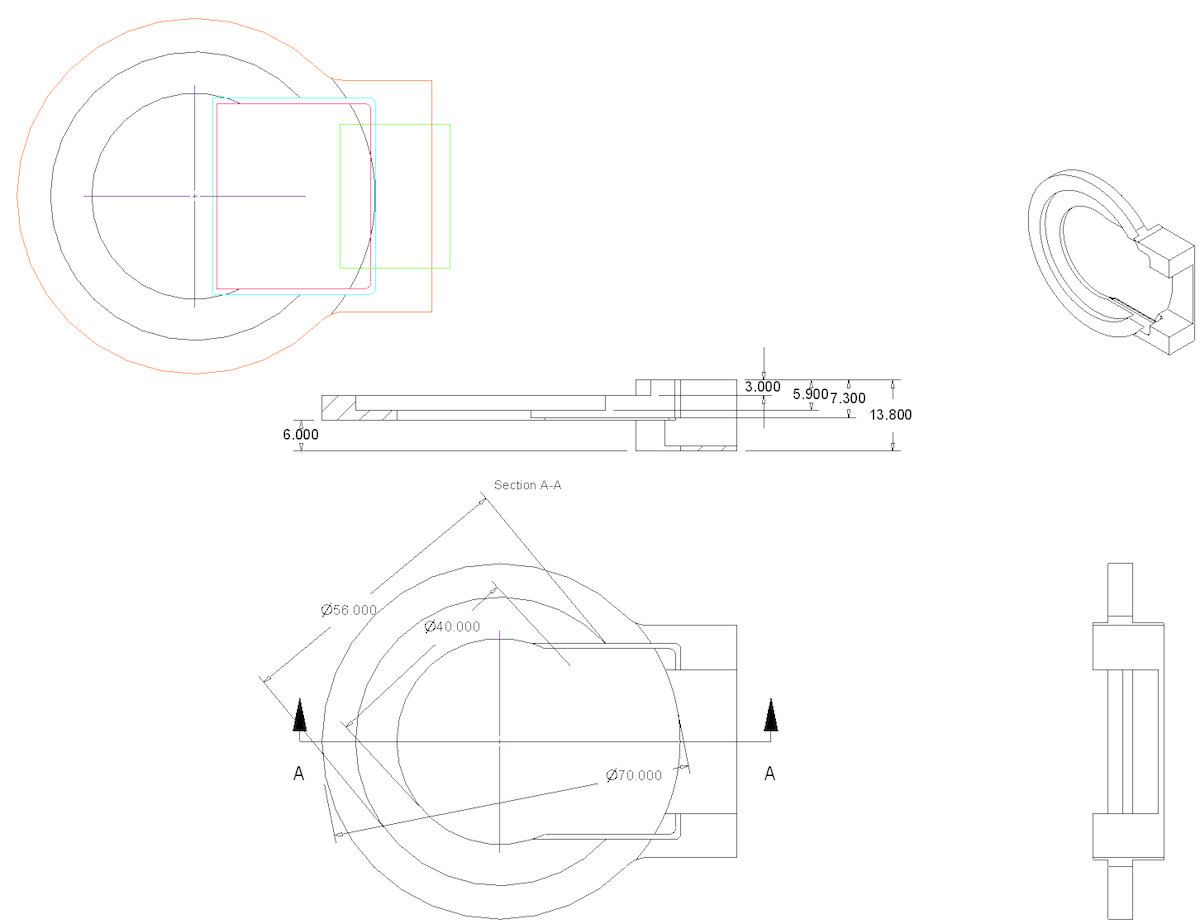

For 2.5D with SheetCAM the trick is to close the paths at each Z-height in the 2D-drawing part of your CAD, and then put all profiles of a certain depth in the same layer (I name the layers after their depth)
Then save as DXF
In SheetCAM you can then cut profiles or pockets with each layer.
It's fine for 2.5D, and doesn't do weird stuff.
It writes LInuxCNC G-code. Les is "one of us"

10 Jul 2012 23:19 - 10 Jul 2012 23:21 #21766 by andypugh
Replied by andypugh on topic Re:Favorite CAM software?
gera229 wrote:
How would I close the paths?
Draw extra lines in the 2D drawing.
If you look at the attached drawing, the top-left drawing section has extra lines added, and they are in layers according to depth.
Also, what is the difference between profiles and pockets? Or what is each and what do they do?.
With a profile the cutter runs round the inside or outside of the line. With a pocket the cutter spirals and moves to remove all material inside or outside the line.

11 Jul 2012 00:22 #21769 by andypugh
gera229 wrote:
I still don't understand what you mean by runs around, or sprials. Both sound like the same thing to me lol.
In that picture, the brown was a profile, to cut the part out of the block (last op, obviously). The green was a pocket, as I wanted all the metal inside it gone.
Red was a pocket, to remove all the material inside it, all the way through.
blue was a profile, as the metal inside was nearly all gone (due to red)
This might not be the most explanatory of examples, as all the internal circular features were done on the lathe.
