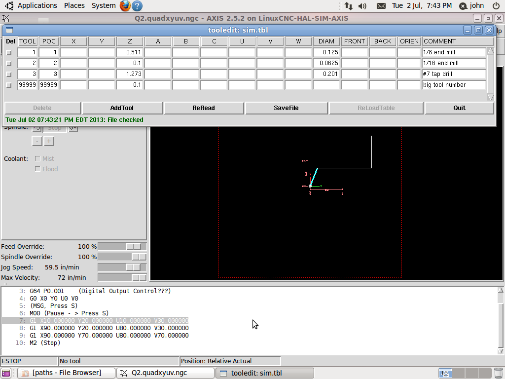

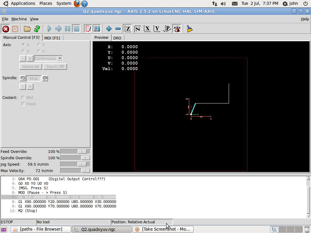

03 Jul 2013 07:36 - 03 Jul 2013 08:15 #36258 by jfeeney
Replied by jfeeney on topic XYUV toolpath generator
Thanks, I got it working. I am able to watch my toolpath.
1) I don't think I have a "Wire" tool. Should I have one? If so, how do I set it up....I have Google searched but can't find any details about doing it
2) Also, I can only see XY axis....whereas in the above video you can see XY and UV. I can't find any setup that would show the UV axis
Thanks, John

03 Jul 2013 15:03 #36263 by andypugh
Replied by andypugh on topic XYUV toolpath generator
I don't think you need a tool for a wire cutter. It would only be a useful concept if you were to have different wires (maybe running at different temperatures?)
It looks like "FOAM" mode is only available in the development version of Linuxcnc.
If you want to run the development version it is available as a pre-built package. Have a look here:
buildbot.linuxcnc.org

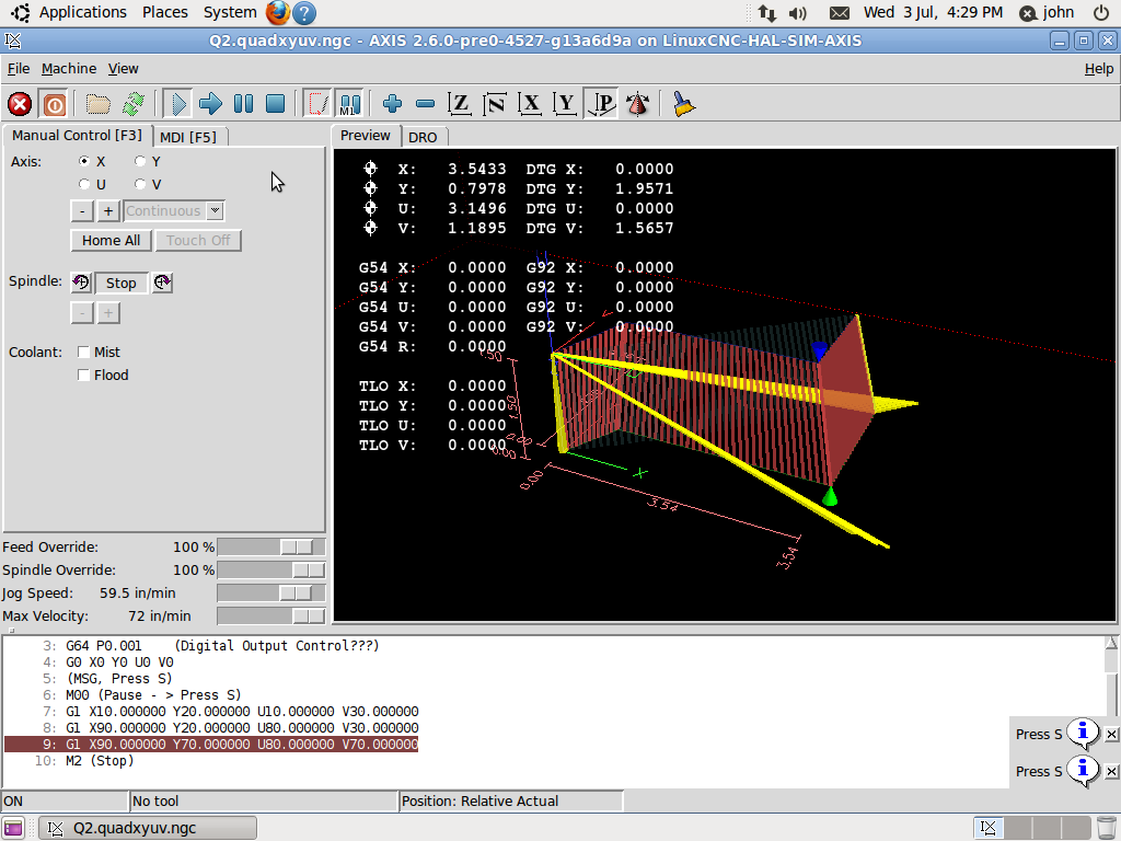

04 Jul 2013 03:42 - 04 Jul 2013 03:44 #36291 by jfeeney
I went to buildbot and followed the directions
I picked the files from the Lucid (32-bit and 64-bit), simulation since I have a 64bit Athlon.
Since it was called simulation -- I also picked the sudo apt-get install linuxcnc-sim
Everything installed ok.
I thought I might end up with LinuxCNC2.5.2 real time and LinuxCNC 2.6 Simulation but I only have LinuxCNC 2.6 simulation. Is it possible to have both? I am hoping that in a week I have my 3 axis wood router ready to go. Then I would want Real time.
Anyway, here is a shot about 30 seconds after I fired up LinuxCNC and reloaded my test gcode that I was using in the above screenshots.
