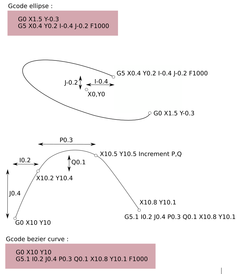

Can you give some gcode examples of how you think these could be used in a Gcode file?

Hi Rod,
Sure,
Attached example is in line with current Gcode programming style.
For ellipse the example is an open ellipse, the ellipse itself is defined under a angle. So the most difficult ellipse example
can be done in 1 line of gcode.
For bezier curve the input is like the cubic spline. I,J are first control points. P,Q are second control points.
Gcode can be done in 1 line of gcode.

3. Add it to the linuxcnc source code myself.
What would you do?
Imagine the above criteria is integrated in the linuxcnc source code. The G-code output will reduce with 80-96%.
The cnc machine will be more accurate to the path, because it no longer depends on interpolating the path over 1000+ line segments,
wich are not interpolated as should be in my opinion.

Hi Rod,
I also want to make some changes to the core code. Maybe we can work together...
Is oke for me. Did you already find out how to make a external c connection to hal?
If not, let me know over here. What change do you want to make?
I think the new G code will need to align with an existing gcode flavour so that there is post processor support.
I agree. But for 99% of the cam program's it will not work at this moment.
They have to improve their source code first.
For my CadCam program this new Gcode is working right away, this is how i would like to see a Cam program shitting out some gcode. High end gcode output. It opens more then only that. Pockets algoritmes, build up from splines. Wow.
@Aciera,
Sounds interesting BUT
It seems to me that NURBS-interpolation has kind of fallen by the wayside in professional machine controllers due to the increase in processing speed and memory size.
Nurbs are a kind of special. I never seen them around in dxf files. More common used one's are splines, ellipses and beziers.
I like the Nurbs idea and tested them yesterday in linuxcnc. A spline path instead of a nurb path can be considered as a good alternative.
What CAM can actually output the code required for NURBS interpolation on the controller?
That's the whole point. Now is the time to get Cam outputs in line with Cad data, and now is the time to get the EMC software up to date to do this job.
@bbsr,
most cam will split this bezier in 2-3 regulair radius ones
So far i know, sheetcam, dxf2gcode, pronest, etc will shit out thousands of line segments instead of one line of special G5 code.
And it is loosing path accuracy this way. For a cnc electron microscope, or a stealth fighter you can not interpolate this way.
never have had any problem on this on freecad or sheetcam with imported DXF
Actual, there is no real problem. There is a linuxcnc source code improvent request.
freecad draft can also make you regular rad out of bezier
But linuxcnc don't accepts this kind of shapes today. If linuxcnc has this option, you will see all cam program's will
improve their souce code.
