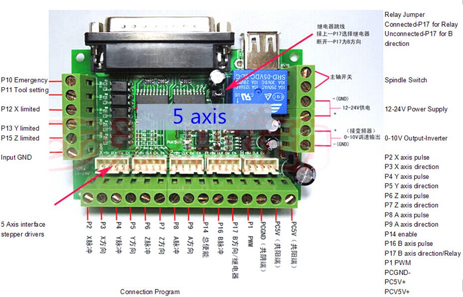

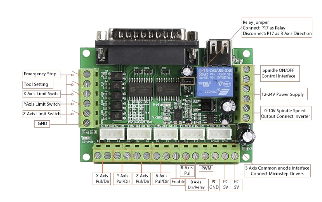

Found another bit of information from another vendor and it looks like PWM might be meant to be fed into P1 of the parallel port:
Can you actually reverse the spindle as well or is that "Spindle ON/OFF control interface" just an on/off relay contact?

Another manual: certainly looks like pin1 is the PWM

This board expects PWM on Pin1. Your hal file uses Pin 9.
Make sure to connect the 12-24V on the right hand side of the board and set the jumper for P17 - Motor direction correctly.
