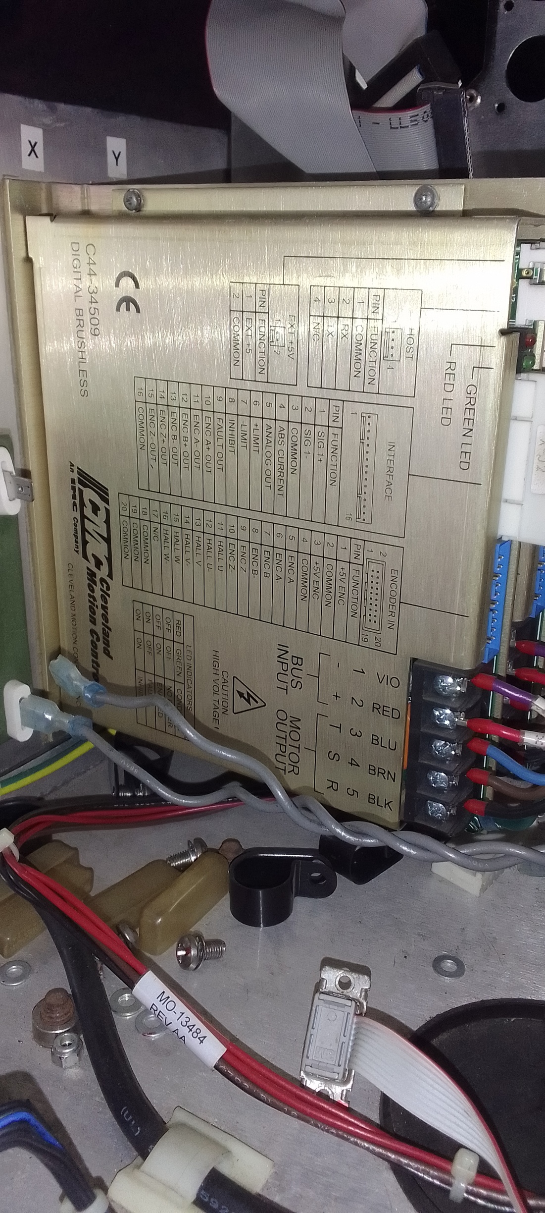

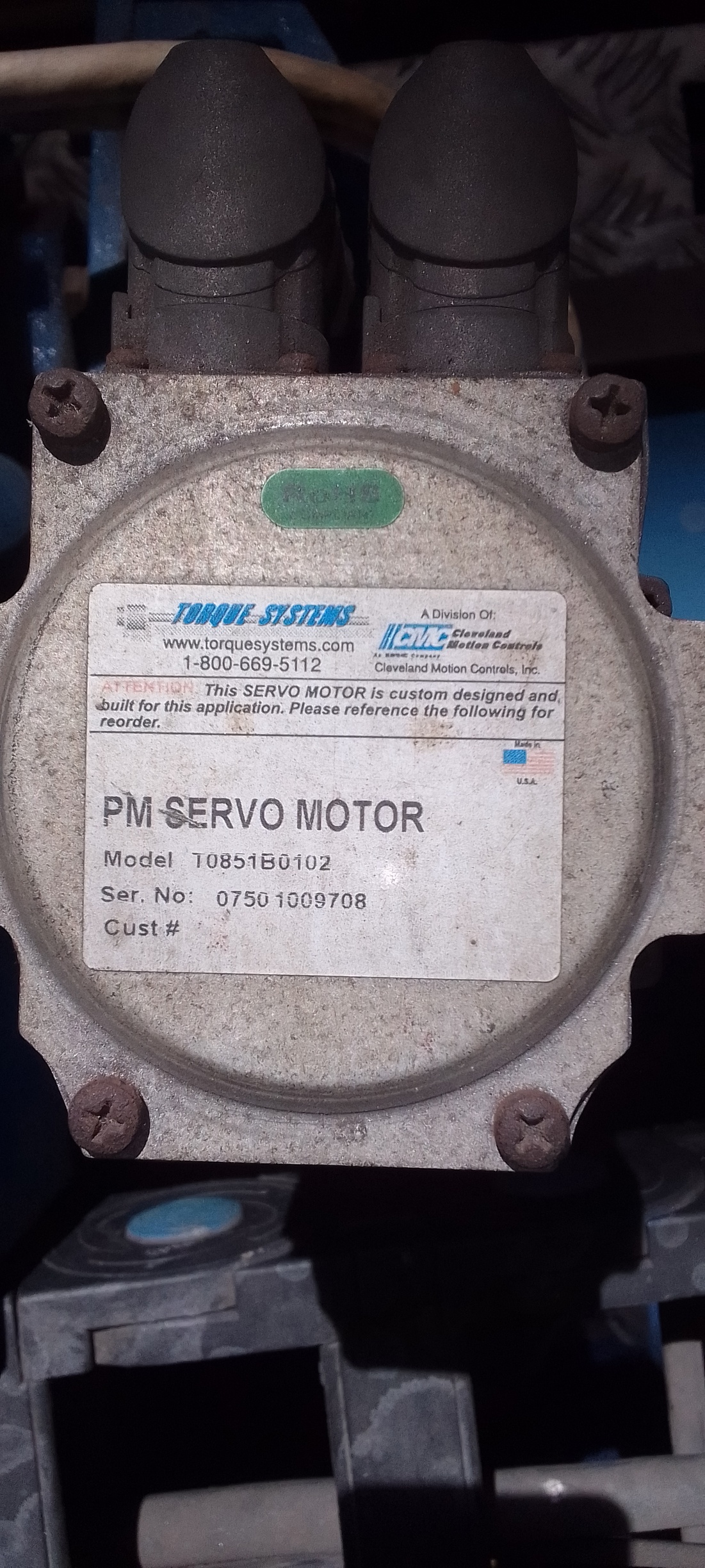

Hello, it will be possible to use the analog output port of the 7i96s card to control a single axis servo motor setup, the driver needs +/- 10volt plus 7i96s encoder.
Another question, could someone give me some information about these CMC drivers model c44-34509?
Thank you.
Thank you.

24 Apr 2024 16:24 #299008
Replied by PCW on topic Use the 7i96s card to control a single axis +/- 10volt servo motor.
Those really look like analog +-10V drives
24 Apr 2024 16:35 #299009
by Ronniecnc
Replied by Ronniecnc on topic Use the 7i96s card to control a single axis +/- 10volt servo motor.
Thank you very much, I'm going to try with a potentiometer connected to a 1.5volt battery for safety.
