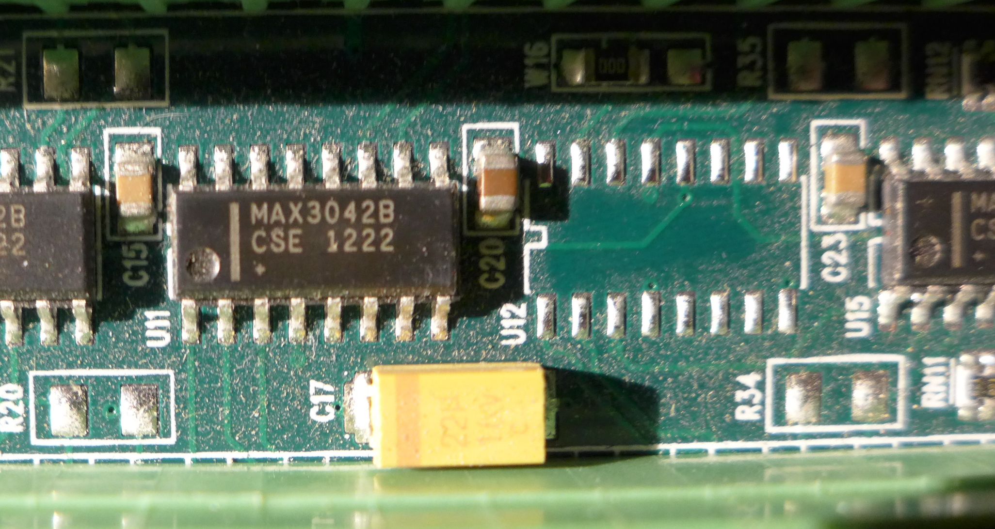

Yeah, they are the same cards, just different parts soldered,
I can dig up the schematics tomorrow and post them here
Pretty sure you can make one that's part 7I52 and part 7I52S (sserial and step/dir)

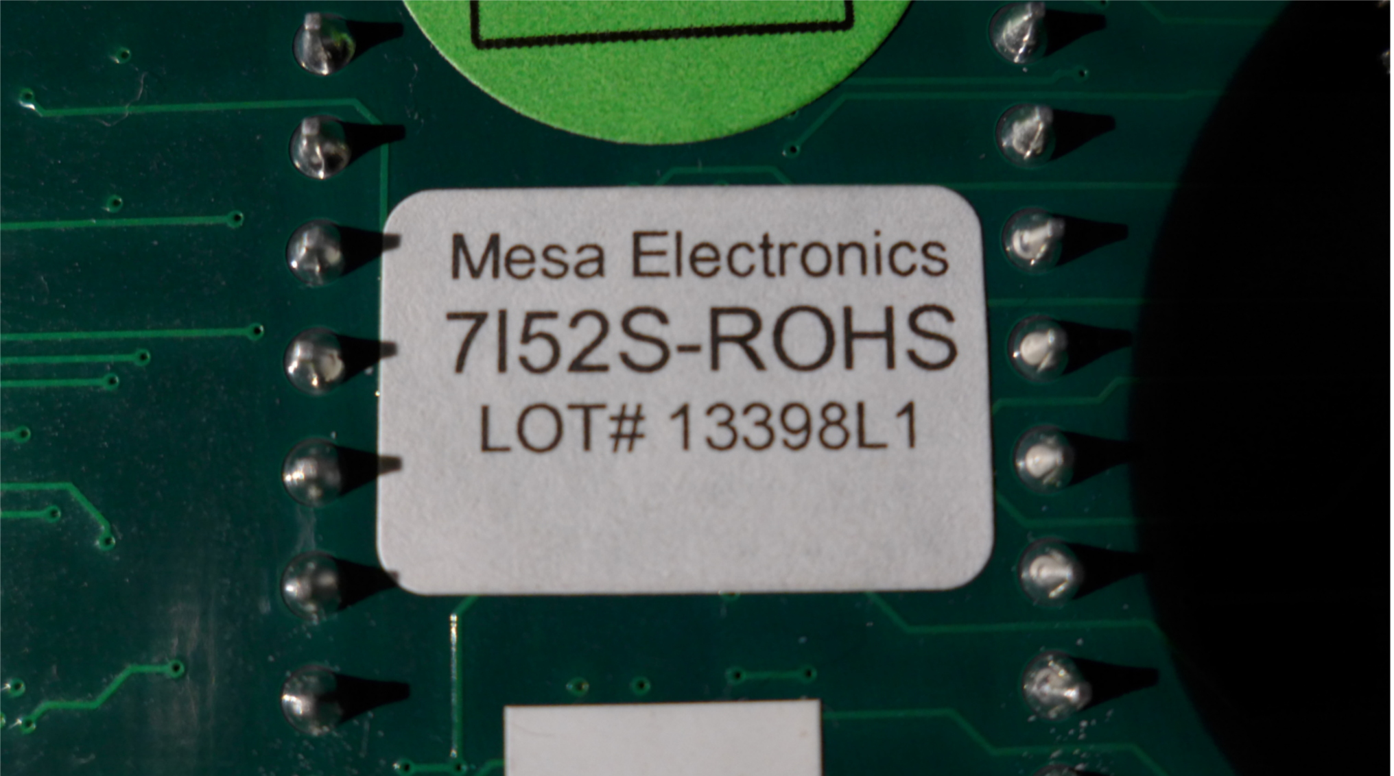

Thanks for the files. They helped me a lot. When looking at the board I noticed that no RX-IC are equipped. This I found strange, as they would have to be equipped according to the circuit diagram. By chance I noticed a sticker on the back of the board with the inscription (7i52S-ROHS). I was probably confused by the inscription on the front.
I would now have to fill a missing RX-IC (U12= MAX3094) and exchange the corresponding TX-IC (U11= ISL32174s).
Is it correct that way? Probably I need for it still a adapted firmware?
