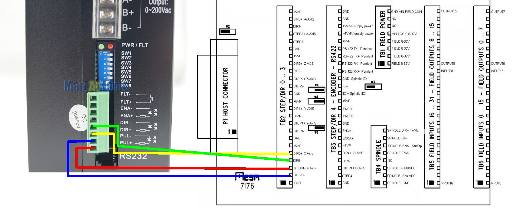

Replied by PCW on topic Mesa 5i25/7i76 + driver leadshine DM2282 digital
How are the 7I76 outputs connected to the Leadshine driver? (common GND, common 5V or differential)
Can you post your hal and INI files?

Hi, attached there are Ini and hal files and in adition an image that shows how we had conected driver to 7i76. Don't pay attantion to dip switch in the image (it just an image taken from internet)
in addition I can tell you that 7i76 is powered from 5i25 ( 5v ) and we are using a 12v isolated source for vfield.
thanks in advance.
First thing I would is change the P term to 1000 (was 50)
The wiring looks correct but sometimes the differential outputs do not work very well with high input
current drives so it might be worth trying with common ground wiring (connect PUL- AND DIR- to ground instead of 7I76 outputs and leave the 7I76 dir- and step- outputs unconnected)
You might also verify that the 5V at the 7I76 is not less then 4.75V or so
