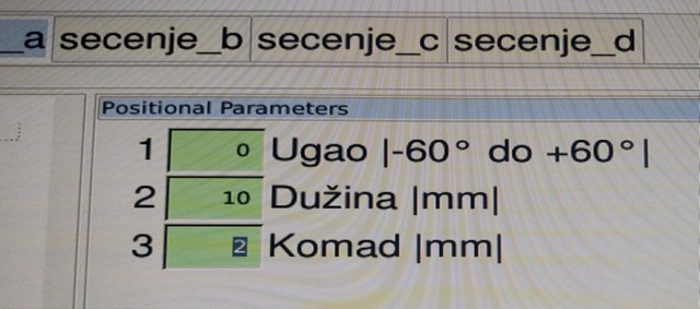

Hello,
i works on retrofit a rotary table bandsaw cnc machine, and the programming is done in NGCGUI.
In the gmoccapy i implement a NGCGUI. Now i want to increase the entry box font size, to the operater better see the parameter values. The ngcgui is now looks like this:
I succeeded to increasethe parameter number, and the parameter comment font size.
But the entrybox value not.
The parameter comment font size i increased in file: pyngcgui.ui, adding Helvetica 18 to selected row on photo:
The parameter number "somehow" I increased in file pyngcgui.py file adding the selected row on photo:
But the most important, the entry box font value, i dont know how to increase.
Can someone help me please?
Best regards,
Attila.
