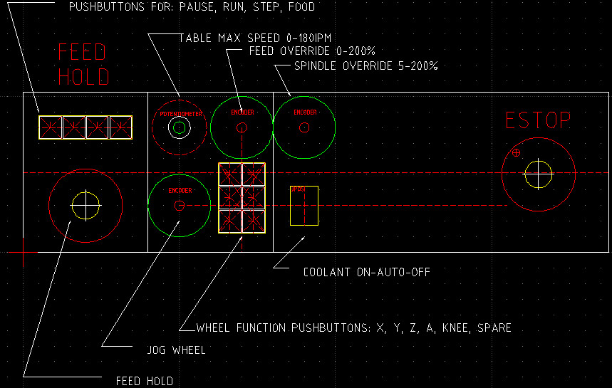

I just had the idea of having the maximum machine velocity setting on a knob would probably be VERY useful, as it limits both the rapids and the programmed feed movements. It also seems to me that feedrate override and spindle override should probably be encoders, too. Otherwise, I fear they may fight some settings from the pendant or the UI and when i power on the machine I will have more things I have to tweak before I can start using it. Thoughts?

11 Feb 2017 22:56 #87843
by yeltrow
Replied by yeltrow on topic Physical Control Panel Feedback Wanted
Up for comment, R3 of the Physical Button/Knob Layout
Revisions and why:
Pots mostly converted to encoders to prevent fights with the Axis UI. Same for going to PB's for the Jogwheel function.
Buttons placed above feed hold for single stepping.
Added TABLE MAX SPEED because that is what I really am trying to limit much of the time I might be reaching for feed override.
Revisions and why:

18 Feb 2017 00:38 #88144
by cncnoob1979
Replied by cncnoob1979 on topic Physical Control Panel Feedback Wanted
I would avoid any pot's. I built my physical panel using pots and have since ordered encoders [with center press button] to replace them. I do not like anything absolute and prefer relative "knobs". Since any small changes will cause changes to the gui, as you mentioned causing a fight between the two. [the intent of push button is to sync to 100%]
I haven't the time to install them as of yet however.
One button I found that i used a lot besides feed/spindle override is a start/stop button. I used one button to do both inputs. I use that one button -almost all the time.

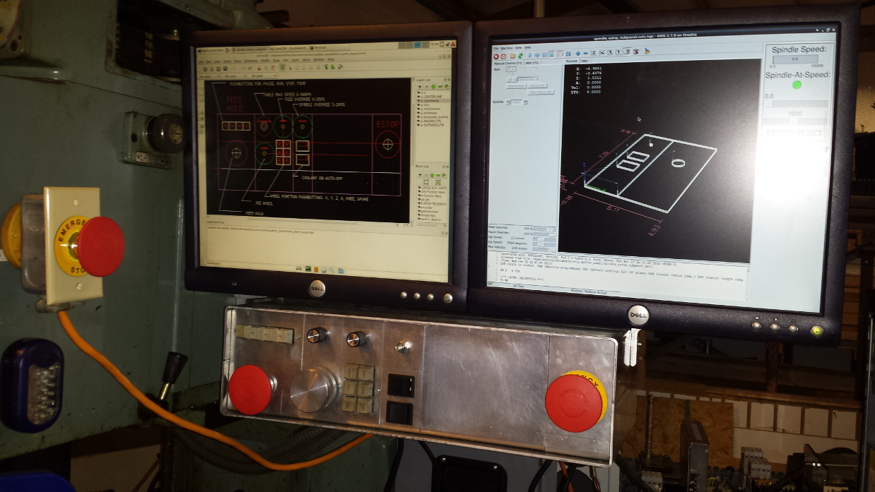

23 Feb 2017 03:55 #88531
by yeltrow
Thank you to everyone for the input. I have built the physical button panel and mounted it on the machine. It is shown in the attached. Labeling, painting, and wiring is yet to be done. More info at sites.google.com/site/yeltrow/shizuoka-a...-linuxcnc-conversion

- yeltrow
- Posts: 65
- Thank you received: 3
04 Mar 2017 20:37 #89005
by yeltrow
Thanks! All the code I used is in my github repository:
HERE
My current setup consist of all the buttons connect to an Arduino Mega 2560. The Mega 2560 is connected currently via USB (as ttyACM0). mb2hal communicates to over the USB connection and makes pins for hal. I pass the packed bytes into a component I wrote called hwpanel.comp. It just remaps the 16 bit groups into 32 bit groups for the encoders and breaks out the individual button lines so hal can get at them easily. The arduino code, theshiz.hal, theshiz.ini, and hwpanel.comp are all in the github repo.
My current issues are:
1) Pause/Step/Run/Stop/Feed Hold work kind of weird right now because of the pins they are mapped to and how I thought they worked. I'm going to get them straightened out, but for the time being, the feed hold does stop the feed, stop stops the machine, and after that things get weird... I working through it.
2) I am attempting to use acceleration on the jog wheel. It can surprise me from time to time and needs work.
3) The momentary buttons for selecting different axes to jog haven't been connected in hal yet. Feed override works fine.
4) Spindle Override is yet to be done.
5) I have no idea how the direct entry input stuff works to connect the potentiometer for max speed into halui....
6) Coolant and spindle control buttons aren't wired into hal yet.
Pictures and details at my website.
