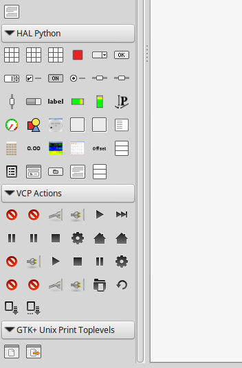

02 Dec 2016 02:35 #83552
by islander261
Replied by islander261 on topic Glade 3.8.5 and LinuxCNC RIP build: how to install the catalog?
Hello
This is along the same lines. I have done the install to get Glade 3.8.5 working with GTK-2 widgets. I have checked all of the previously mentioned directories for the widgets, py and .png files (all present). My problem is I do not get the full set HAL widgets when starting from either the terminal or the GUI. Please see attached screen shot. Is there any special configuration setting I need or is there command line switch I need to force the use of the other widgets? When starting from terminal I also get a long litany of missing widget icons. I really want to use the SpeedControl widget, it is in the directories but not in Glade.
John
John
02 Dec 2016 06:40 #83556
Replied by cmorley on topic Glade 3.8.5 and LinuxCNC RIP build: how to install the catalog?
Missing icons is not important.
Buried in the messages before icon warnings is quite possibly the error codes.
you may have to adjust the amount of scroll back in the terminal (edit/profile preferences in terminl) to be able to see them.
If you can find actual error codes post them.
Chris M

02 Dec 2016 15:31 #83579
by islander261
Chris
Sorry, I don't know what to look for but here is a screen shot of all the messages when starting Glade from the terminal.
John
John
02 Dec 2016 23:15 #83600
on my wheezy distro the command is glade-gtk2...
The erorr messages while odd don't seem to give much clue unfortunately
Chris M
Chris M
