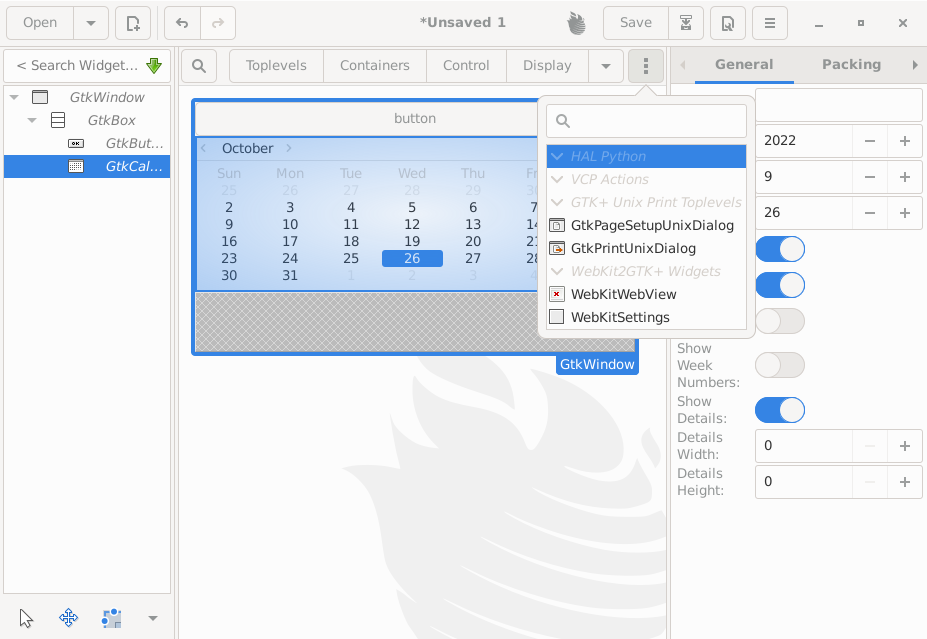

I am having the same problem with Master 2.9 RIP only installation. As instructed I installed Glade 3.38.2, then ran the . ./scripts/rip-environment before opening glade. Glade opens up but no widgets are available. Since this is a RIP installation only at this point the /usr/share/glade3 file does not exist and therefore the contents cannot be copied to /usr/share/glade file to share the widgets.
I am thinking I might need to do something similar to this older thread
forum.linuxcnc.org/48-gladevcp/31767-gla...the-catalog?start=10
but you would use python3 instead of python2.7. However, for some reason I see a python2.7 file in /user/lib that probably shouldn't exist...is this generated by the rip script?
I don't mind if the widgets are installed system wide but if I can get it to run in place that would be ideal.
Dan

Output in the terminal
(glade:32481): GladeUI-WARNING **: 09:36:00.484: Failed to load libgtksourceview-2.0.so: libgtksourceview-2.0.so: cannot open shared object file: No such file or directory
(glade:32481): GladeUI-WARNING **: 09:36:00.484: Failed to load external library 'gtksourceview-2.0' for catalog 'gtksourceview'
GladeUI-Message: 09:36:00.488: No displayable values for property GtkSourceView::draw-spaces
GladeUI-Message: 09:36:00.488: No displayable values for property GtkSourceView::background-pattern
GladeUI-Message: 09:36:00.499: No displayable values for property WebKitWebView::camera-capture-state
GladeUI-Message: 09:36:00.499: No displayable values for property WebKitWebView::microphone-capture-state
GladeUI-Message: 09:36:00.499: No displayable values for property WebKitWebView::display-capture-state
GladeUI-Message: 09:36:00.506: Glade needs artwork; a default icon will be used for the following classes:
JogWheel needs an icon named 'widget-gladevcp-jogwheel'
HAL_HBox needs an icon named 'widget-gladevcp-hal_hbox'
HAL_CheckButton needs an icon named 'widget-gladevcp-hal_checkbutton'
HAL_Table needs an icon named 'widget-gladevcp-hal_table'
etc...

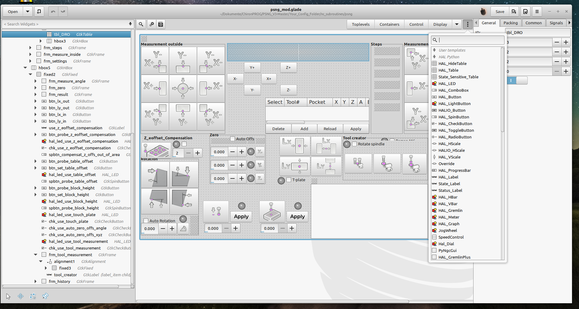

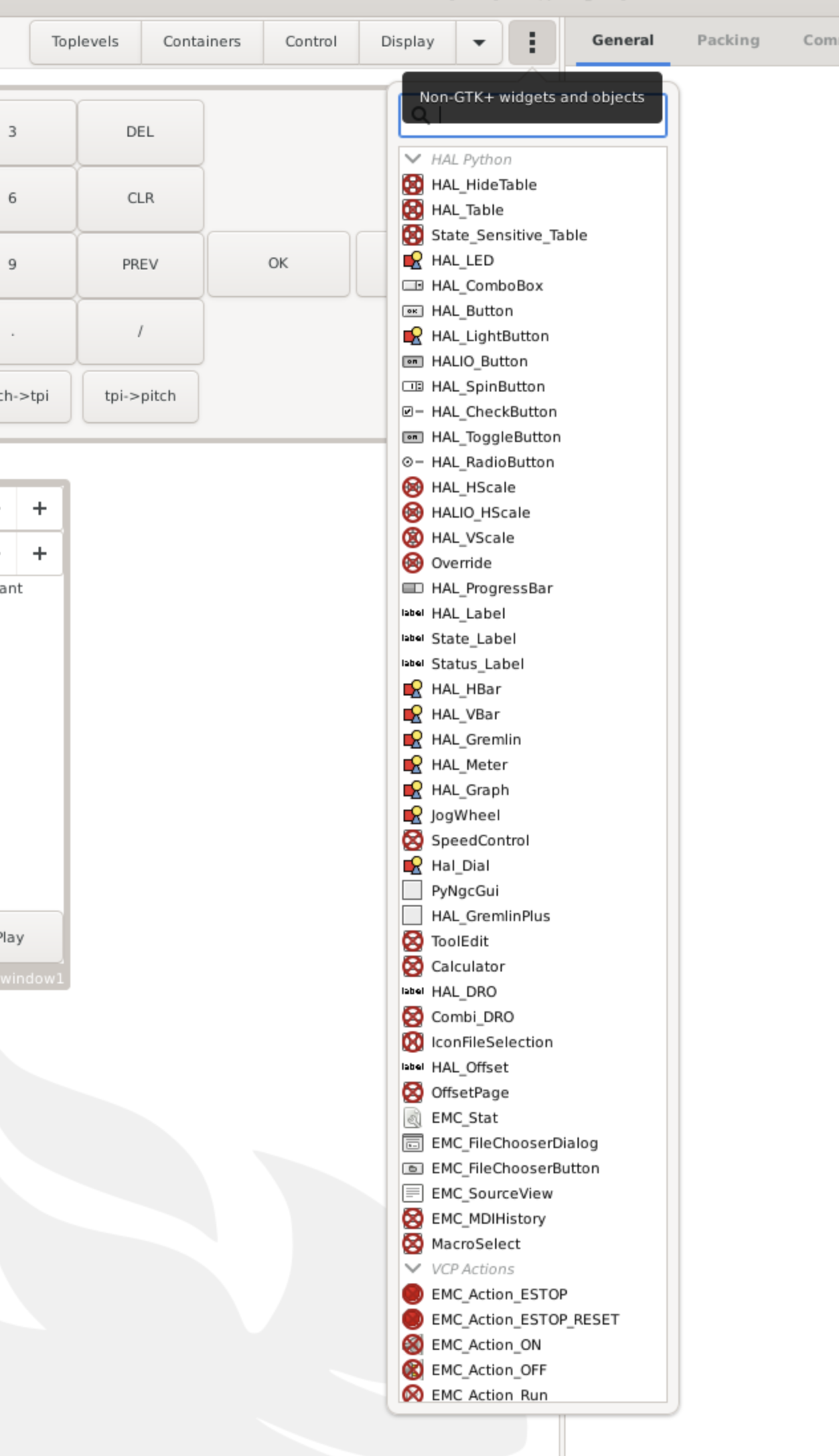

I am having the same issue; none of the Linuxcnc widgets show up under the toolbox.
My setup is running Debian 9 from the 2.8 ISO with Linuxcnc version changed to master by changing the repositories.
I tried copying the contents from /usr/share/glade3 to /usr/share/glade. Now I see the appropriate categories or type placeholders in the toolbox, but no widgets.

running glade from command line shows the following errors:
(glade:13834): GladeUI-WARNING **: 16:27:48.164: We could not find the symbol "h_al__hide_table_get_type"
(glade:13834): GladeUI-WARNING **: 16:27:48.164: Could not get the type from "HAL_HideTable"
(glade:13834): GladeUI-WARNING **: 16:27:48.164: Failed to load the GType for 'HAL_HideTable'
(glade:13834): GladeUI-WARNING **: 16:27:48.164: We could not find the symbol "h_al__hbox_get_type"
(glade:13834): GladeUI-WARNING **: 16:27:48.164: Could not get the type from "HAL_HBox"
(glade:13834): GladeUI-WARNING **: 16:27:48.164: Failed to load the GType for 'HAL_HBox'
(glade:13834): GladeUI-WARNING **: 16:27:48.164: We could not find the symbol "h_al__table_get_type"
(glade:13834): GladeUI-WARNING **: 16:27:48.164: Could not get the type from "HAL_Table"
(glade:13834): GladeUI-WARNING **: 16:27:48.164: Failed to load the GType for 'HAL_Table'
