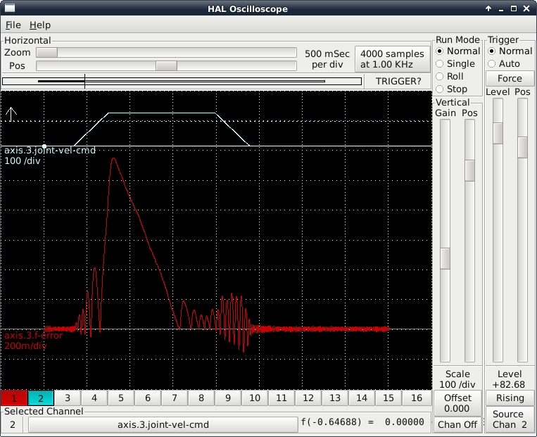

MDI:
Using the LinuxCNC Servo Axis Calibration window, I successively tried increasing by factors of 10 for P until the table moved. I was also watching a-output so I may have cheated and skipped a step or two initially. When I got to 1000 there was still no motion but the output was sitting at 0.5 so I expected the next increment to cause motion. At P=10000, the table moved to the commanded position. Or at least it looks close enough to have done so. I'm not splitting hairs at the moment.
Ok, a second time - watching a bit closer now - and it does seem to correctly rotate the table one full rotation. After rotating, I'm getting what seems like oscillation. Though perhaps just hunting. It's hard to tell because the motor shaft is enclosed in a housing on the table now. I can stop the oscillations by giving the table a small "tweak" with my hand. Actually, I can restart them that way too.... probably getting ahead of myself though.
G91 G0 A360Using the LinuxCNC Servo Axis Calibration window, I successively tried increasing by factors of 10 for P until the table moved. I was also watching a-output so I may have cheated and skipped a step or two initially. When I got to 1000 there was still no motion but the output was sitting at 0.5 so I expected the next increment to cause motion. At P=10000, the table moved to the commanded position. Or at least it looks close enough to have done so. I'm not splitting hairs at the moment.
- Sparky961
- Posts: 210
- Thank you received: 15
10 Mar 2016 03:49 #71308
by Sparky961
Replied by Sparky961 on topic Rotary table configuration
So do I continue to push the P value higher now? The maximum output I'm seeing is 5/-5 so it isn't full scale output yet. When it moves it does seem rather weak compared to what I know it can do.
Many of the PID tuning tutorials I've been looking at talk about adjusting for maximum "stiffness" at this point but with a worm drive and motor shaft/coupling enclosed it's difficult to have any feel for what's going on in there.

10 Mar 2016 04:46 - 13 Mar 2016 23:50 #71312
by Sparky961
Last edit: 13 Mar 2016 23:50 by Sparky961. Reason: Figured out how to put attached images inline
