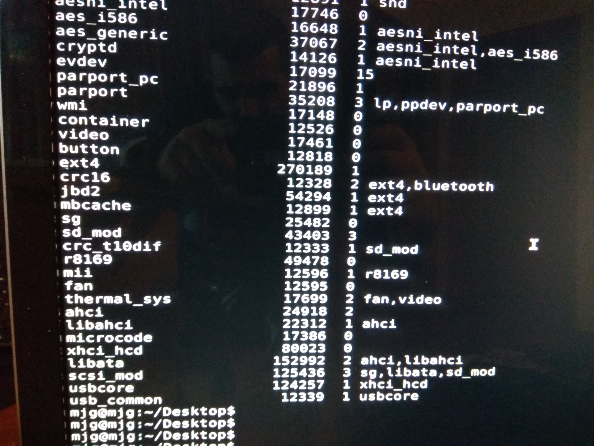

Hello,
My old pc stops working so i buy a new one and when installing linuxcnc 2.7.13 my usb ports don't work.
Motherboard: gigabyte h310m ds2
What can i do?
Best Regards,
Marco Gaspar
What can i do?
Best Regards,
Marco Gaspar

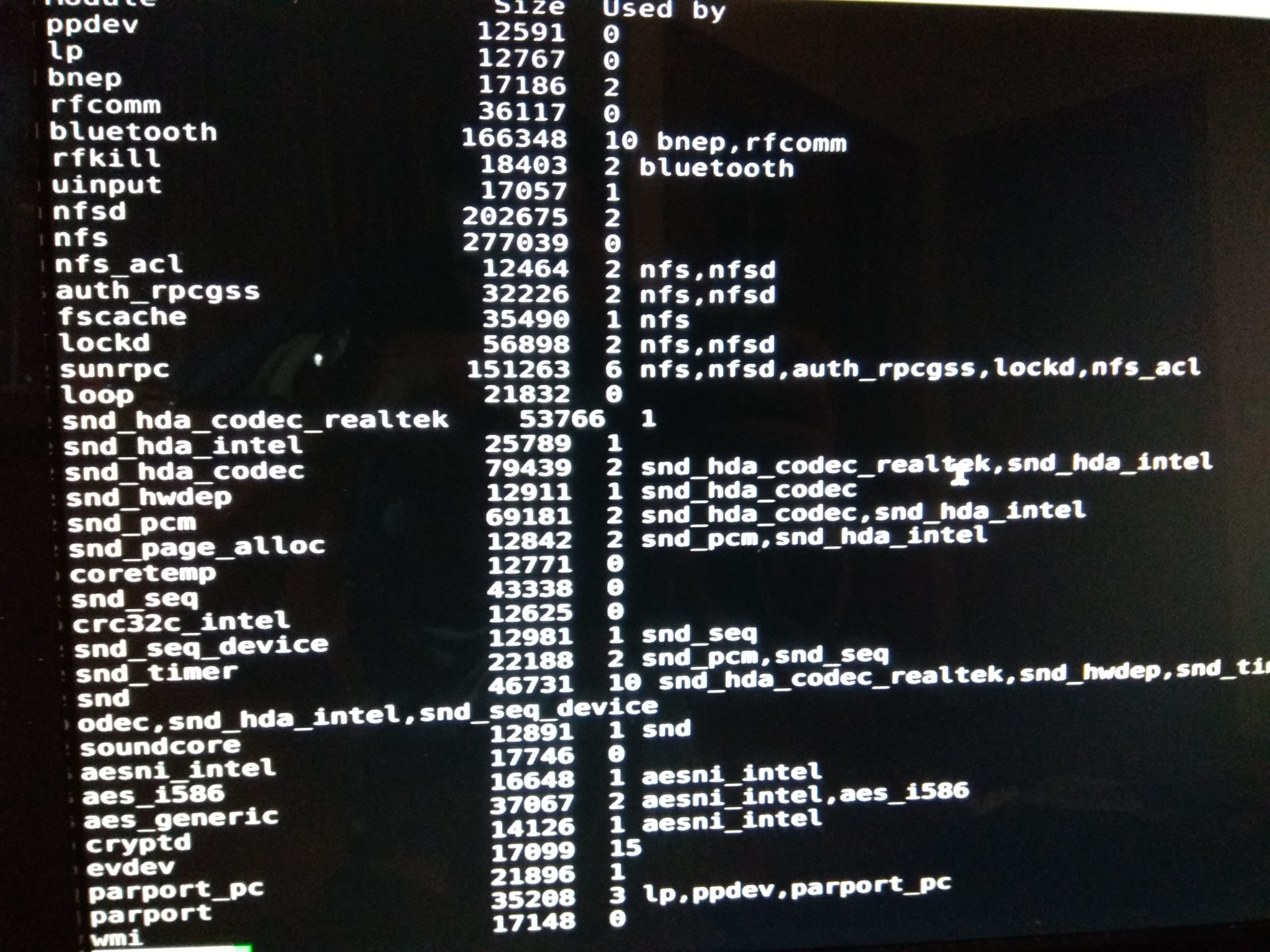

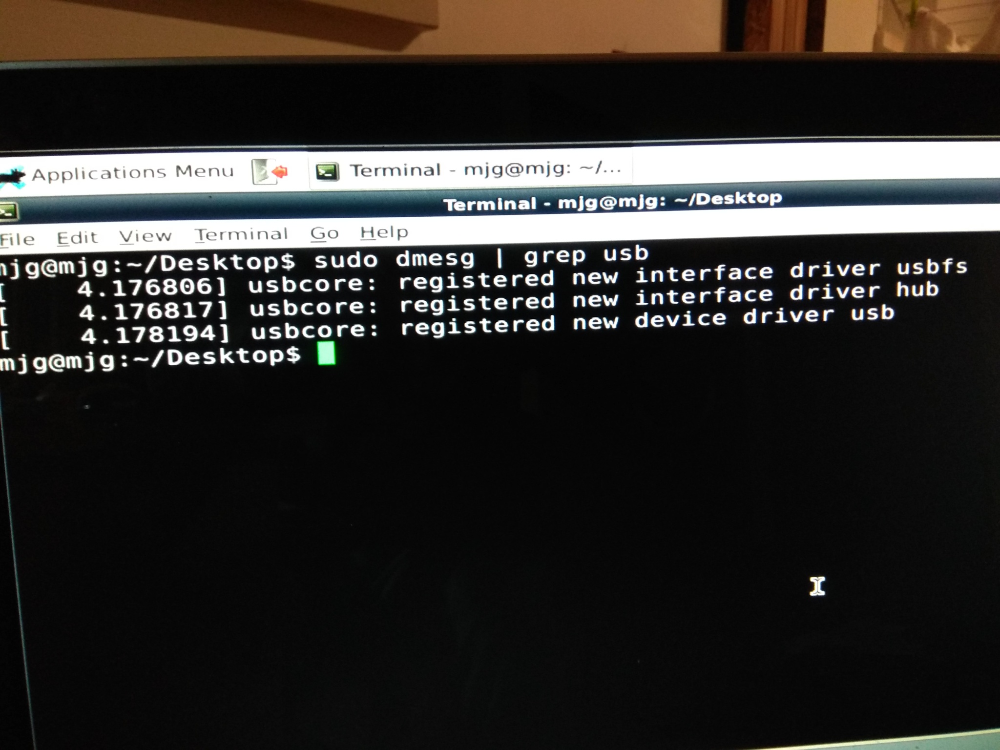

Can you run:
sudo dmesg | grep usb
and show the output
also try
lsmod
and show the output
and show the output
also try
lsmod
and show the output

hmmmm USB on the H310 chipset may not have support in the kernel supplied with the 2.7.x release of linuxcnc.
According to Intel kernel support starts with 4.14
www.intel.com/content/www/us/en/design/p...lake-s/overview.html
Maybe others can chime in if they have a solution.

I try Linux Mint 18.3 and linuxcnc-stretch-uspace-amd64-r10.iso and they work fine.
