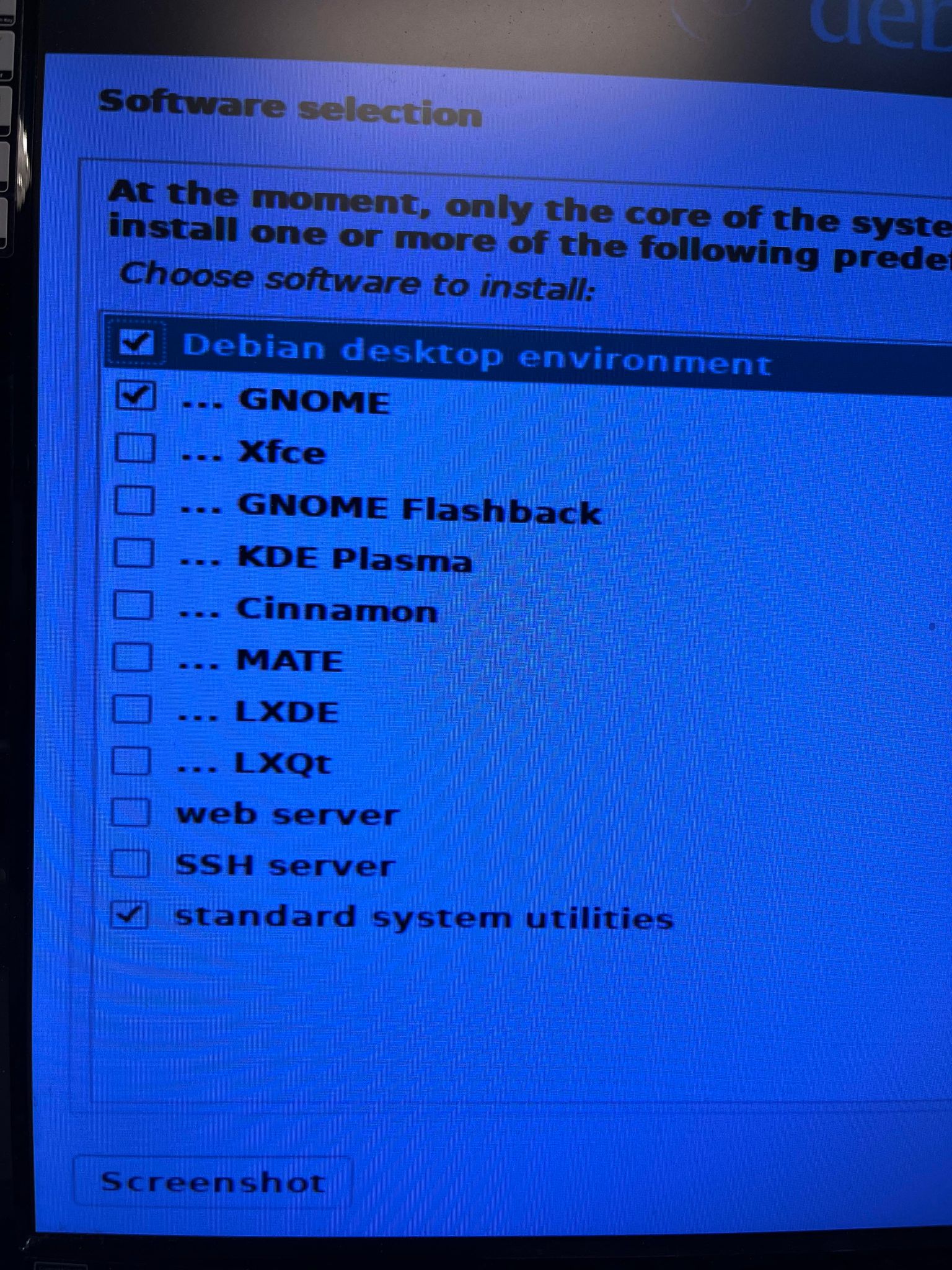

15 May 2023 12:46 #271396
by randypetersen
Replied by randypetersen on topic Clean Install of LinuxCNC
15 May 2023 13:30 #271397
by panming
Replied by panming on topic Clean Install of LinuxCNC
anyone is ok
15 May 2023 21:15 #271425
Linuxcnc is such an old project with a lot of history has been built on Xorg. There are some recent changes that allow it to work with Wayland but Xorg/Wayland support has been broken by upstream changes (eg in the dependencies).
Not all GUIs support Wayland.
You can run tasksel to add/remove environments at any time and you can select them on thee logon screen.
Replied by rodw on topic Clean Install of LinuxCNC
I recommend XFCE becasue it is an Xorg environment. The defaults shown uses Wayland.anyone is ok
