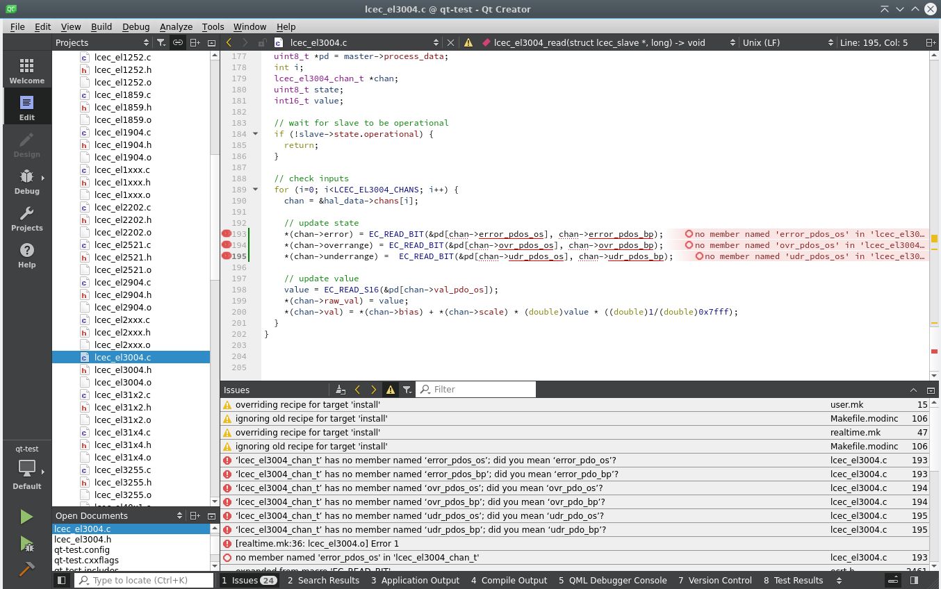

I am not sure where to share stuff like this, but i tried my hand at writing a driver for EL3004 analog input 4 channels, 12 bits, single ended, +/-10V
This my first encounter with writing a driver, so let me know how it might be improved.

Hi Stormhold,
I checked your code..
There is something i noticed at compile time. If the project is loaded in Qt, you can see if everything is ok.
In this case something was not found.
Solved with :
Did you mention this before during halcompile?
Ok qt halcompile project attached, your driver is attached, it works without update status i suggest..
github.com/grotius-cnc/Linux-Embedded/re...ile-qt-el3004.tar.gz
To open the project, in qt load the file : qt-test.creator , then check the howto-pictures in the archive.

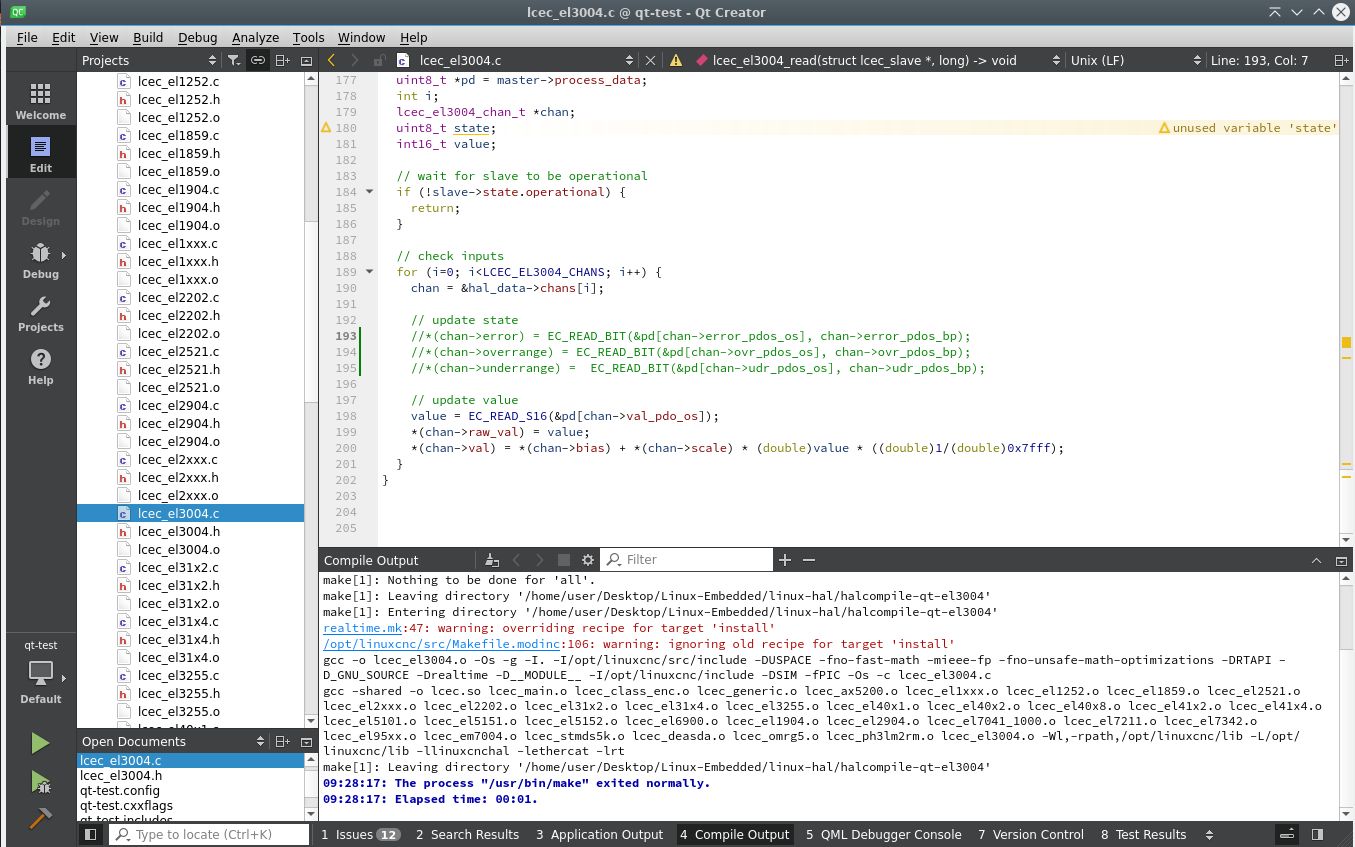

How very embarrassing... a misspelling a new file is attached

Hi Stormhold,
The howto pictures are a example how to set some things in qt. They belong to a previous example wich contains a test.c file :
github.com/grotius-cnc/Linux-Embedded/re...halcompile-qt.tar.gz
If you can load above example in qt, you know how to load your archive in qt.
Above example show's how to compile a single component with halcompiler in a .so file.
Your driver now compiles okey. Updated archive :
For the lcec driver, qt uses a linuxcnc-ethercat makefile. This seemed to be the quickest option.
But you have to take a look in
config.mk and configure.mk, set the correct path's over there.
If you have a skynet install with linuxcnc in the /opt/linuxcnc/ folder, you are already configured.
If you have some question's, no problem.
