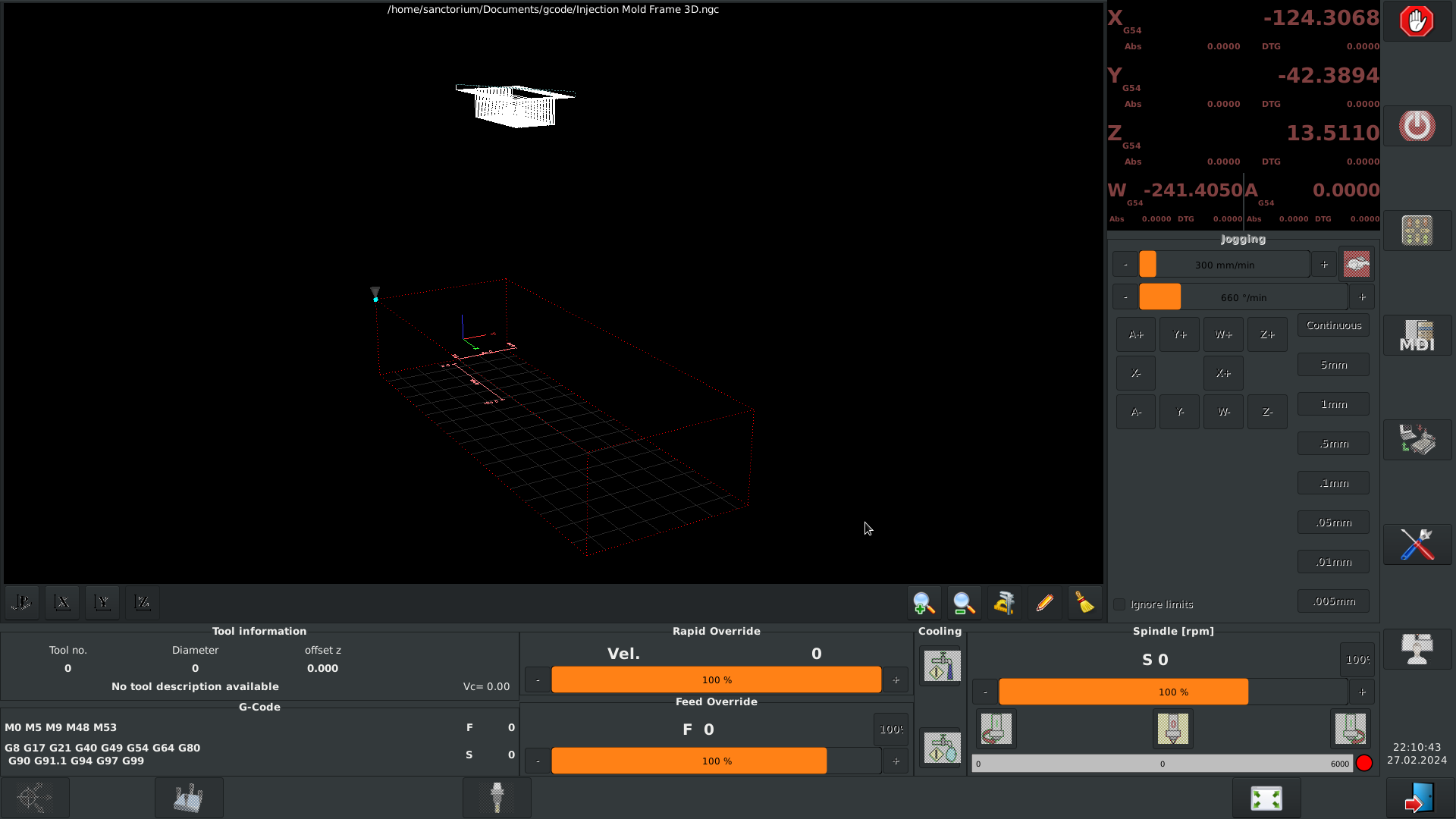

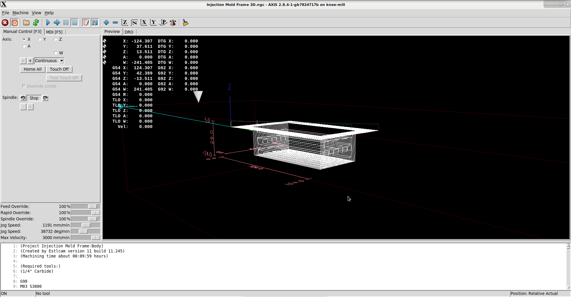

28 Feb 2024 04:25 #294658
by reBrick
Replied by reBrick on topic A and B axis jog very slow when angular velocity is specified in display section
It was pointed out to me by Andy Pugh that convention is to use W for a second Z axis (I didn't realize the association with existing axes) and if I change the 4th linear axis from A to W this is no longer a problem. The problem I have now is that gmoccapy doesn't seem to render the build volume correctly with W axis, so the model is displayed far outside the build volume. Simply going back to axis seems to work fine.
