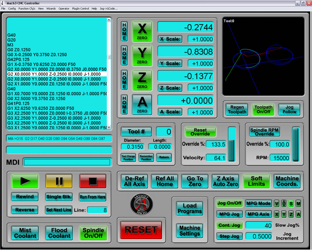

I quite like this screen set used by Dr Flo
www.drdflo.com/pages/Projects/CNC-Mill.html#linuxcnc
It uses the Simple Probe screenset here;
kcjengr.github.io/probe_basic/index.html
That said I just like the PathPilot interface and I want to use the probing routines and the rigid tapping.
Currently, I'm using Mach3 and the Aqua screenset. It's similar to PathPilot and suits my workflow.
www.machsupport.com/forum/index.php?topic=11115.0
