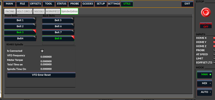

Seeing PathPilot is LinuxCNC are there any rules from a legal standpoint regarding using it to support conversions for customers that don't own a Tormach? Seeing the interface at this point is well supported in the CNC community I think this might be a solution to the more basic interfaces currently available in LinuxCNC.
What is stopping the LinuxCNC dev community from just offering the PathPilot skin as a default option in LinuxCNC?

Pretty sure the interface is what is not open source and what will get you in trouble.
Better way of going about it is to buy their USB drives with everything included, and modify that.
Probably will have to buy one for each machine you do, last time i checked the price was 35$, so very reasonable.

Tormach have an obligation to offer their source but that does not mean they have to make it easy to use on different hardware.
I've never understood why people want to use it on non-Tormach hardware. It might make sense if you do own a Tormach machine already. LIfe is much easier if you use one of the standard GUI's
Surely some of the newer GUI's are equally as capable? Have a look at QTdragon as an example. It has everything you could conceivbly want. Choice of probing optoins, conversational machining, Great documentation, no restrictions.

Yes the screenset is editable using qtdesigner. cmorley, one of the developers has spent all day for me fixing some bugs in the embeddable panel handling I found.. After that, I managed to get a panel built. Still got a lot to do about formatting. Working with panels seperates your customisation from the core code so its maintained for you. But I thought this is not a bad start in one day.
It does have a few hotkeys but remember its designed for touch screens so they are not needed. I think context sensitive pop up keyboards can also be enabled.
Hopefully I'll get this connected up tomorrow and one last issue with the spindle fixed. My probe should arrive later in the week.
