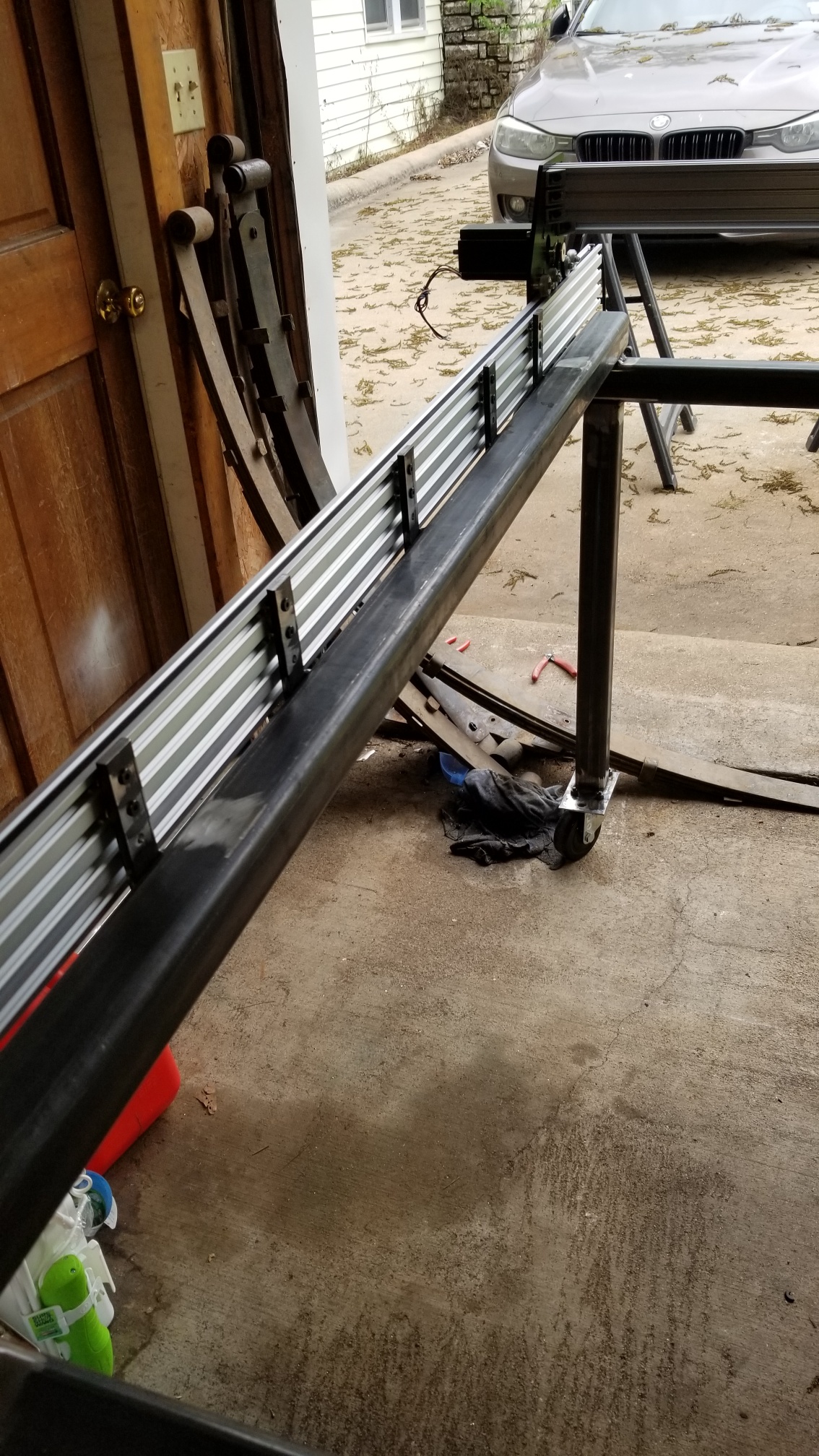

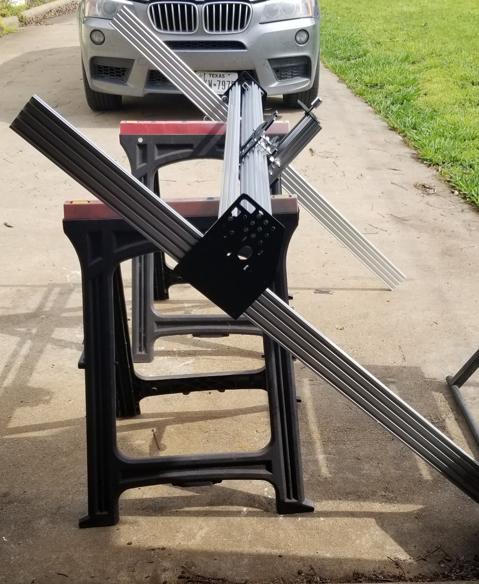

I purchased some 20x80 1500mm v-slot for the Y axis rails, and the appropriate 20x30 1500mm material for the gantry. I like the idea of a lightweight gantey (read aluminum). Makes sense that it would be light weight and therefore less wear and tear on bearings, motors, etc.
One potential issue I saw with the Y axis rails was flexing, after all they are only 20mm wide. Rather than making the frame from more v-slot I elected to use steel square tubing. I had a bunch laying around already, 2" x .25" wall. Plenty beefy and I figured it would keep the gantry well planted with the weight below all of the moving parts. I was able to get the table frame squared pretty well, and the deviation from side to side as well as width variation is +/- 1/32in and +/- .1deg (from a digital angle finder). Best I could do with a not-so-leveled concrete slab to work on. As it turns out, this all was the easiest part! I'm hoping that getting the tolerances in as close as I can will prolong the life of bearings and such. I'm using the extreme wheels from openbuilds, with belt drive (used as rack by glueing a strip with teeth up, and laying the drive portion teeth-down over it).
I know I'm here very late in my build, however I welcome advice/thoughts whether they're good or bad! I'm further along than what's in this post, actually, I'll post more later.

What you have so far should do, but i have my doubts about the rail/bearing setup as IIRC those use plastic on top of bearings so in the long run might fail, but time will tell.
As for levelling the table, if you plan on cutting thin sheets that is no problem at all if you do have a THC, preferably THCAD from Mesanet.com. as it is fully integrated into the Linuxcnc software. Also Proma-elektronika THC150 works properly, but a bit more expensive and you will have to walk to it to adjust the voltage while THCAD has everything on the Linuxcnc GUI.

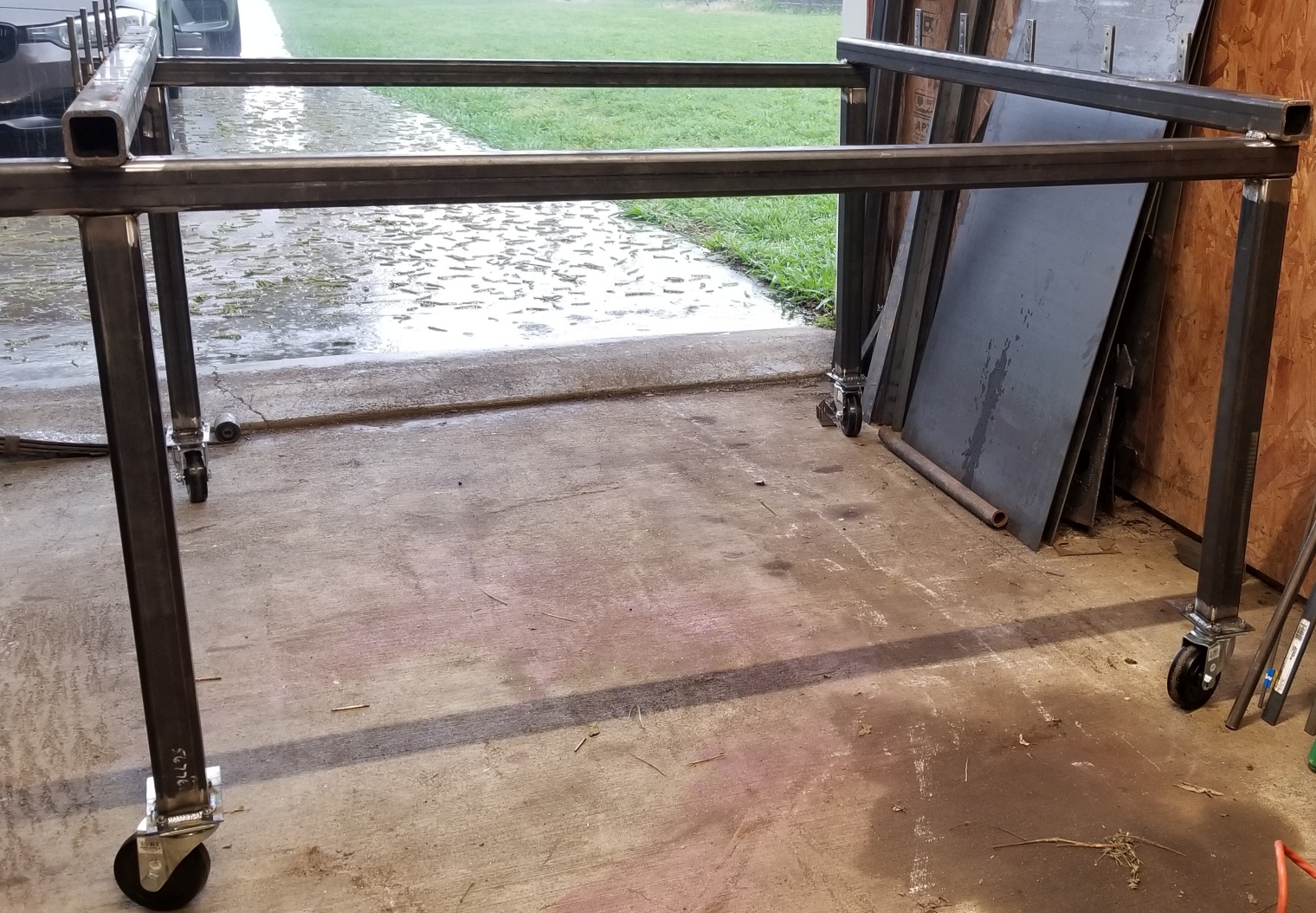

I don't have everything. Going today to pick up the resistors for the voltage divider for the plasma. I have a MeanWell 5v and 48v (12.5A) power supply. I had purchased several NPN type inductive proximity sensors for limits/homing, and didn't take into consideration the need for more than 5v but less than 36v needed for those. Ugh.
At this point my water pan is nearly welded up up, I'm cleaning up the wiring on the table, I just made the brackets and mounted the proximity sensors onto the table (1 on each side of Y axis Y1 and Y2, one on the X carriage, and one on the Z). I have just a little bit of soldering connectors at the wiring on the table and whatnot, and I should be able to test the motion and dial that in over the weekend. That's the tenative plan, anyway.

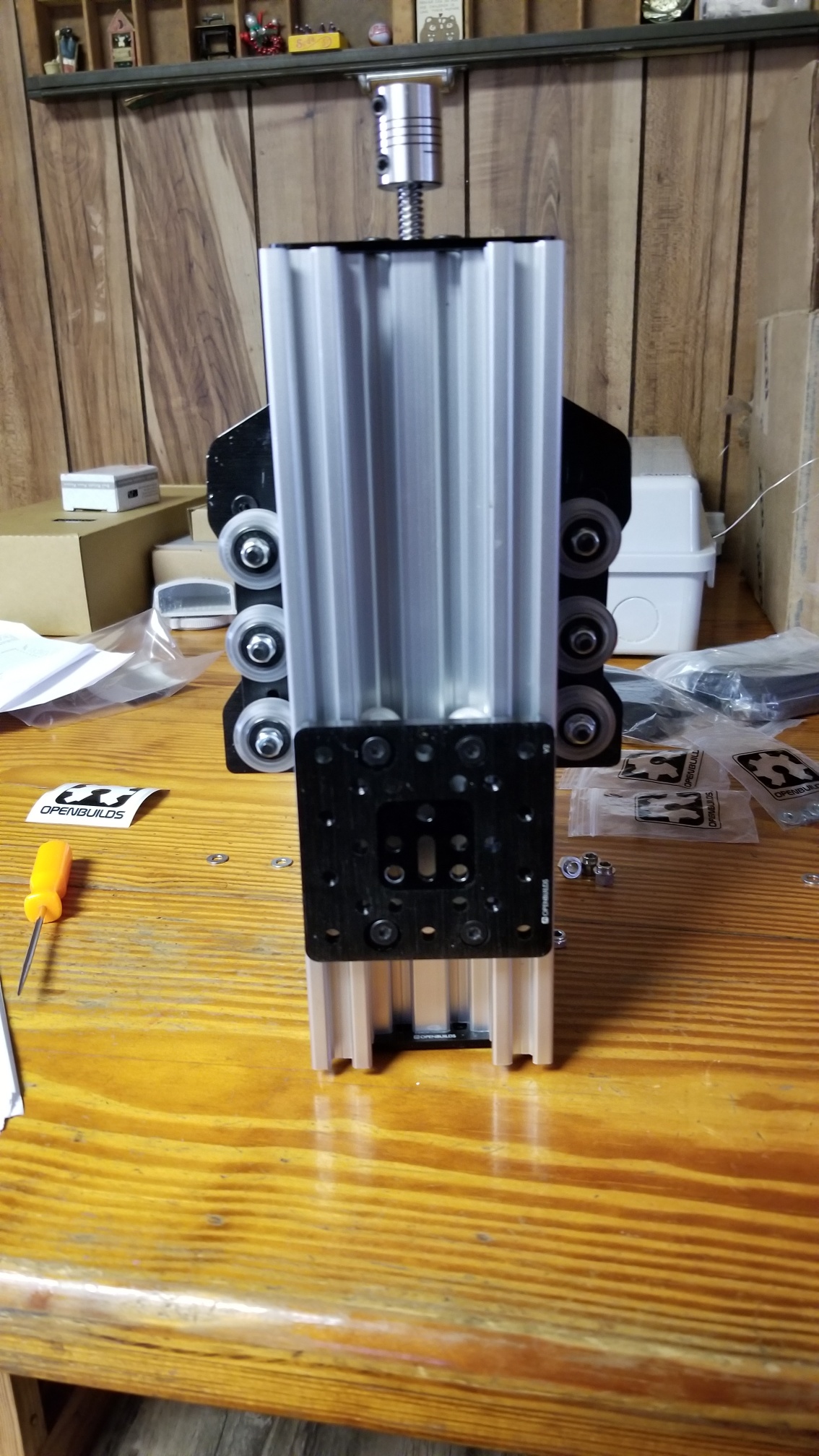

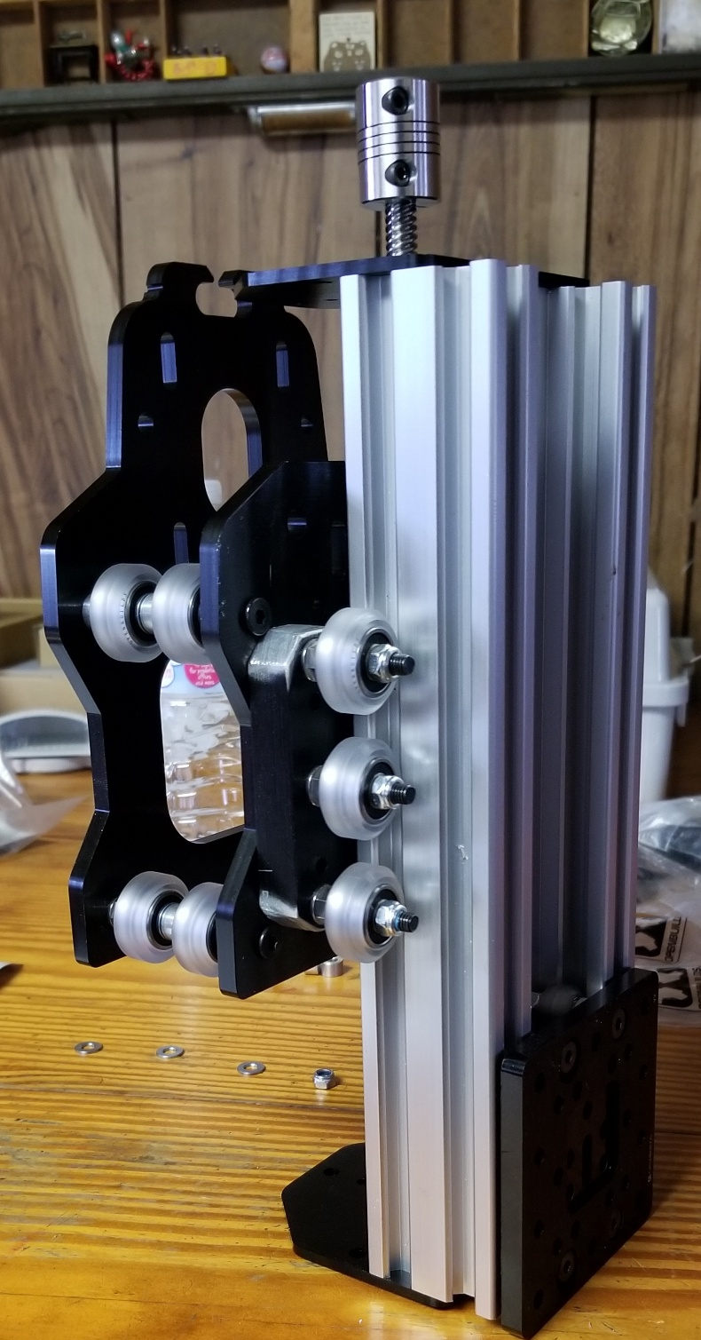

For my Z axis, using the original style OX plates, I wanted to use the newer-than OX plates C-Beam. My reasoning was to have the channel portion of the C-Beam facing out, and using mini wheels inside it and a plate for the floating head portion. I have hopes that having the mini v-wheels inside the channel will protect them, as they will be right by the torch head.
The challenge this posed at the onset was that the OX plates were designed for 20x60mm v-slot. With the C-Beam being 80mm wide, I took some measurements and determined that there was sufficient room on the existing OX plate to precisely redrill the holes for the wheel blocks at the wider required spacing. Worked like a charm, although it isn't as pretty (had to remove length from the blocks for interference issues). Great care has to be taken to ensure the new hole array is squared on the plate. I've heard a lot of folks complain about the mini v-wheels not turning very easily, and I had some issues with this (wanting the floating head to move smoothly). I sanded the precision shim that is located between the 2 bearings inside each wheel, and this took care of it. The plate now will free-fall with nothing attached to it.

Stepper motors - NEMA 23 hybrid 570oz 5A (overkill, but they were on sale same price as smaller ones...)
Stepper drivers - KL 5056 x4
Power Supply - (1) Mean Well SE600-48 and (1) Mean Well RS15-5
Controller - Mesa 7I96
THC - Mesa THCAD-10
Limits - Micro switch for floating Z/NPN inductive prox. sensors for all other limits x4 (needing another power supply for voltage to those)
I also have a generic opto-iso r (4) relay board if needed, although I think the output SSR's on the 7I96 should work for what I need - please chime in anybody if this is not so, so far research indicates it'll work fine for it.
I will mostly be cutting 7ga thru 20ga material with the machine, although the plasma itself will definitely handle much thicker material.

Nice work on the Z axis.
You can use one of those small DC to DC voltage converters, just make sure they can handle at least 60V on the input side, for the proximity switches. Although it is much safer to have a separate 12V or 24V power supply for that.
